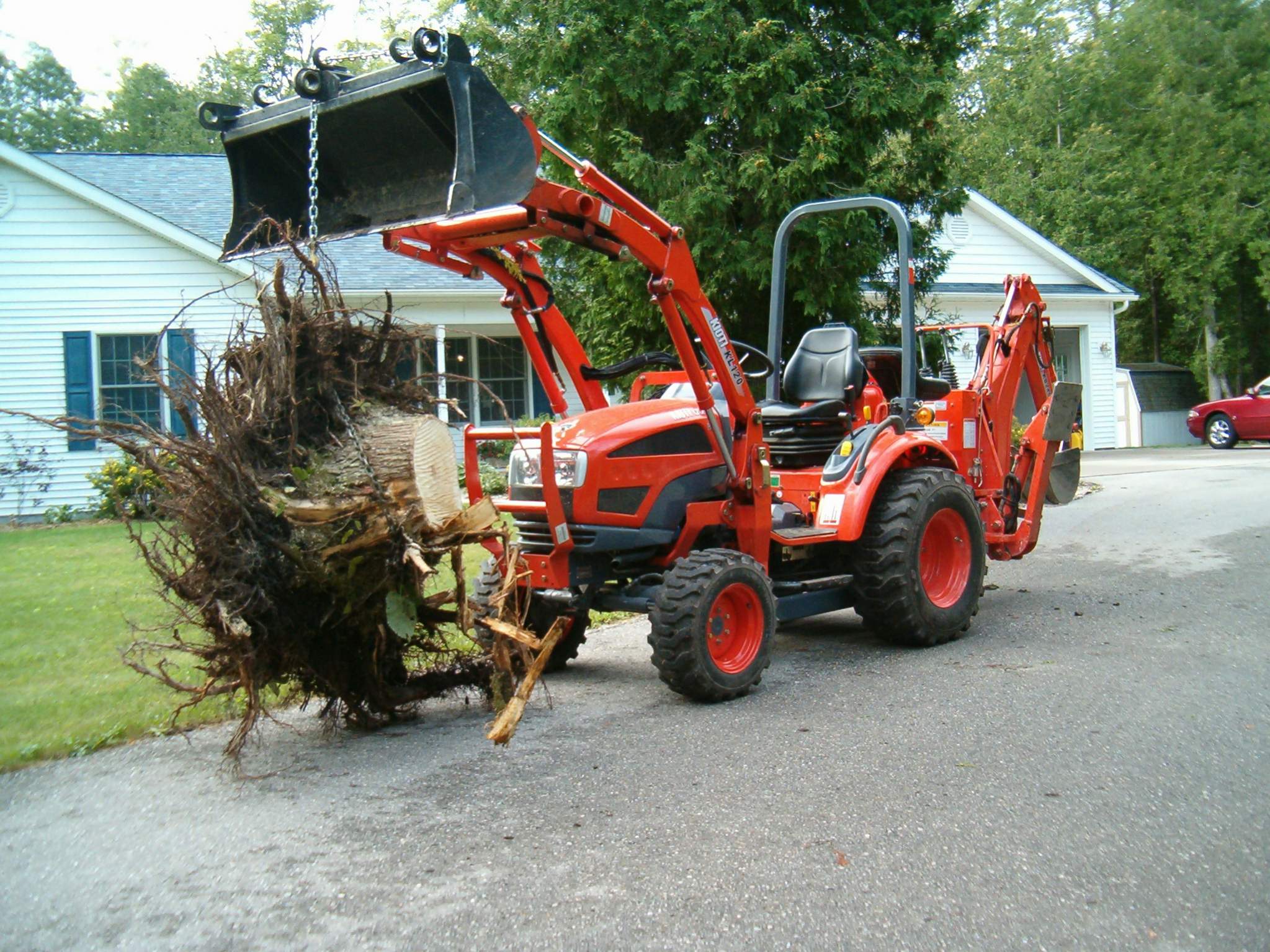

My CK 20 eats big stumps for breakfast.
rimshot (member, ck20 whopper story club)

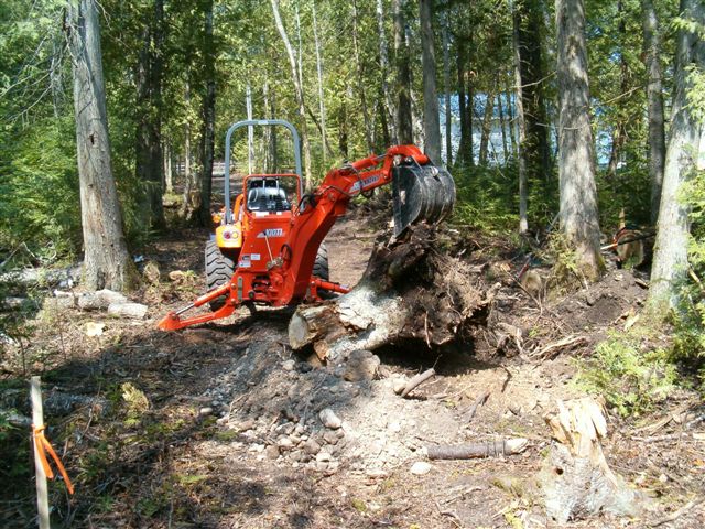

Hi All,
Unlike some of the safety police types postin here, I'd just like to quietly point out the unsafe hook-up in rimshot's first picture, where although the load hangs down from the center of the bucket, the attachment point of the chain is solely on the left hand grapple mount, from whence it crossed over to the center hook. This mounting applies a twisting torque the the left hand bucket mount and is essentially trying to twist the bucket off the mounts.
We should all avoid this kind of one-sided or torquing hook ups, instead either just using the center mounted hook, or better yet, both of the end points. Also, the positioning, while dramatically impressive for a picture, is too loose, making the bucket have to rear up too high, and bringing the COG too high risking lateral instability.
