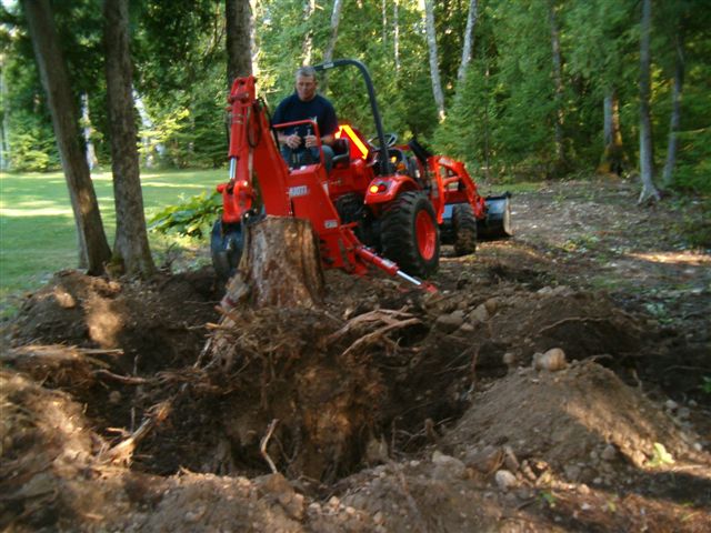

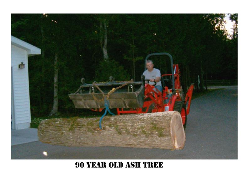

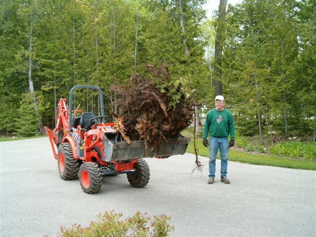

I agree with the OP in that the CK-20 fits the bill as he specified. I have a
CK-20 with a backhoe and FEL and I am closing in on 600 hours. One o my first jobs was to clear stumps for a road through my woods. This meant I had to follow a straight line through a mixture of mature Connifer an mixed hardwoods. Along the way I ran smack into several large stumps. (see pics) This CK-20 never met a stump it could not eject from the ground.
My neighbor has a small Kubota and it has a three point backhoe. His Kubota is a nice little tractor but I'm afraid the extra weight the CK-20 sports is one reason the CK-20 is so much more effective when it comes to removing stumps.
I'm reasonably assured of course the next larger tractor over the CK-20 would be proportionately more effective, of course.
CK-20 offers lots of bang for the buck so far as I can see.
