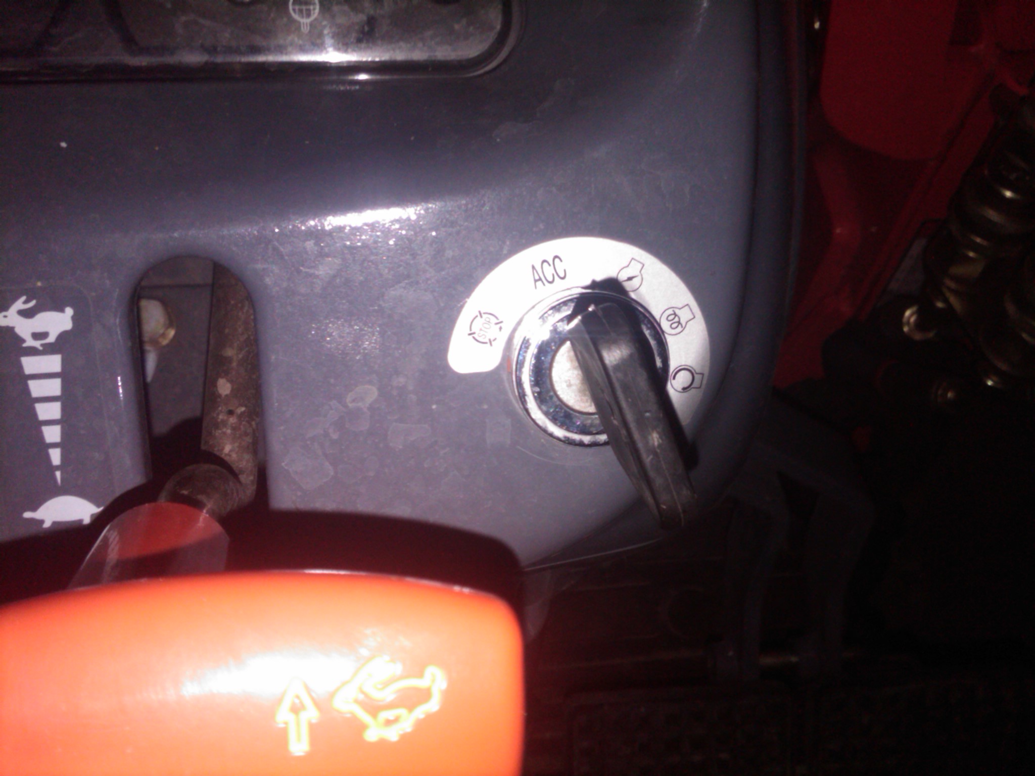

With the CK20S, and the "display unit" timer, the glow plugs will refire after the engine is started.
This would explain things. Once it started getting colder I noticed that the "glow plug" light would come on after start and I thought something was wrong. It also kind of confirms my the start procedure I have been using after some trial and error. Here is what I do.
1. turn key and wait for "glow plug" light to go off.
2. turn key to start and let the engine turn over.
3. if it does not start on second crank or "sounds off" turn key to off.
4. turn key and wait for "glow plug" light to go off.
5. turn key to start and let the engine turn over and just tap the gas.
6. normally the engine will fire and start but run a little rough with dark smoke
7. the "glow plug" light will come on and I tap the gas a little
8. 10 -20 seconds after everything smooths out
9. I let it "fast ideal" for a few minutes to let things come up to temperature.
Thanks to everyone who posted. I am new to diesel tractors and was worried I would hurt something :). My last tractor was an old 1951 gas powered beast. I guess I am a little more nervous around my nice shiny 2010 :).
Sorry for the long post and thanks again.
