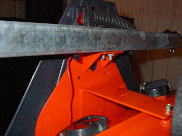

Nice installations. I setup (2) 55w driving lights on my L3410 using some angle brackets that I believe came with SMV emblems or gate hardware. I keep a lot of misc parts around and once in a blue moon I find a use for them!
Anyway, I ran 6 gauge wire from the battery (in front of radiator) to a fuse panel in the rear for all 12v stuff. There is a light circuit, hydraulic filter pump, and 12v rear connector for spraying and running an inverter (lighted hay wagon for Halloween). Check out the pictures...

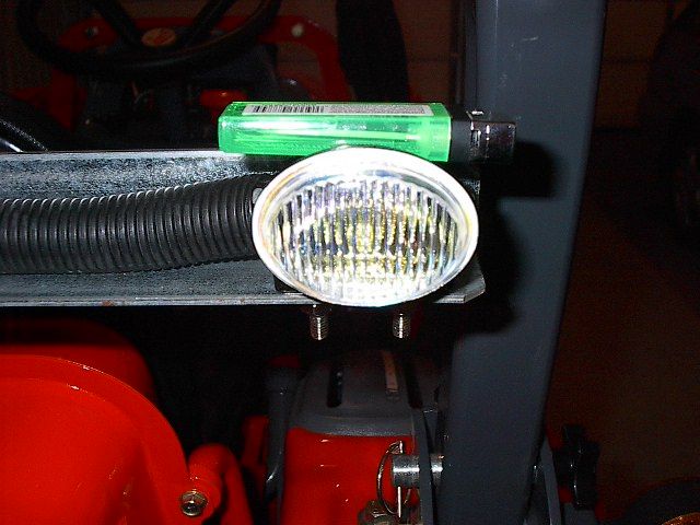

Photo (2), Mounting brackets

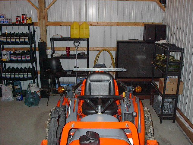

I utilized the stock (+/-) wires behind the SMV/fuel tank for my wiring. The way I installed the work lights and the beakon light, I can within 5 minutes, return the tractor to stock condition. /forums/images/graemlins/cool.gif

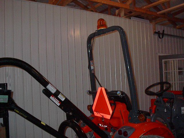

Here is the lighter plug location for the beacon light. Notice the <font color="red"> </font> color of the work light bar now.

And finally, here is the loose (quick detach) restraint for the coil cord. /forums/images/graemlins/cool.gif

Actually that is reflective tape. Quick and easy and it looks great! /forums/images/graemlins/smile.gif
Plus it gives added safety.
