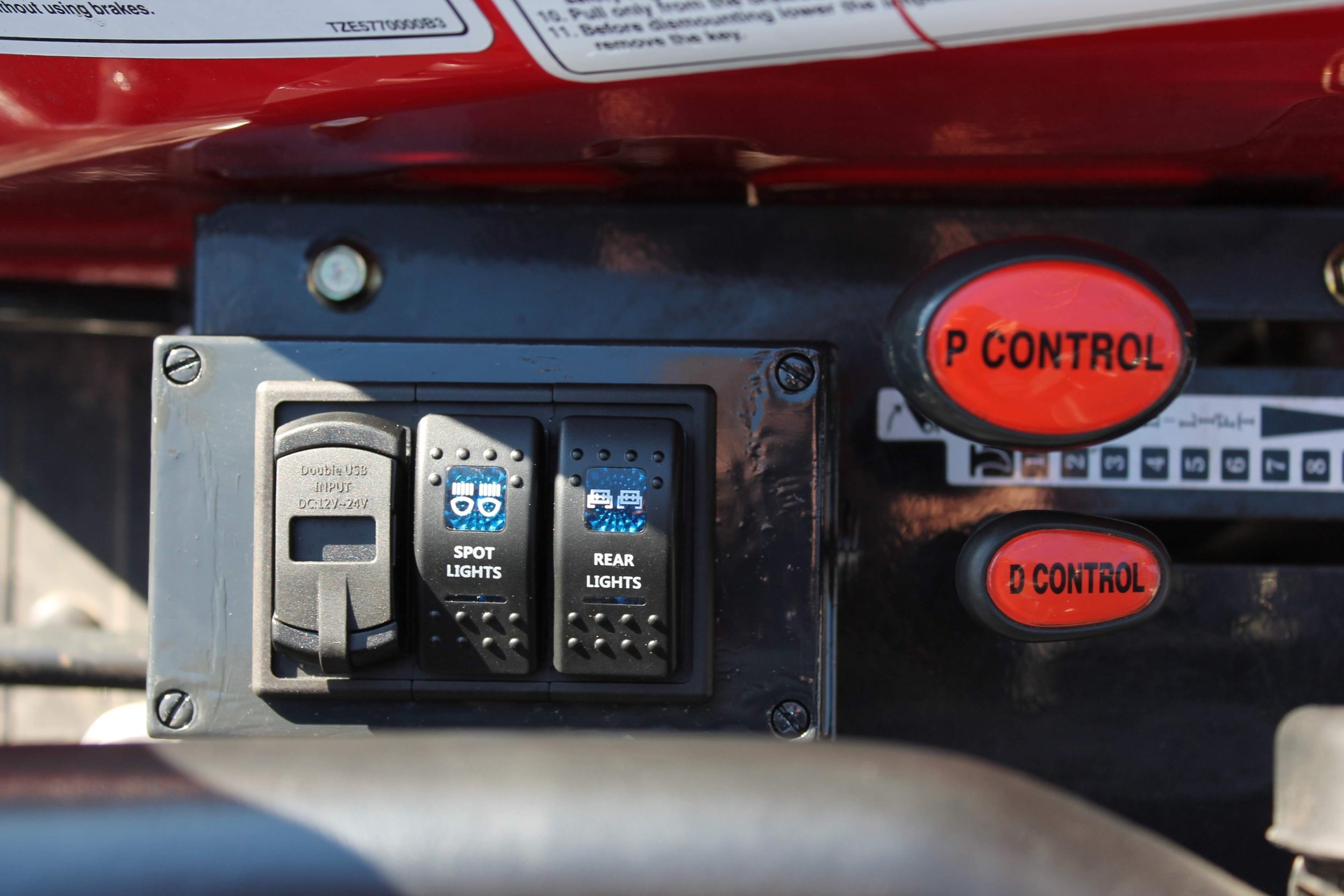

Did it a few years ago on our TC40D... Wife uses it for that exact purpose... charging her phone. Used a marine grade outlet, figured if it could withstand a marine environment it would be fine on the tractor. It has held up very well... I do have it setup so it is powered anytime the tractor is running & is on a delay timer so it will disconnect from power after 20mins when the ignition is turn off.

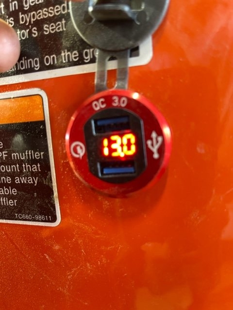

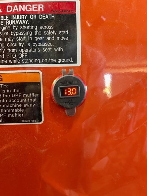

I installed one of those Voltmeter/USB chargers just like dj1701 linked. Later one I ended up installing a 12v socket for the beacon.
/ Cigarette Lighter #8

I installed a USB hub charger on my tractor to charge my phone so I could stream music to my headphones when mowing.
