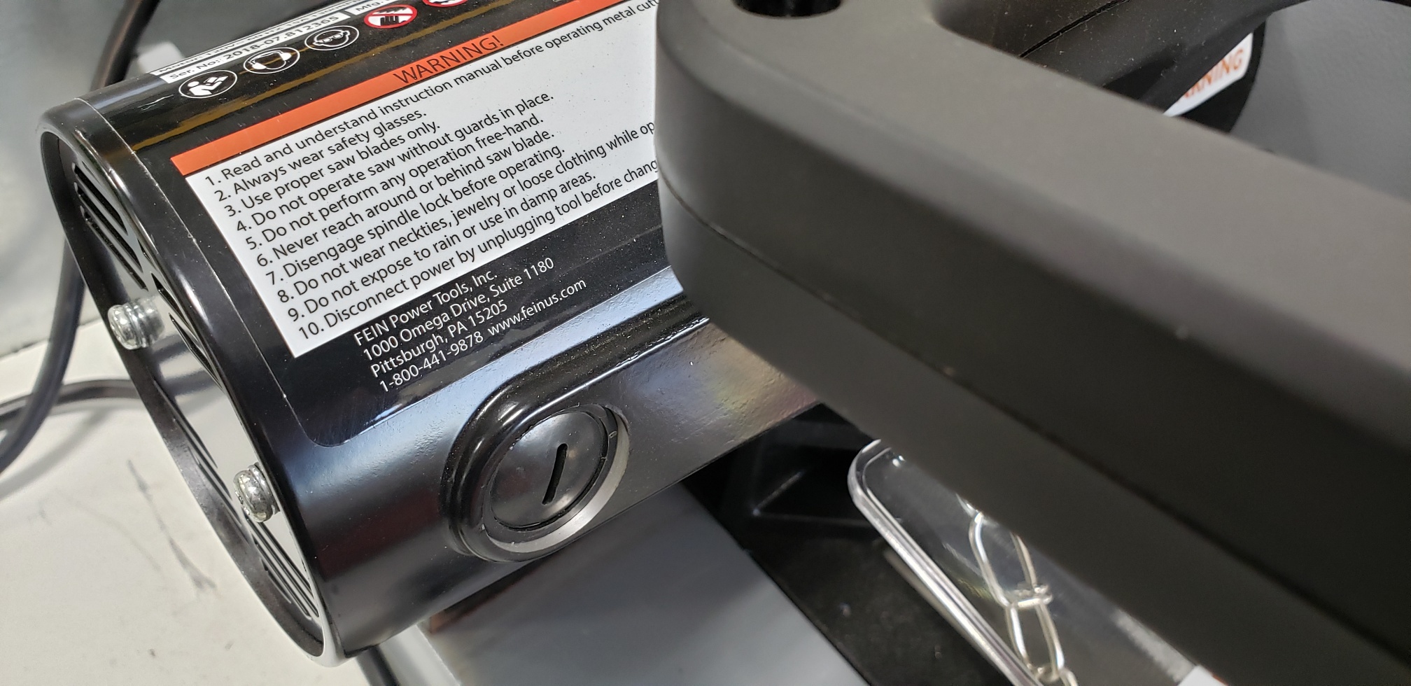

/ Chop Saw Reccomendations #44
Just to debunk this gentleman's opinion, the name Fein is on the saw, about 3 inches away from the hand that turns the blade on.
The name Jancy is not on the saw but that company does make the blade.
And as I said earlier, it was square out of the box, hard to improve on that.
This all make me wonder how much of it is embellished, maybe from a Dewalt employee?
