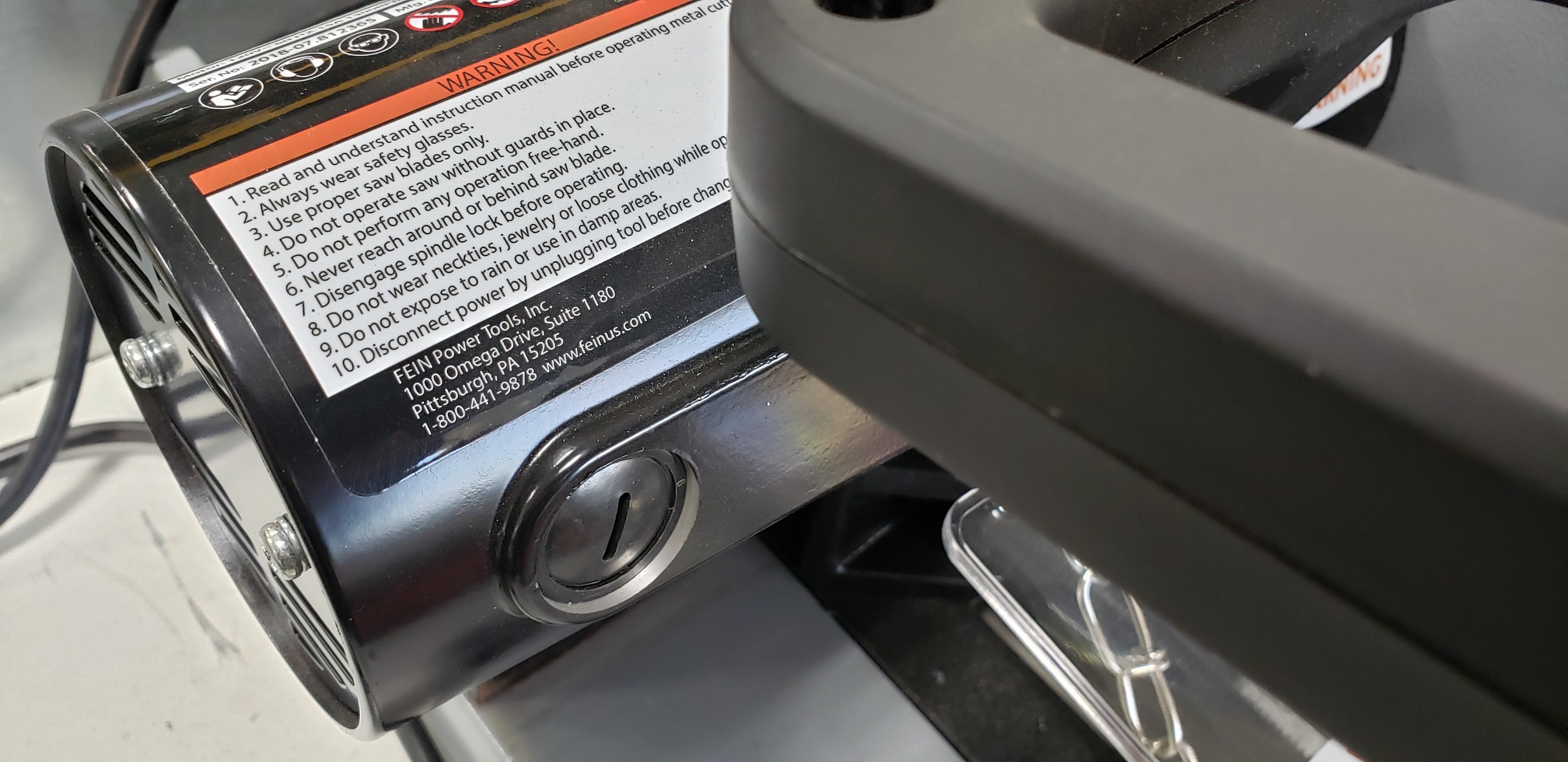

/ Chop Saw Reccomendations #35
Seem to be a bit of ??? bout de saw in de link.
Scrolled down lookin for more nfo and found dis.
☆☆☆☆☆3 out of 5 stars. MRagonese キ 4 months ago
Not "fine"
Putting the Fein name on this certainly baited me into buying this saw because all of the Fein tools I have are Made in Germany. Nowhere on this saw is the name Fein. The tag does say "Made in Taiwan". Talk about misleading. I've seen the name Jancy on it elsewhere. Also note there is no way to adjust the blade perpendicular to the table. Most machinery would provide some form of adjustment for that. It is what it is now and after it wears out to any degree. While the saw table and vise are better than the Dewalt, there's nothing else that strikes me as great. It cuts the same as the Dewalt. The blade has a bit of a vertical oscillation too for some reason. Overall, it was ok to keep but I do have a fair amount of disappointment
✘ No, I do not recommend this product.
Just to debunk this gentleman's opinion, the name Fein is on the saw, about 3 inches away from the hand that turns the blade on.
The name Jancy is not on the saw but that company does make the blade.
And as I said earlier, it was square out of the box, hard to improve on that.
This all make me wonder how much of it is embellished, maybe from a Dewalt employee?
/ Chop Saw Reccomendations #36
Pittsburg address sort of interesting given Fein world headquarters is
C. & E. Fein GmbH
Hans-Fein-Str. 81
73529 Schwäbisch Gmünd-Bargau
URL on dat label leads to "fein" US site - different from company main site.
As I said before Fein site says company makes tools in US, Germany and Denmark. US production is Jancy product Fein owns.
Absolutely no mention of Taiwan on main site.
Might be deal like Porter Cable or Rigid or Vise Grip, got no idea and don't much care, but sure is funny business goin on, and price don't be in line wid Fein tools.
True to tell, I don't much care. Got no plan to own such a saw.
