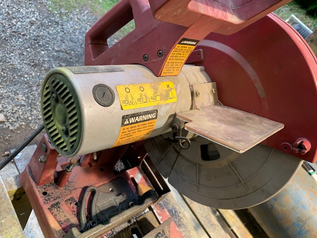

I am going back with the guy said most of this doesnt require precision
I rarely cut 45 with a saw and rarely then. I dont have to design every angle they ever invent and out of structural I rarely use tube unless I have to and even less at 45.
That is kind of an amateur type thing fostered by the internet. I built 2 or 300 benches and used 45 on one and no angle cuts for the tube which I did for legs mainly due to customer request.
My chop is set to 90 and hasn't been moved since it was set there.
