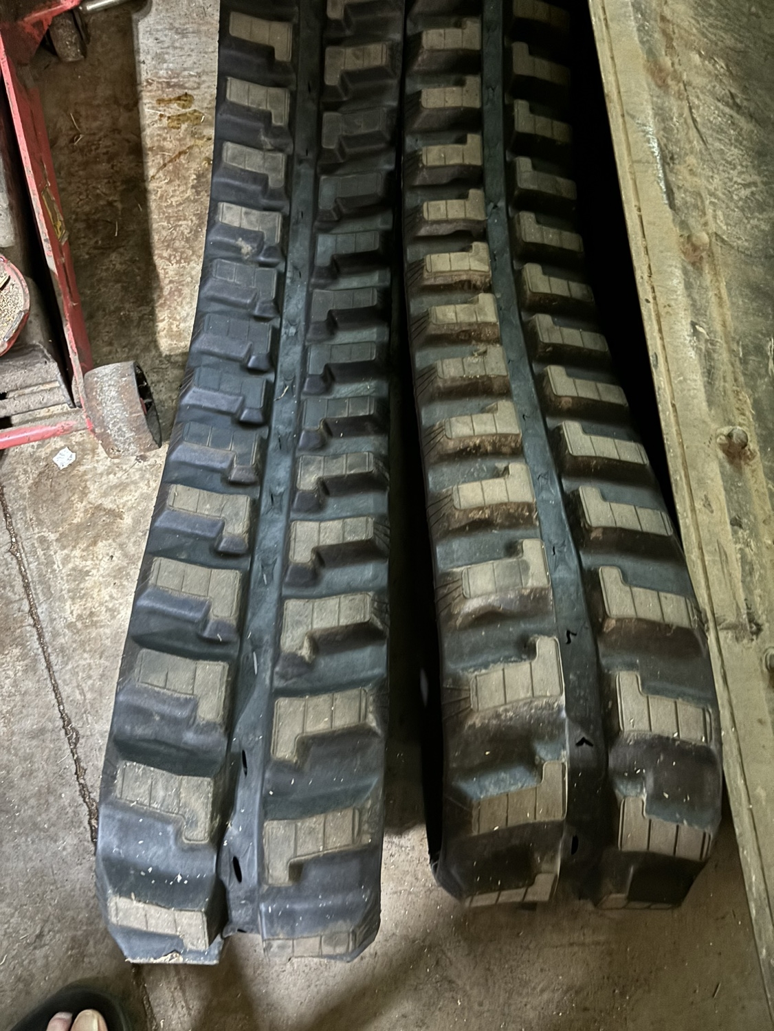

The 180x72x41 tracks on these tend to tear up the lawn even when trying the lift and move method. Granted I am not proficient yet in driving this either, but I wanted a wider track (230 MM) and something better on the lawn.
I found these on ebay and ordered two NEW 230x72x41 Track Diamond Back Tread Fits Yanmar B158, CO6R, KH41, KH41R | eBay for $435 including shipping. They are made by Prowler Prowler Rubber Tracks for Skid Steers, Excavators, Track Loaders
Thought this might be of interest to others with the same/similar machine, They have other sizes too for sale on ebay,

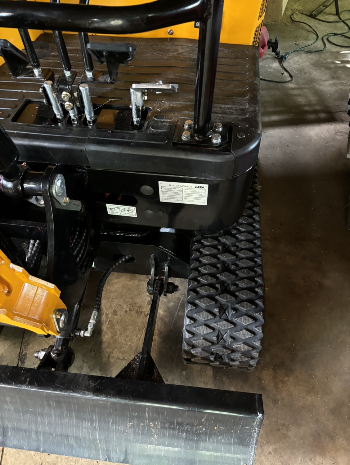

Got the new tracks installed - much smoother ride and doesn’t leave divots on the lawn either

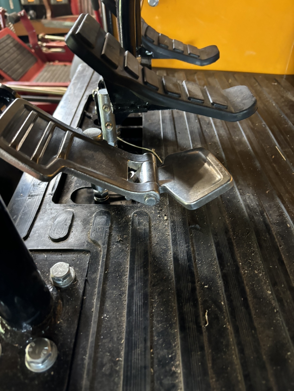

Modified the thumb /tilt bucket aluminum foot pedal - drilled and tapped a 5/16 bolt and nut thru the swivel portion so it’s at an angle now so it’s a more natural foot and ankle movement now to close the thumb and enables more precise control

One other note in the tracks - there’s a spring 3/8” thick x 2” around in the adjustment mechanism that holds the tension on the tracks - so unless you’re doing something aggressive or get rocks in the drive sprocket they won’t come off - also checked the pulleys and bearings all tight - no grease fittings on the rollers so are sealed units

Looks good. I definitely need the deeper lugs with my slopes here, but I can see how yours could help your situation.

may have missed it, why did you change tracks? how many hours on it now?
/ Chinese digger recommendations #110
See post 104 the 7” lug tracks imprint the lawn and rip it up - the diamond tracks are 9” so 30% more ground contact and are made for traversing lawns and dirt and are a smoother ride
8 hours total - just getting started using it - once mods were done
I have a backhoe on my b21 too so this is more of a specialty machine to load rocks and build walls and assist the kubota
