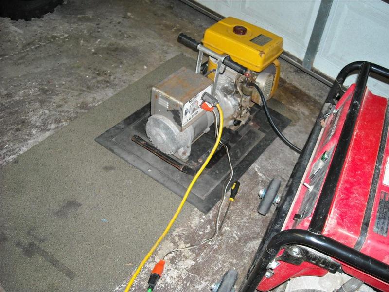

Nice compack unit. Mine is a 1983 model Robyn 3500w. Little noisey but not to bad if I back off the rpm a bit. Actually during Ike the little Robyn out performed my neighbors Honda EM5000s I used a bit(he was out of town). About as loud as the Robyn but screamed rpms, and used more fuel...something I couldn't believe.
Asking $2600 for the Honda on the web, that one not worth it IMO. It actually died on us a few times. My neighbor was using my Robyn for 5 days until he borrowed another generator.
