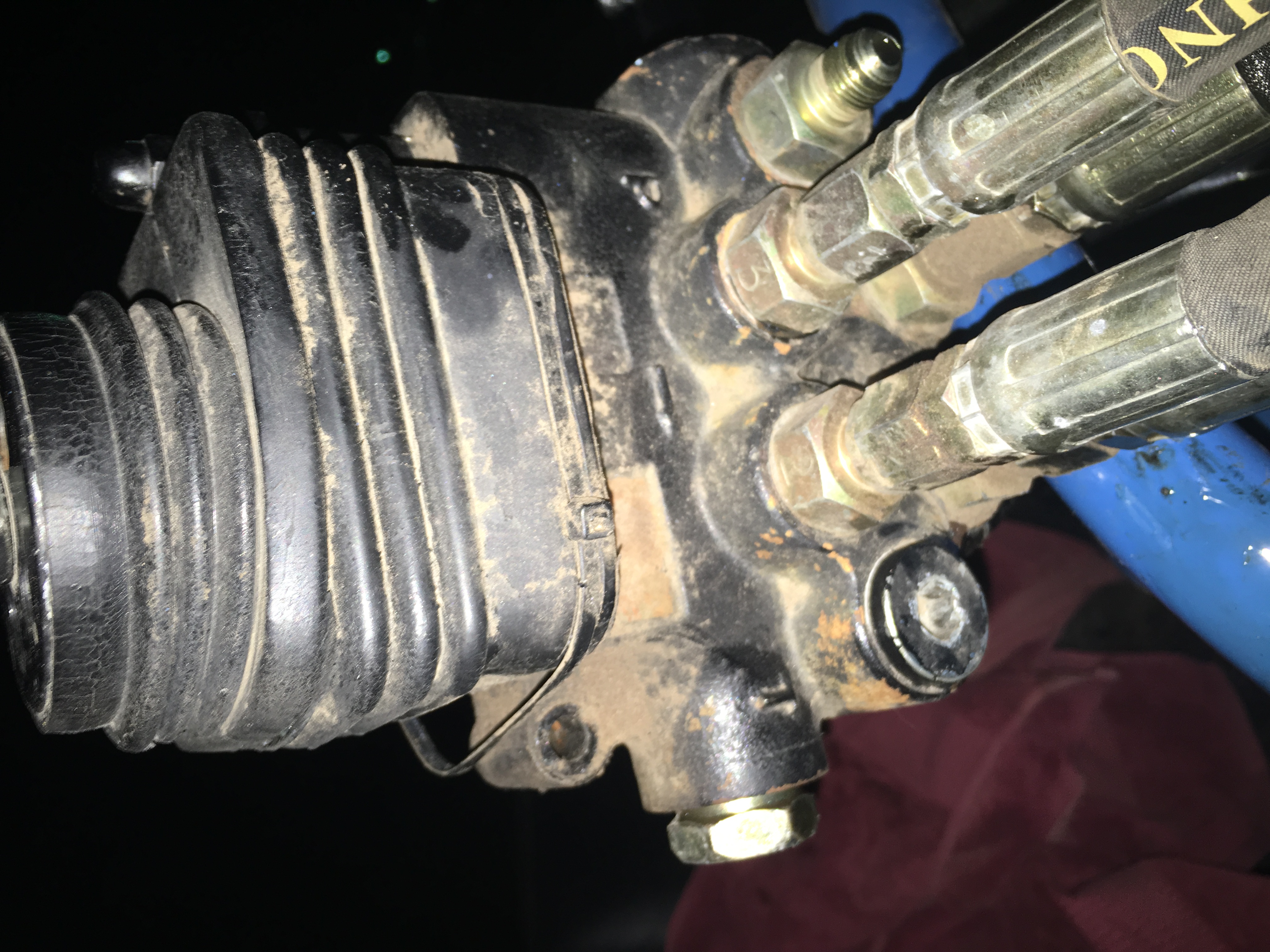

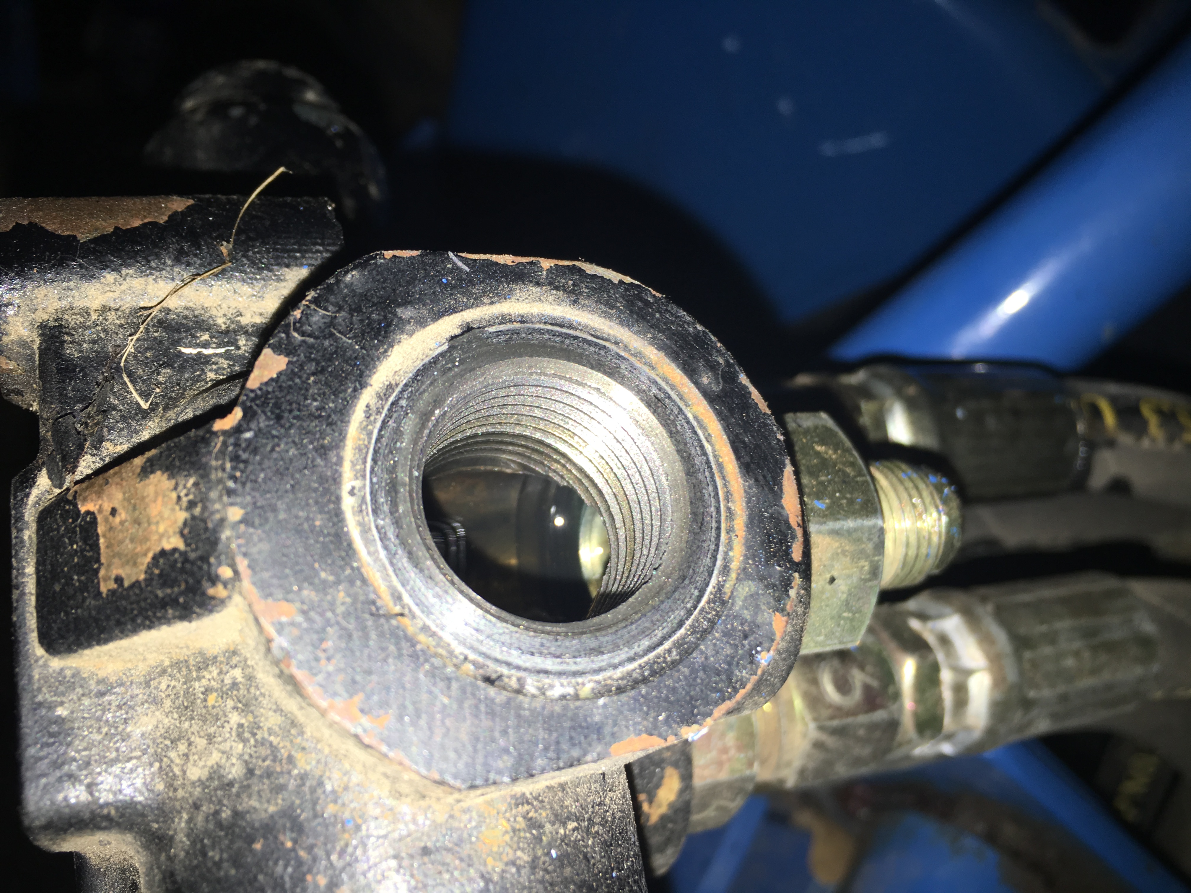

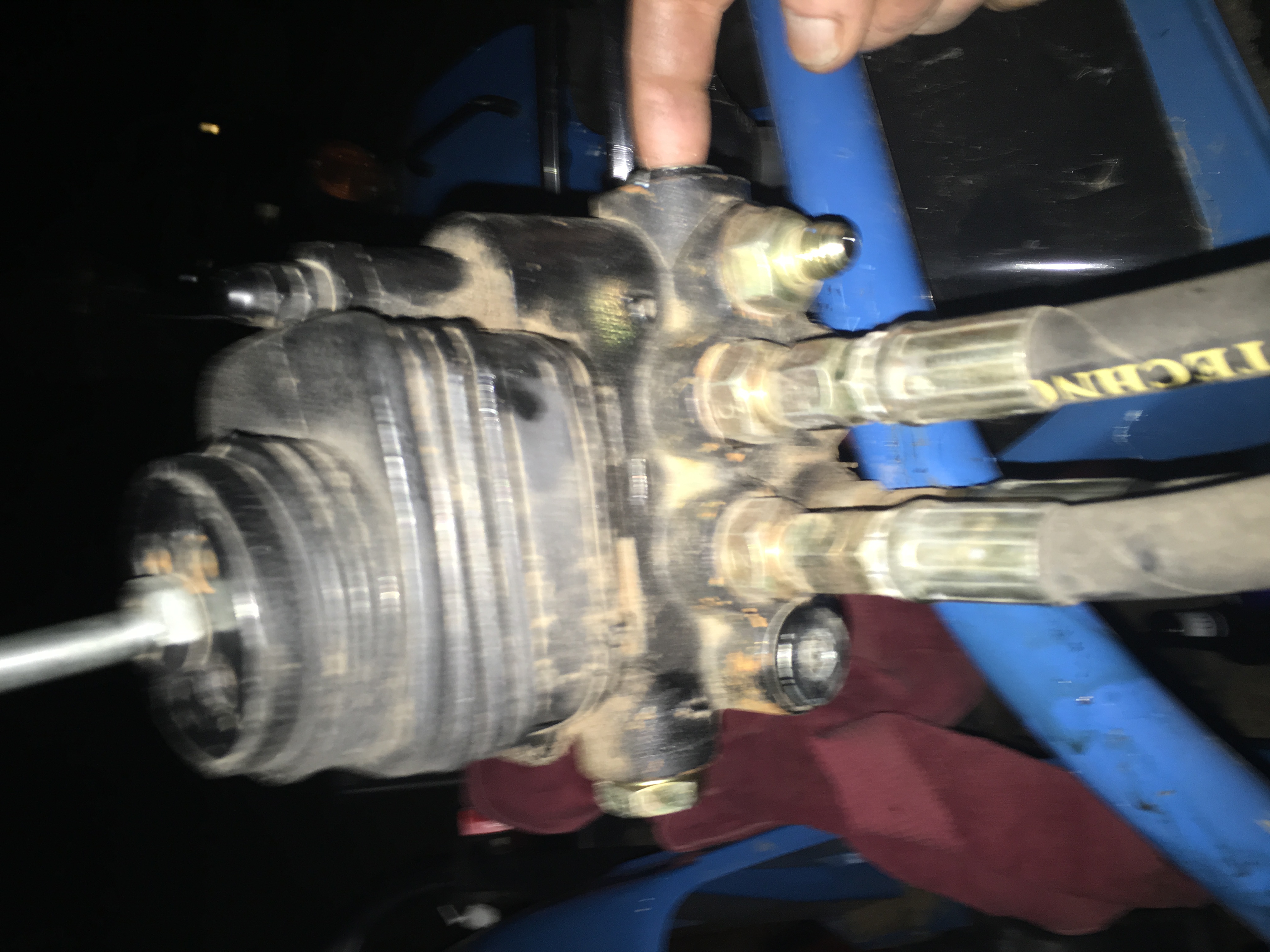

IF I'm understanding you correctly, and if it matches mine, there is usually two ways the high pressure can enter (also exits) the valve. So you saying "shares an open port where my finger is that has a plug in it" makes sense.
Normally a power beyond plug is INTERNAL, below is NOT your valve but shows the nut (HIGH PRESSURE CARRY OVER PLUG) for power beyond.
https://www.surpluscenter.com/_MoreSpecs/iPrinceMBValves.pdf
Hydraulics is totally confusing at first.... then it gets worst :D :D
/ chief p-80 single spool help
#22
Now that makes since, thanks a lot!! so now I either find the adapter plug that allows PB from existing FEL or buy a new loader valve. I really appreciate you explaining that the way you did.

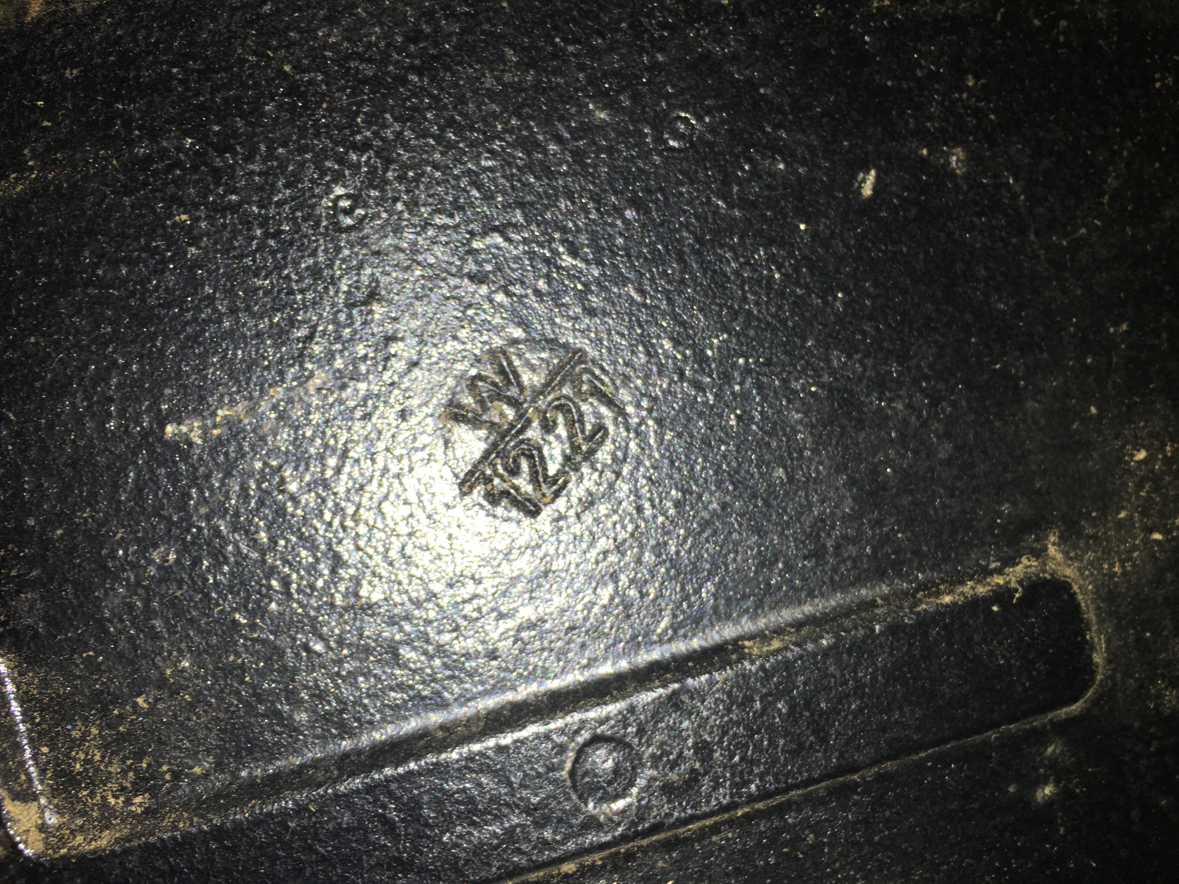

teg, you are right its plenty confusing to me. anyone know what make that loader valve is. only thing I could see on the valve is what's in the above pictures

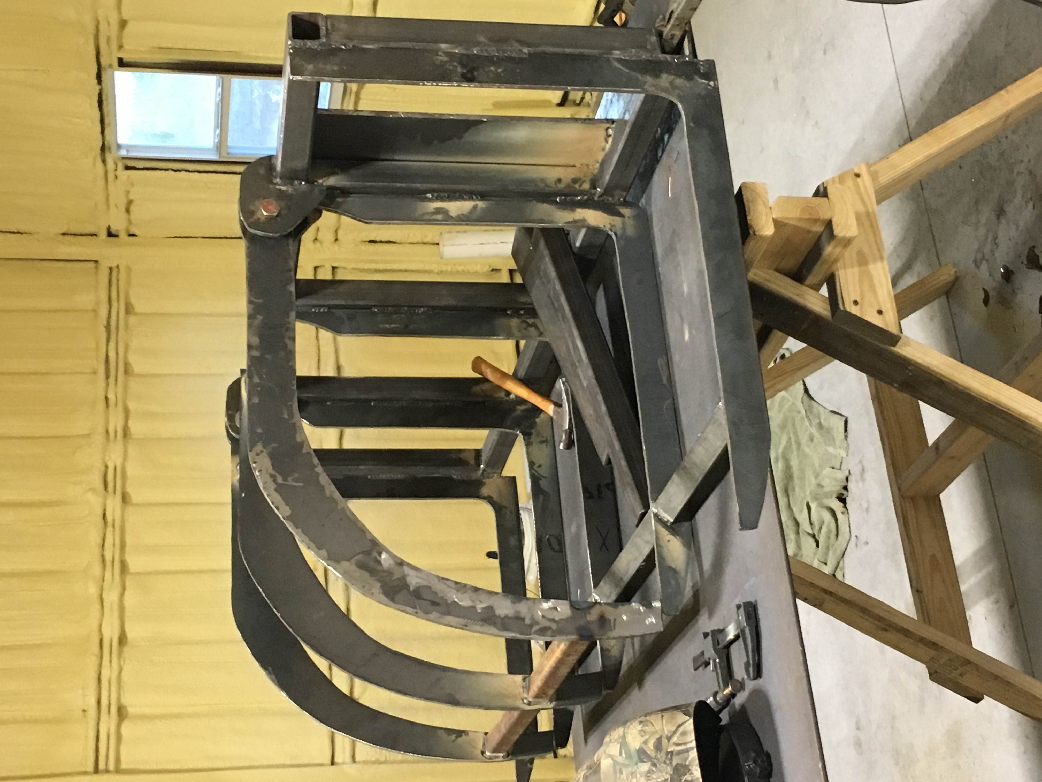

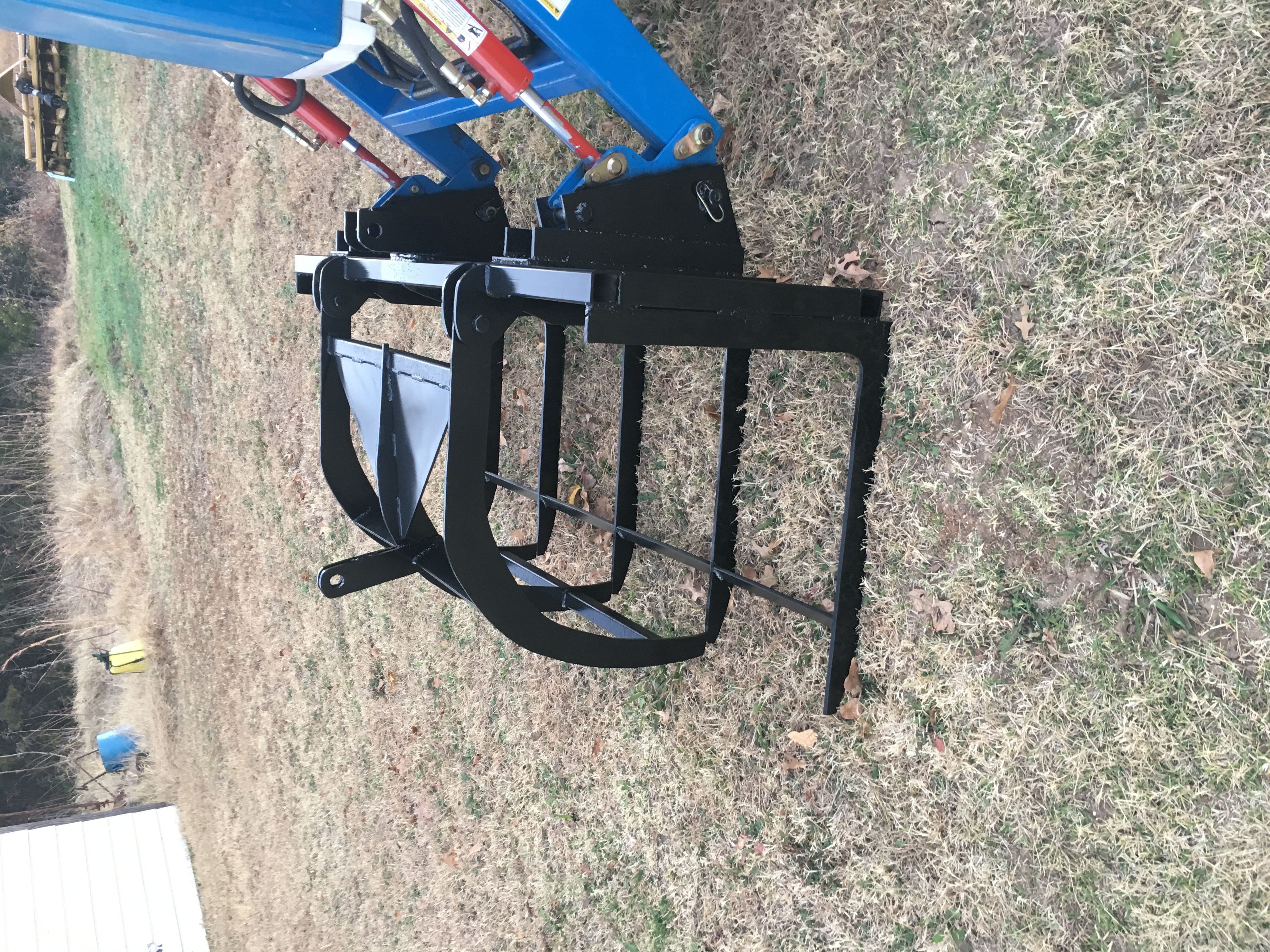

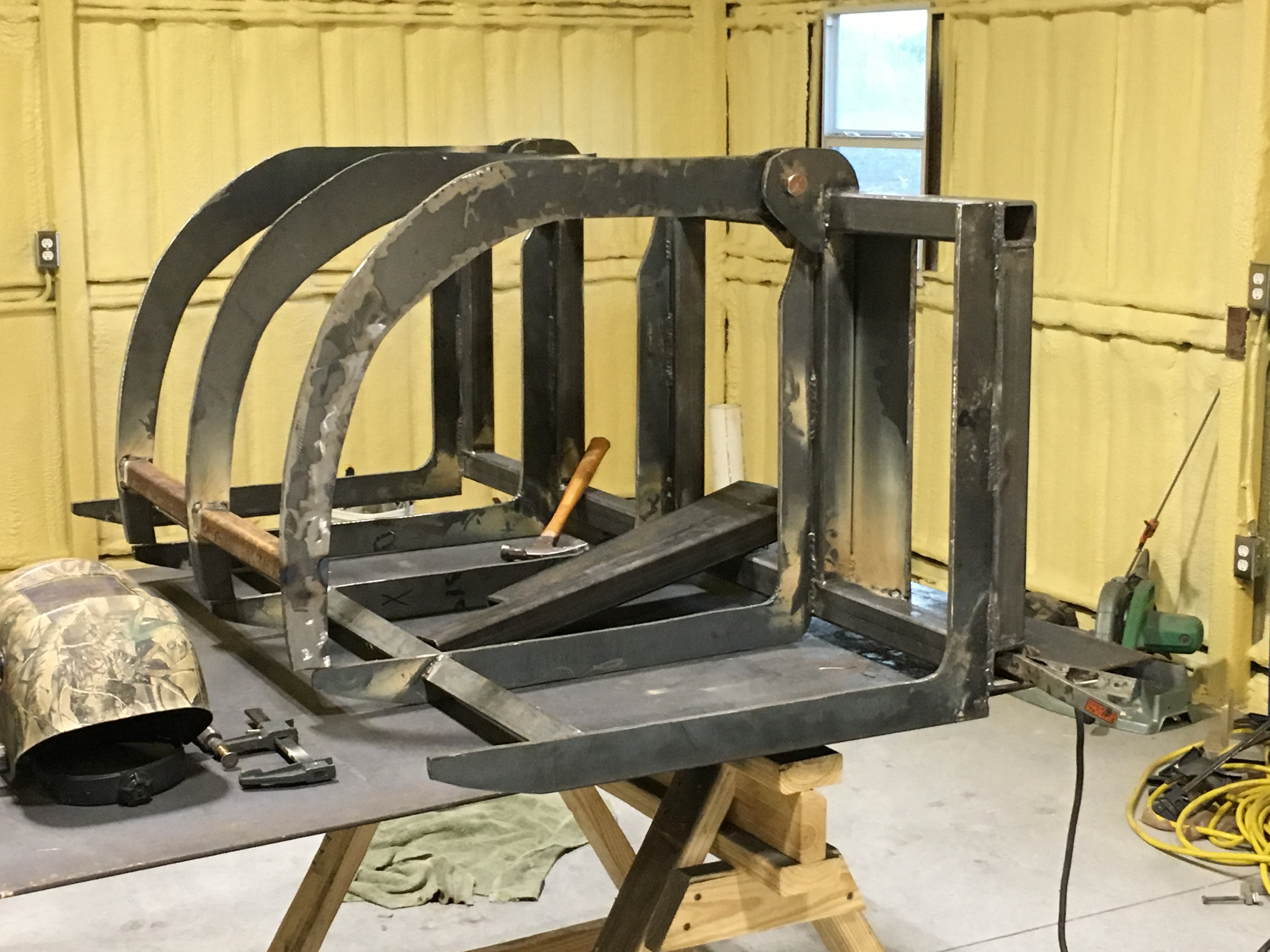

Just thought I would send a few pictures of my brush grapple.
