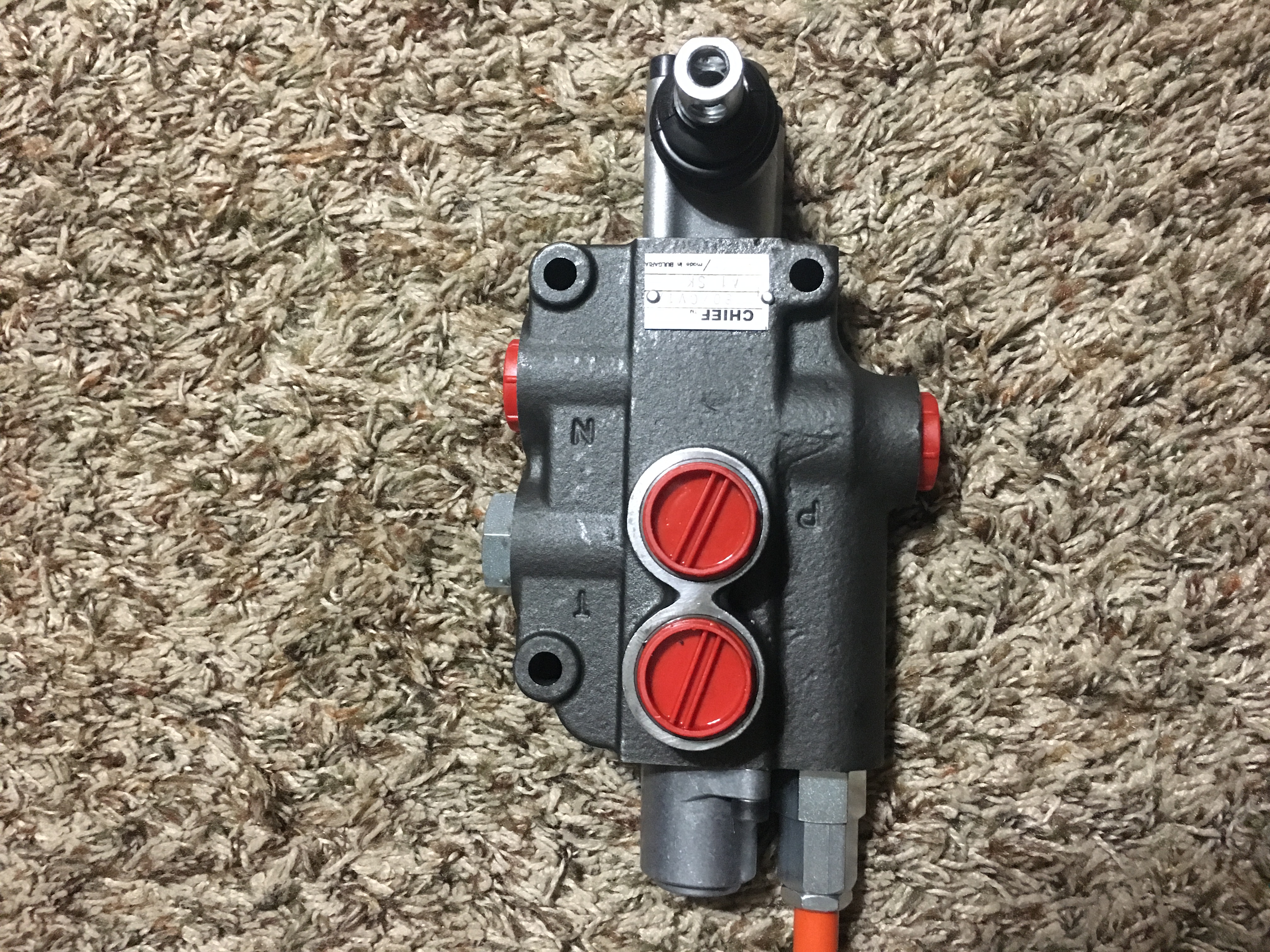

Hello everyone
I am hoping someone can help with this seemingly over my head issue. I just purchased a chief p-80 series valve for a brush grapple I have just made.
1. It has the T port blocked off from factory and says this is correct for double acting cylinder use, is this correct
2. It has a N port right next to the t port. can this port be used for return to tank? and what is the N port?

1) This depends on the valve is designed but most valves require the "T" port be directly connected to tank.
2) Not sure what the "N" port is. I found one website that shows this as the power beyond circuit so if there is a connection between the "T" & "N" then yes you could use this as the tank port. Some valve have the option of installing a plug that isolates the Power beyond from the tank. This valve may have that option.
3) Yes you can tee the tank lines together. You can NOT just tee into the pressure line though.

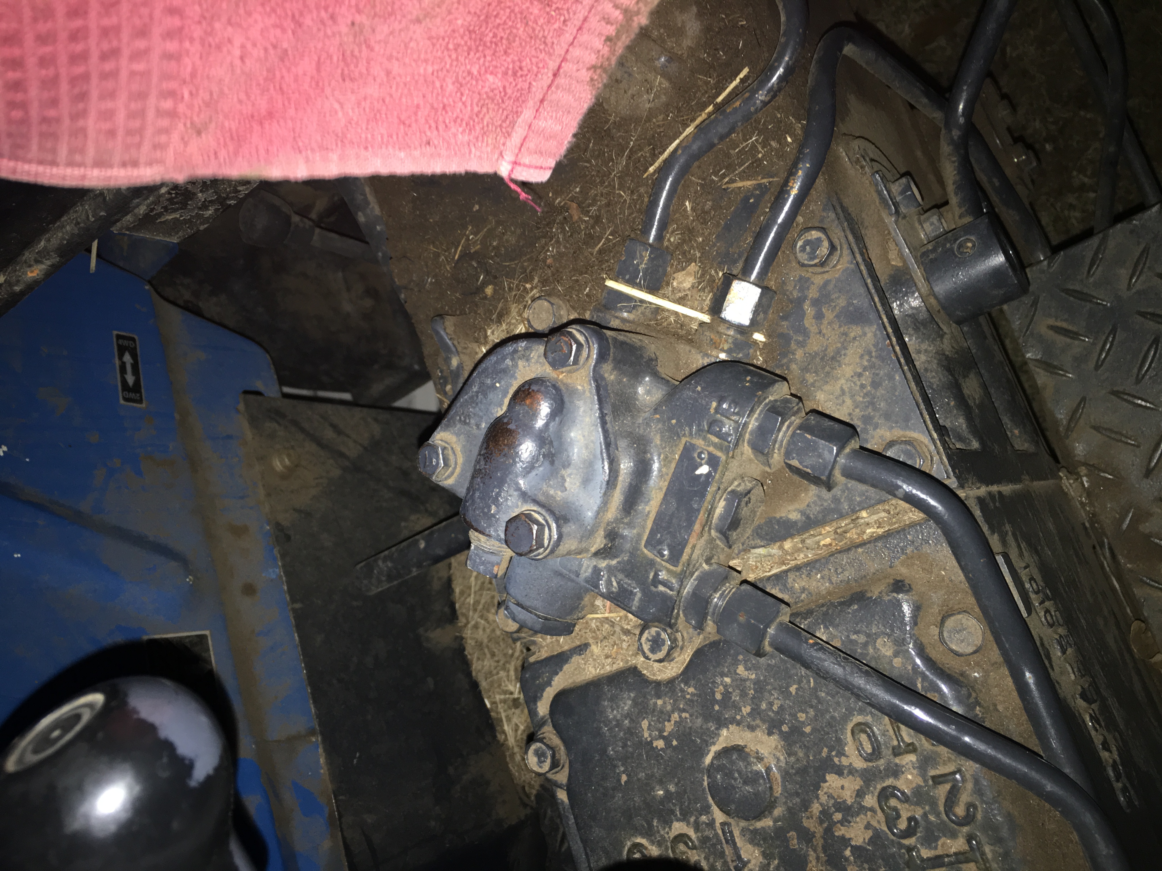

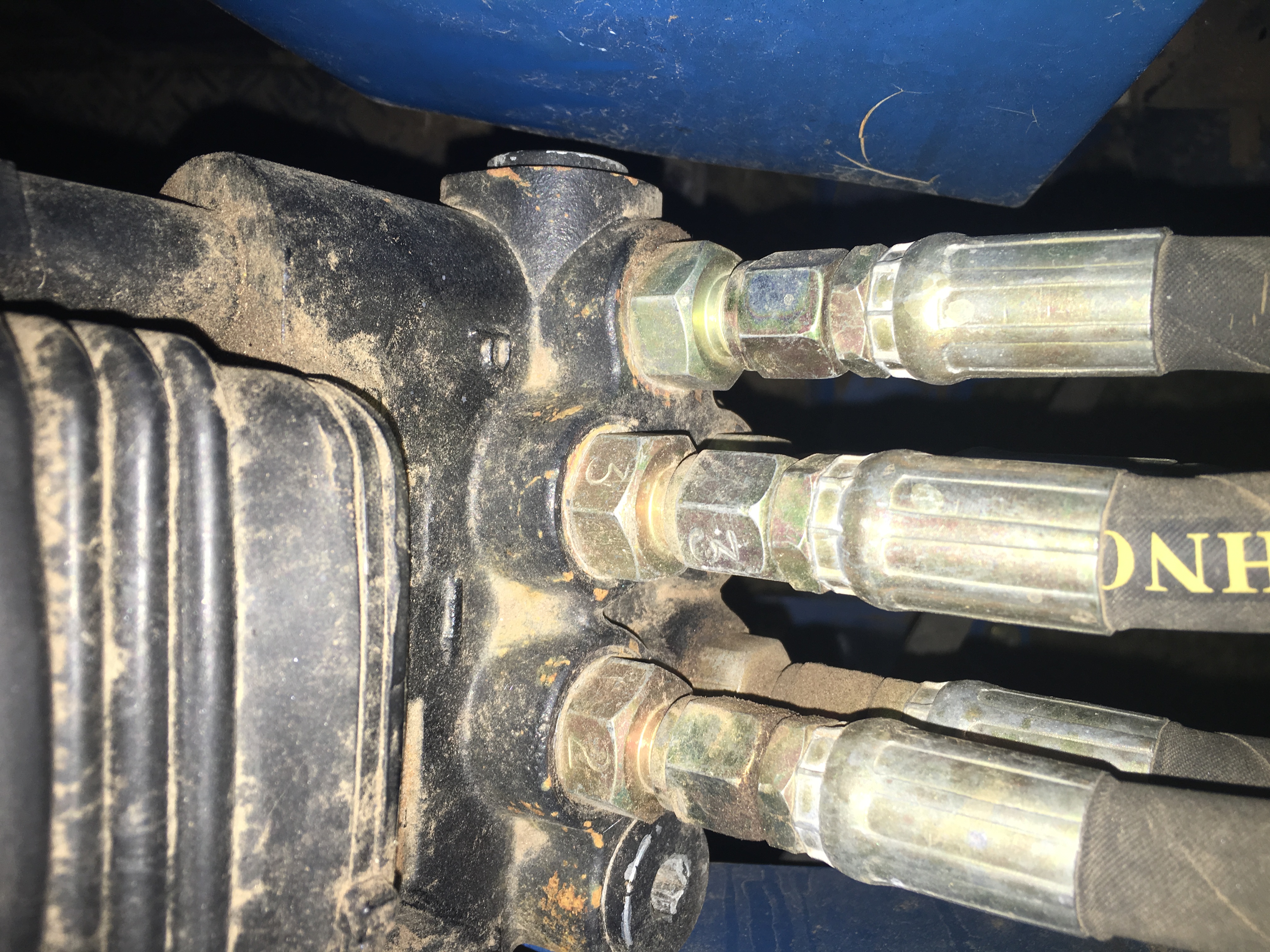

Sorry guys I wasn't sure how to post these.

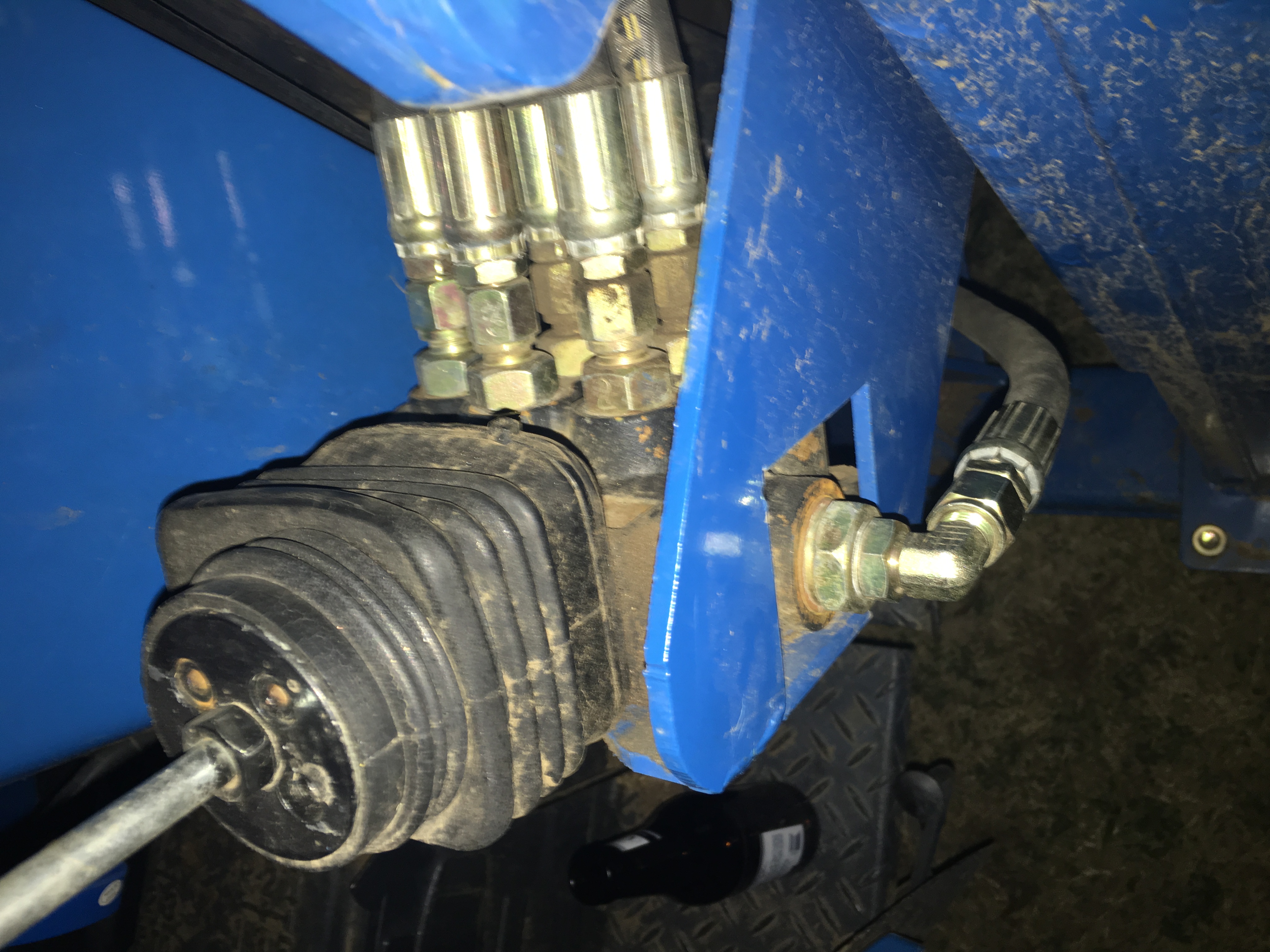

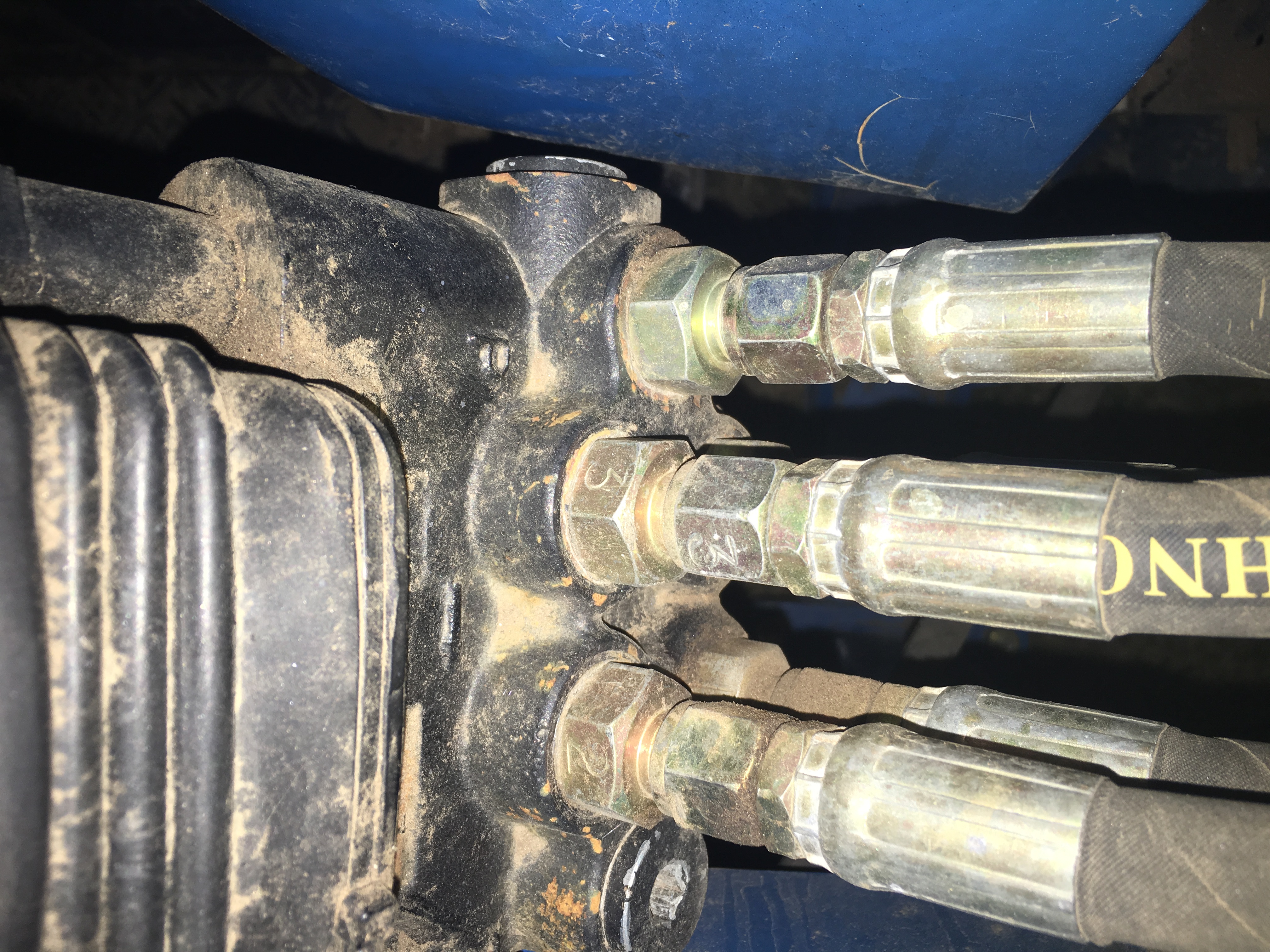

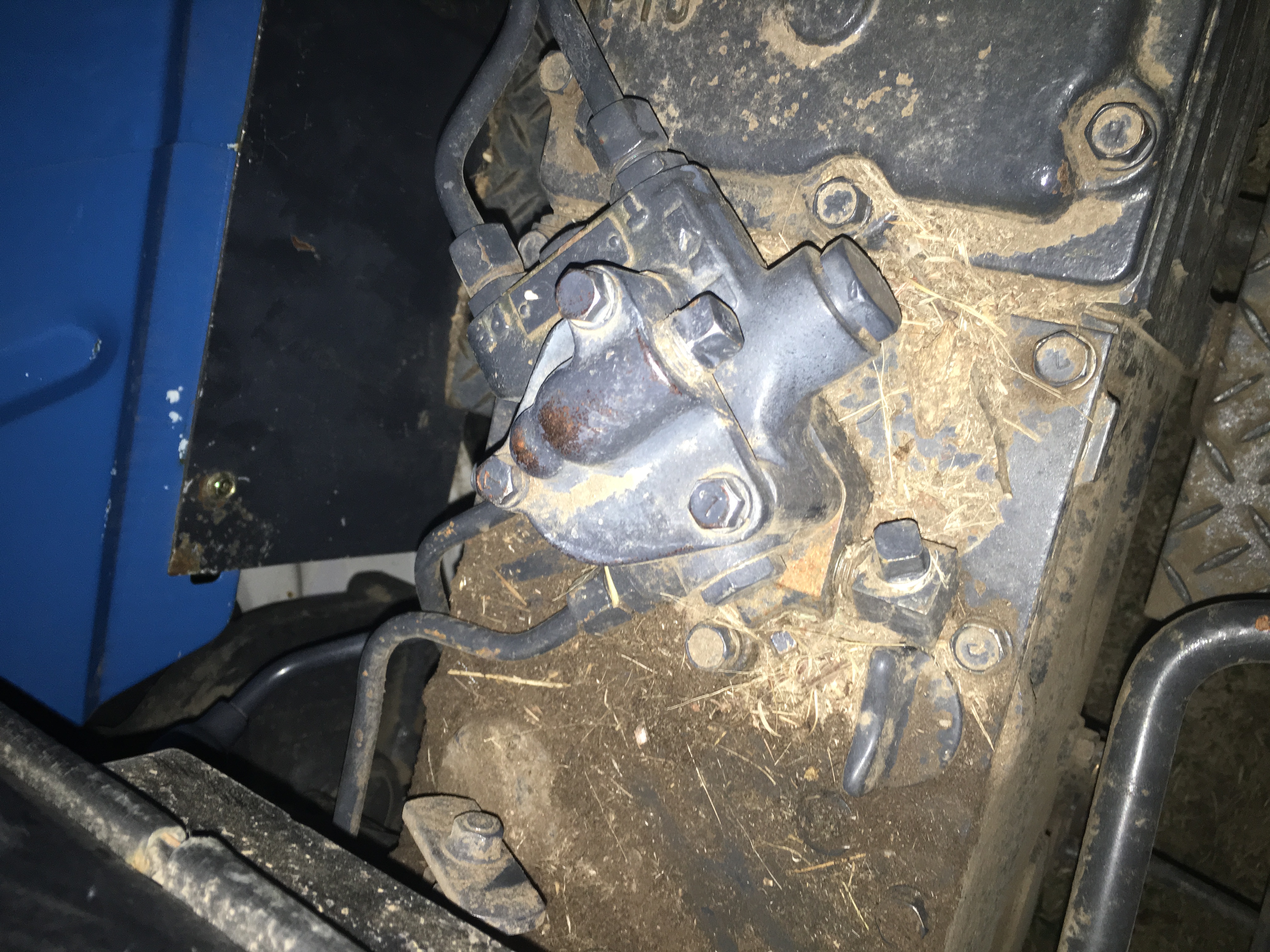

Top left is a valve that's just in front of the seat between my knees on the tranny housing. It has a couple plugged ports. My Fel valve as you can see has 4 working ports, power or supply line is just under the p letter. Return line is on the outside of the valve with the 90 degree fitting pointing down. If you look close you can see a plugged port bottom left of valve and a plugged port right side of valve located just above the supply (p) on the side of valve opposite side of return. Thank you

/ chief p-80 single spool help #9
Found this on a other Tractor by net post.
Here you go:
T = Tank port (return going back to the sump)
P = Pressure inlet from the pump
N = power beyond outlet to the Next valve
Connecting these lines incorrectly may cause a pump failure so be carefull.

Thank you! b7610hsd. can anyone tell if the FEL valve has a PB that I could hook the new valve to?

Called bailey hydraulics this morning. they say the t port will need to be plugged for double acting cylinder N port is return (weird) so let me know if im thinking wrong here. my loader valve has the power beyond on the right where its plugged on the side? return port is plugged on the left? so can I run the return out of the new valve into the port on the left on the FEL valve and supply from plugged port on the right? Thanks guys!
/ chief p-80 single spool help #12
I am thinking you need a new valve.
Dont see anything that indicates that valve is capable of power-beyond.
Perhaps call baileys and ask them if the valve is capable of power beyond. Because you NEED that to feed whatever your current loader PB is feeding.

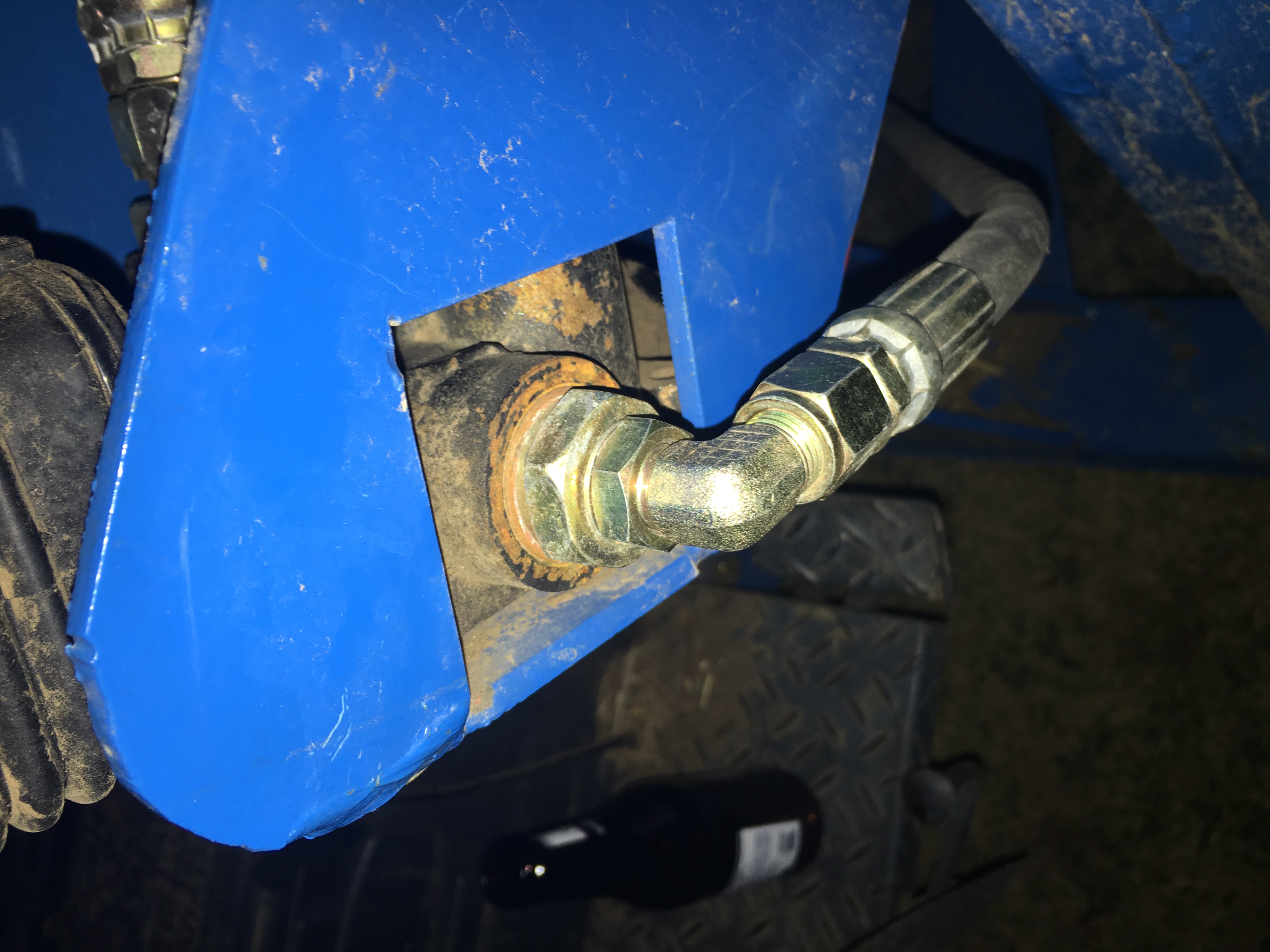

power beyond from loader valve is blocked off with a plug on the right of valve (I think). the loader valve only has a supply, 4 working lines to the loader and a return line going back to the tank, and 2 plugged ports one on the left side and one on the right. the 3 point feeds off of the weird looking valve on top of the transmission housing that feeds straight from the pump mounted on the engine block by the radiator. hope this helps explain whats going on. these tractors where not originally equipped with loaders this is all after market other than the 3 point. new valve is not PB capable. it only has a supply port, 2 working ports, T port which bailey is telling me is only for 3 way operation single acting cylinder and needs to be blocked and the N port which they say is my actual return port for 4 way or double acting cylinder.
/ chief p-80 single spool help #14
Then your loader valve is the only valve in the circuit. And with only one valve, NO PB is required.
If 3PH is fed elsewhere, great.
You need to add a single valve in the circuit, to have two valves total.....your loader valve and your new chief.
Only one needs to have PB. And that needs to be the first valve.
Since your chief valve dont have PB, Then just supply it off the PB that is plugged on the loader valve, and return to tank as normal.
Just make sure you have the correct PB adapter for your loader valve to supply the new valve.

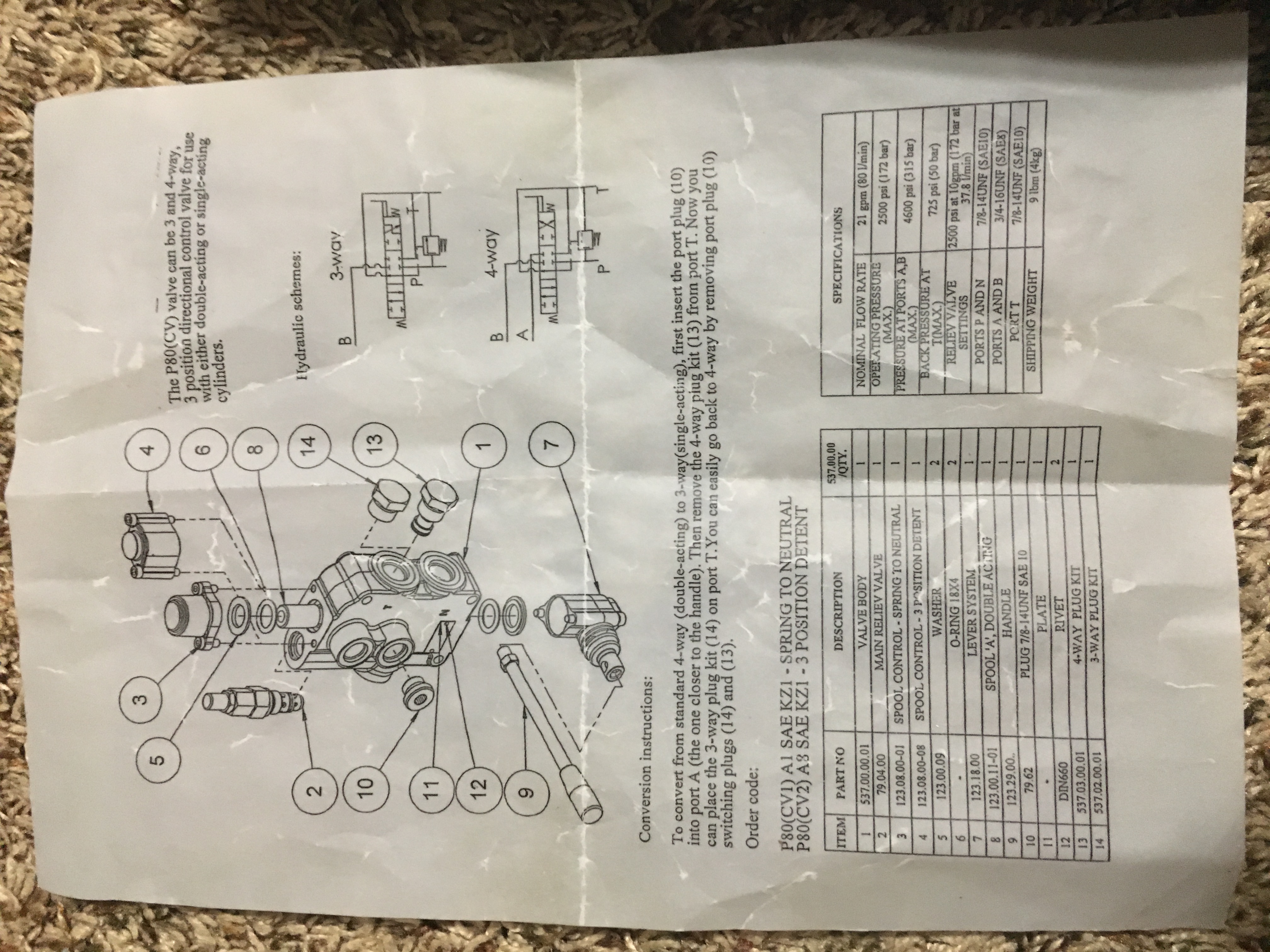

I found this document on the net. I can not see where it states if power beyond is an option for the P80. Since it has the "N" port it might be. The larger question is does the existing FEL valve have Power beyond capabilities. In looking at the pictures I only see six hoses connected to the valve.
  • p80drawing.pdf

you are correct, the new valve does not have a PB. the FEL valve I think does but am not certain. this all confuses me. I took the plugs out of the blocked ports last night and what I found was the pressure line on the right (line removed with fitting in place) shares an open port where my finger is that has a plug in it. port on the left is an open port that shares an open path with the plug that is in place on the left. sorry guys im still a bit confused on this, so is the port on the right that is plugged considered a PB port. PB is what im confused with my return I understand. thank you guys!
/ chief p-80 single spool help #20
Usually valves have two options for locating the pressure line. The one not used is to be plugged. You cannot use a second line where that plug is, because that would be like putting a tee in a pressure line, which don't work on open center systems. Only closed center systems.
Power beyond is totally different than anything you have on your tractor now, so I'll do my best to explain the theory, and hope you grasp:
Power beyond is for running multiple separate valves in a open center circuit.
Your current loader valve is a single valve. So it isn't utilizing any power beyond. It simply has pressure in, return to tank, and work ports that actuate the loader.
