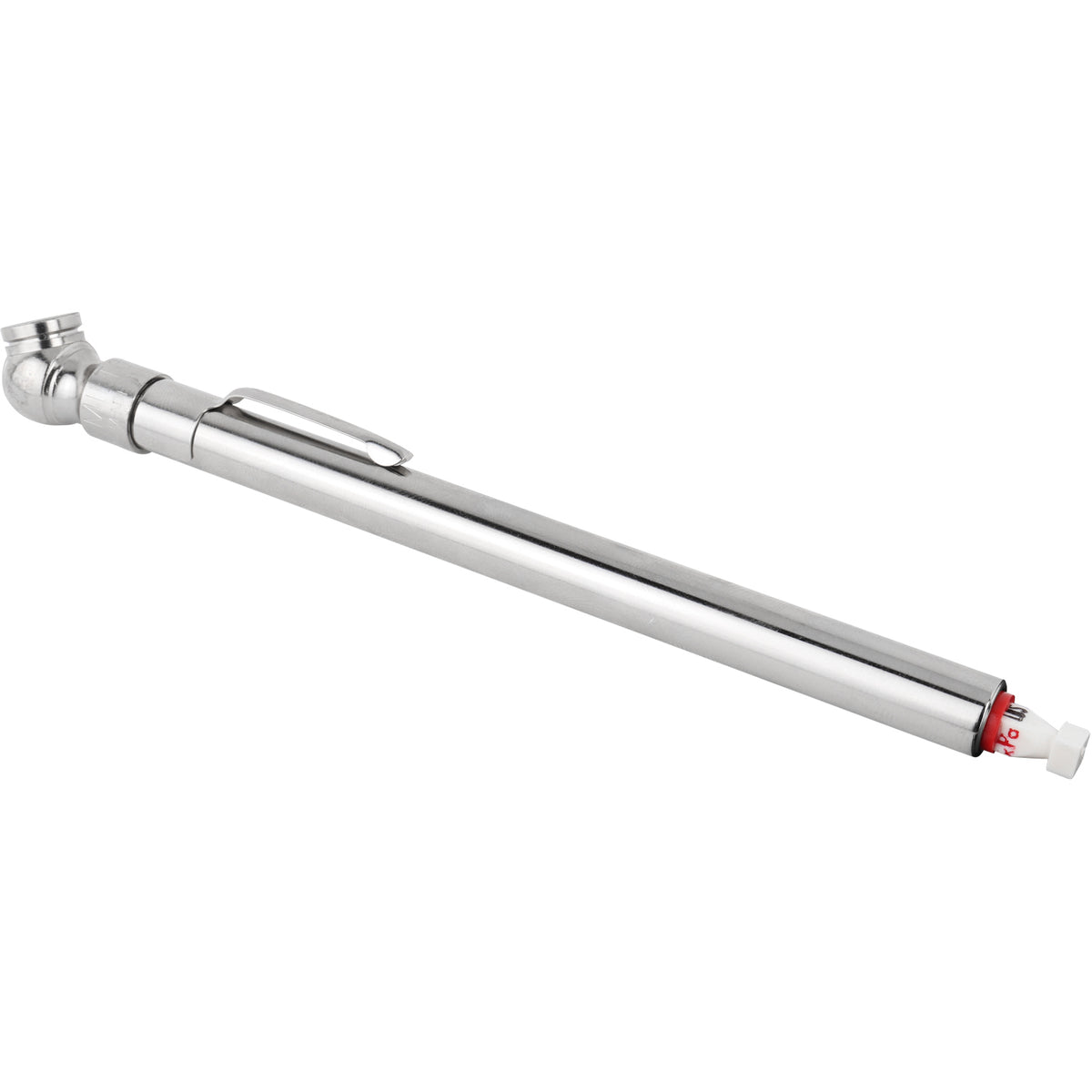

This one will work Amazon.com
I used to have two of them, read - destroyed them by using on my filled tires, no mater how long i rinsed them after use, by the next time they were unusable. Also, used one from HF with long hose which also had the same outcome. I was not able to remove all the beat juice from inside no mater how long i was messing with them. Now i check the pressure by the look (really scientific ;))
   / Checking filled tires pressure #22
Milton model S-298 is designed for use on fluid filled tires. You do need to rinse it out with warm water after use or beat juice will set up and make it sticky.
You probably mean S-928. It is exactly one i used to have. Actually still have, but they are useless. they do not show right pressure after exposure to beat juice and prolonged shower exercises.
