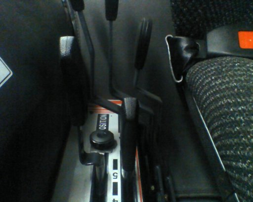

I recently looked at one while at the dealer last week for an emergency hydraulic filter.
Looks like a very nice machine. Large by comparison to my 3510, so make sure you physically look at the size.
Here are a few things of note.
This one had a cab on it.
It had three sets of remotes, with three separate control levers.
It has a single, 2 part hydraulic gear pump- presumably for power steering and the tractor hydraulics. (Mine has two separate pumps, seemingly due to space limitations)
The 3pt arms had a "Pat's easy change" kind of setup. It also had a (sample) set of "balls" instead of pins inserted into the hitch arm. This would be the part on the implement. I believe this was do demo how the setup works.
Had a rubber "curtain" hanging over the area above the 3pt and remotes. Gave it a neat appearance and would likely keep mud and debris out of this area.
IMO, they have really taken their time to work on fit and finish.
I am not in the market for a new tractor right now, and it would be too large for my current usage. I need to be able to trailer easily for various jobs.
But... I took some pics of a few things anyways. Enjoy!
- JC
/ Checked out the new 4035 Friday #14
That is a 4510 not a 4035, just an FYI
Buck
Sorry for the mistake...(Now that I look at it, the brochure says the same thing :ashamed: )
- JC
