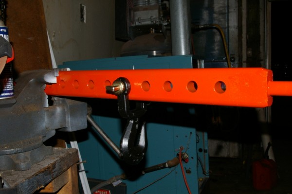

I picked up a drawbar and a Clevis hook @ TSC today. My skidding tongs should be here tomorrow. I'm going to hook the tongs to the hook and away I go. Don't need a drawbar lock or Top link. Just pick it up and go. I hope. What do you think??

Sounds dangerous. A drawbar like that isn't meant for that task. If you are going to skid logs cheaply, you should attach a chain to the tongs and the other end to the swinging drawbar. The swinging drawbar is attached to your tractor frame BELOW the centerline of the rear axle and is meant for pulling.

1. Rule number one... always pull from the drawbar.
2. Rule number two... see rule number one.
3. Those are ok to move a trailer around but not for heavy pulling.

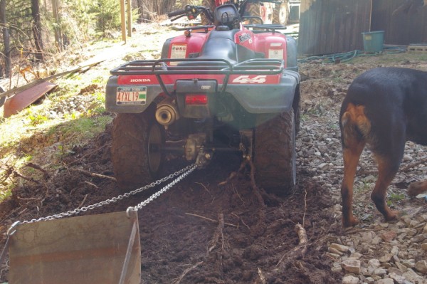

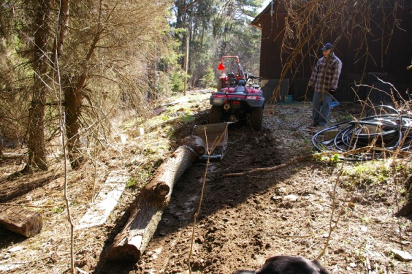

I pull 1000 pound trunks with my quad and skidder... This is a much smaller one but you get the idea. I want to use my tractor to get it off the ground and keep the mud off the trunks as much as I can. Common sense plays a big part here. I'm not going 10MPH through the woods......

One thing I might mention here is pulling a log that size with a 4wheeler, if the log starts going to the downhill side (a log will roll down the slope), it might be enought to pull the 4wheeler over the edge also (especially if it is muddy). Does this make me a member of the "safety police"?

BTDT,
When I haul these logs down, I have a treeline on both sides so if the log starts sliding sideways it just glances off the trees and keeps it going straight. You're not acting like the safety police, you have common sense. Low and slow is the way to go when hauling logs. Anything can happen at anytime so complacency isn't an option. Now I sound like the safety police..

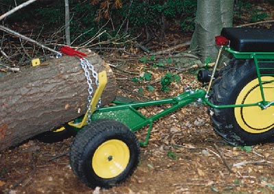

The attached pic looks very scary when you look at whats pulling the skidder. Especially if he has 1 brake....Don't know where I got the pic from...

This worked really well for me. Cheapo 3pt 2" rcvr hitch and tongs.
The picture is misleading...the JD750 is huge, it just makes the log look small.[:)]

That tractor look like a mega machine. If those are the tongs I just got today they are too long for my 3 PT and your tractor is big. The ones I got from Northern open up to 33" and are 36" from the top of the 1 3/8 ring to the bottom of the tongs. That log looks like it weighs 20 pounds... Nice setup you have there. Do you do a lot of skidding??
