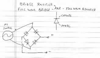

Soundguy,
I attached another scan.
I'm not sure what you are calling "the positive output from the diode bridge" (I'm no electrical engineer or electonics technician). Is that the wire I've labeled "Y"? The tractor is wired just like I've drawn it. The alternator is actually grounded through the case, so there is no wire there. Of the two wires coming from the alternator bridge circuit, the yellow one "Y", one goes only to the VR. The red wire, "R", goes to the starter solenoid hot side (where the + battery cable is attached - I circled this location on the drawing).
In reference to all of the other posts regarding voltage regulators, this is a permanent magnet type alternator - so there is no field, and therefore field current to vary.
The VR is a small thing, about 2.5 inches long, 1 inch thick, and about 1.25 inches wide. It has an aluminum case and is epoxy filled from the underside. It seems to me that this charging system could work with the VR just being a relay which grounds the "Y" wire that goes directly from the alternator bridge circuit to the VR when it detects a voltage at the battery + "R" wire above some threshold. Does that sound reasonable?
Greg

The "Y" wire shown is an AC output to the VR. It may be used to tell the VR that the alt is now charging and it is now time to close the alt to bat circuit to permit current flow to bat.
Put a voltmeter on this lead to sure that the latching signal is getting to VR.
It looks like you folks have a 1 phase, constant rate, PM, type of alternator. For a cheap, heavy duty rectifier bridge go to an auto parts house and buy the rectifier bridge from a Delco 10SI alternator (all GM cars 1965/1990). This is a nice all alum heat sink unit that will last forever with your small alt. It is a 3 phase diode bridge unit and you will only use 1 of the three taps. Buy a mini-box and plastic insulator material at Radio and stick diode bridge in box. Box must be grounded well for neg leg of dc circuit.
By the way, the "Y" ac wire is also used to run electric tachometers by converting frequency to RPM on many diesel engines.
Not having to worry about modulating field current puts this project within reach.

Your post of 4/25/02 said that both your alternator and DIODE BRIDGE are working fine. I assumed that the diode bridge that you are talking about is in the alt. If this is the case then you have DC not AC coming out of the alt.
You cannot do anything with the AC coming out of the alt until you change it to DC. Look at my post on using the diode bridge from a Delco 10si alternator to do this job.
You cannot run the AC to ground since 1/2 of the sine wave would be a dead short (pos to neg).
All you need to do on your unit is convert the AC output to DC with the diode bridge. No cut out or relay is required since the diode bridge between alt and bat would be in reverse bias and no current can flow from bat to alt with engine off.

Did you take a look at the diagram I attached to the last post? (I attached it here again). The diode bridge is on the back of the alternator and is working, but the regulator is not. There are two wires from the alternator - one goes to the VR and this is AC, unrectified. The other wire from the alternator goes to +B, and this is rectified. The VR has 3 wires. One goes to the alternator AC as I said above. The other two wires from the VR go to +B and ground.
If the VR senses +B voltage, and closes a relay to ground the alternator AC, I think this would cause the system to stop charging. The rectified output of alternator no longer produces voltage. All I'm trying to do is figure out what exactly the VR does in this setup. It doesn't rectify, because the diode bridge on the alternator does that. It cannot regulate charging by varying field current because the alternator field is from the permanent magnets in the alternator. How does this setup vary charging. Does it just turn charging off by grounding the alternator AC when +B voltage is high enough? That is all I want to know.

Greg, I know you got 30 AC at point Y at alternator. You should also get 14/15 volts DC at alt point R which is the DC output of unit. If you don't get 14/15 volts here and have 30 volts at point Y then you have a problem with your alt diodes coverting AC to DC. Most likely open diodes.
Since your alt has a PM field, taking wires Y and R off at VR should let your alt run wild (charge max) if it is a full working unit.
Don't really understand your VR role in circuit as shown.
A maybe theory here would have the Y wire sending a signal into VR that turns on a bleeder circuit only with engine running (AC signal). Bleeder circuit would go off with engine thus taking care of a battery back feed problem when engine is off.
A voltage regulator acting as bleeder unit and dumping off excessive charging voltage to gnd at VR is not comon but has been done with low amp units. Since this is a low charge alt we are not talking of a lot or wattage (heat) here. Soundguy mentioned this type of VR in his post earlier.
Also, if you show 15V at alt R point but not at bat then with engine running try hooking a heavy jumper wire from terminal R at alt to bat B+ and then measure bat voltage again to check this out. If you have 14/15 DC at alt term R and just 12.6V at battery then my guess is an open between these two points.
