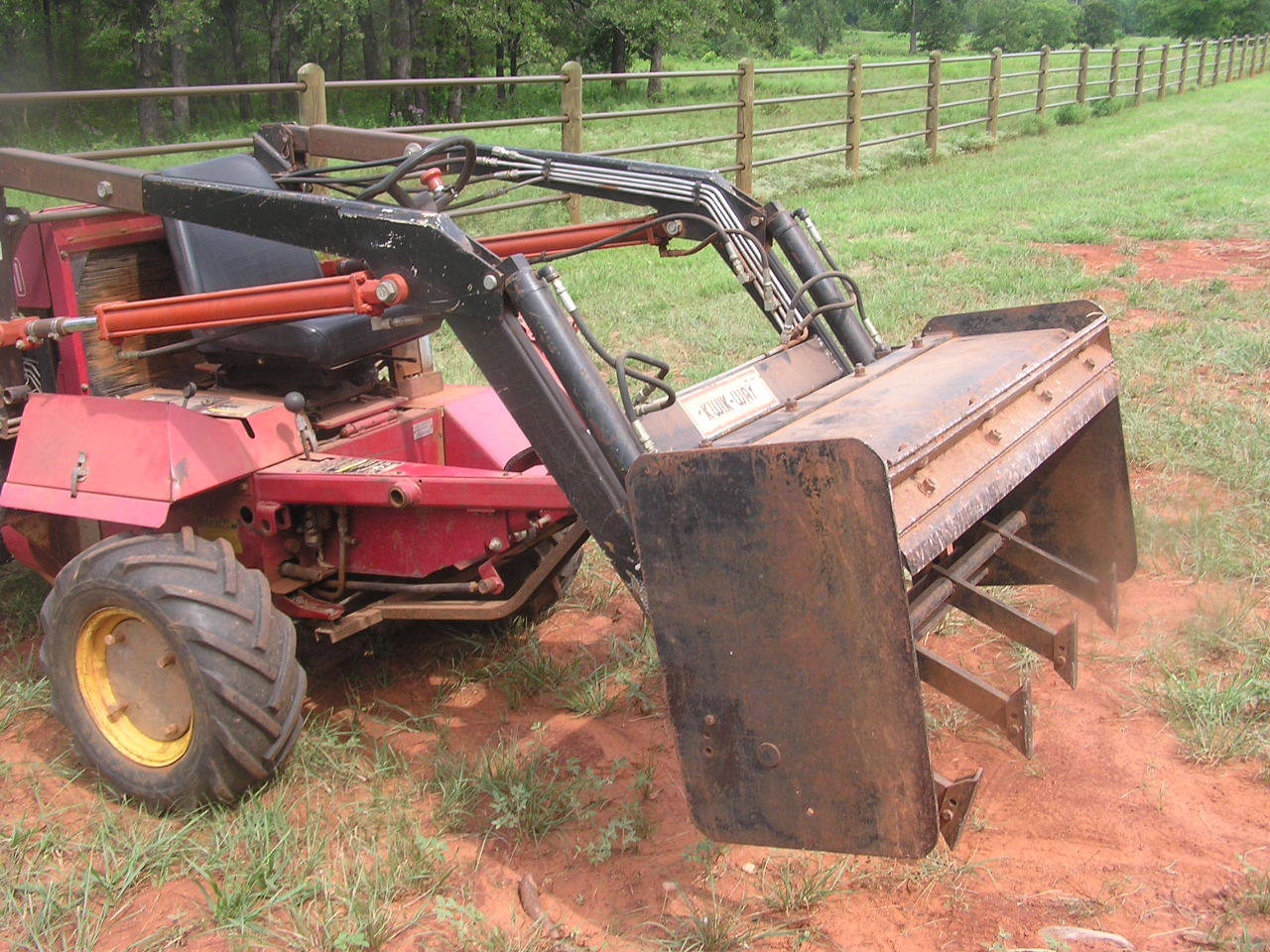

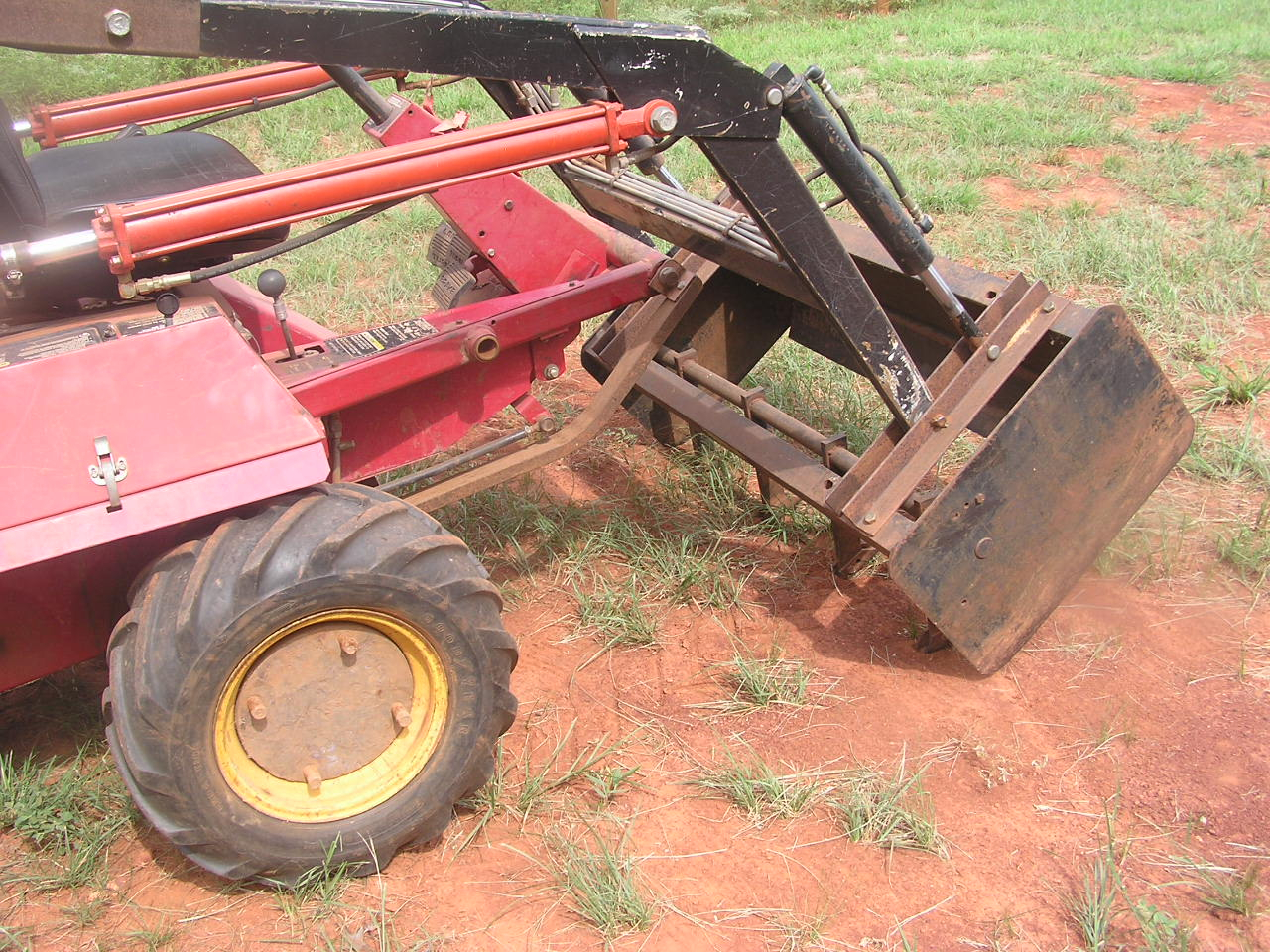

Well if we are going to show ripper tilt, here is ripper tilt: :D
I use it tilted this way to scrape dirt off of the roots on pushed over trees:

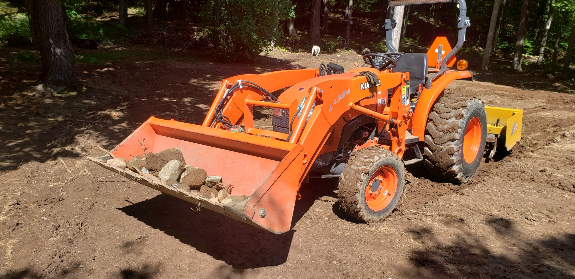

Used my box blade tilted all the way forward to pull up some roots today (no pics..). When im intentionally trying to pull up something (not just running into something i didn't know was there) i'm usually going at it with the center ripper only, maybe 2 rippers if the thing is that wide. On my little tractor it's no issue to pull as hard as i can on even just one ripper as ill spin 3 tires (4wd + diff lock) or maybe even 4 and nothing bends or breaks. I definitely don't make a habit of 'running starts' with the box blade, although I will do that when pulling off the rear 'drawbar' to yank up bushes/shrubs etc.
One person mentioned it already but another great benefit of being able to angle the box blade is being able to angle it back and just drag material without doing much damage to what you're driving over. With the box blade tipped all the way back and lifted maybe ~1/2" off the ground, you can keep 99% of the material from falling out of the box and not even scrape off the grass you're dragging it over. Lay it over real bad, sure.. :sneaky: It also helps when pushing backwards with the rear blade in about the same way. Shave flat, cut down, or just float while pushing a pile.
I like the idea of adding another hole to the top of the implement to change how the existing top link can angle it. Cheap and semi-easy. The PATS is not cheap, but definitely easy!
