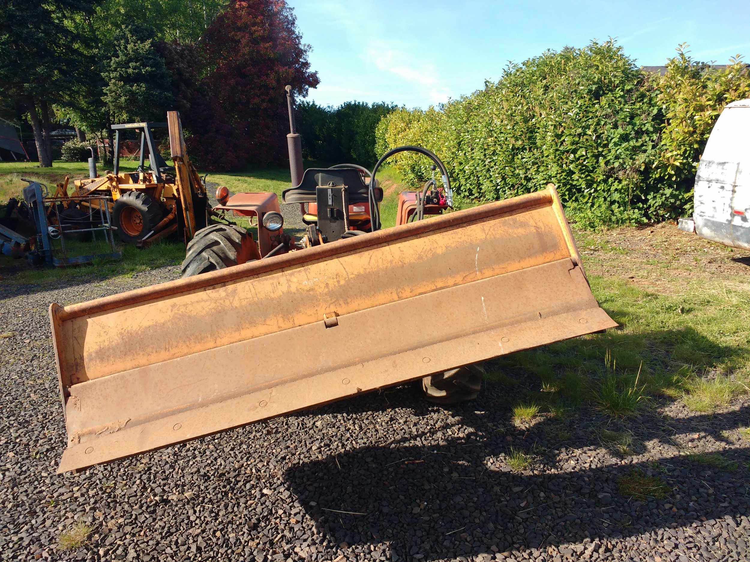

My ancient Gannon box (80" wide, right at 1000#) has hinged (but lockable) rear blade and hydraulic rippers - there are really only two positions, up or down. Down has an "over center" linkage so they stay put, the hydraulic cylinder releases the over center and they raise up a little above horizontal.
Down position is pretty much with shanks vertical and teeth slightly forward - this is with the box level.
When I bought mine the end pieces were severely worn and the rippers were missing. I bought new rippers and I added side pieces to bring the bottom edges back to level.
Most of my 10 acres is at a fairly good slope, so one of the first things I did was to do a "push-out" (technically a "push/pull" out), using the loader on the front of my old 580B and replacing the hoe with the factory 3ph to run the box.
This was in fairly heavy clay soil in early summer, so the soil still mostly acted like dirt instead of rock - I would drop the rippers (with one finger :=) make 3-4 passes sidehill, raise the rippers (same finger:=) then start at the upper side, drive the bucket into the loose dirt, bucket curled back and raised about a foot, then drop the box and let it fill, drive about 100 feet, dump the bucket and drive over the loose dirt, then as the front tires came down to original grade pop the box up -
Drive around one end of the area and back to top, repeat til there's no more loose dirt, then rippers down, rinse/lather/repeat...
That method got me nearly a full acre of flat level ground - did that in a 3 day weekend, estimate I moved roughly 900 cubic YARDS of material (1 yard front bucket, nearly a yard in the box)

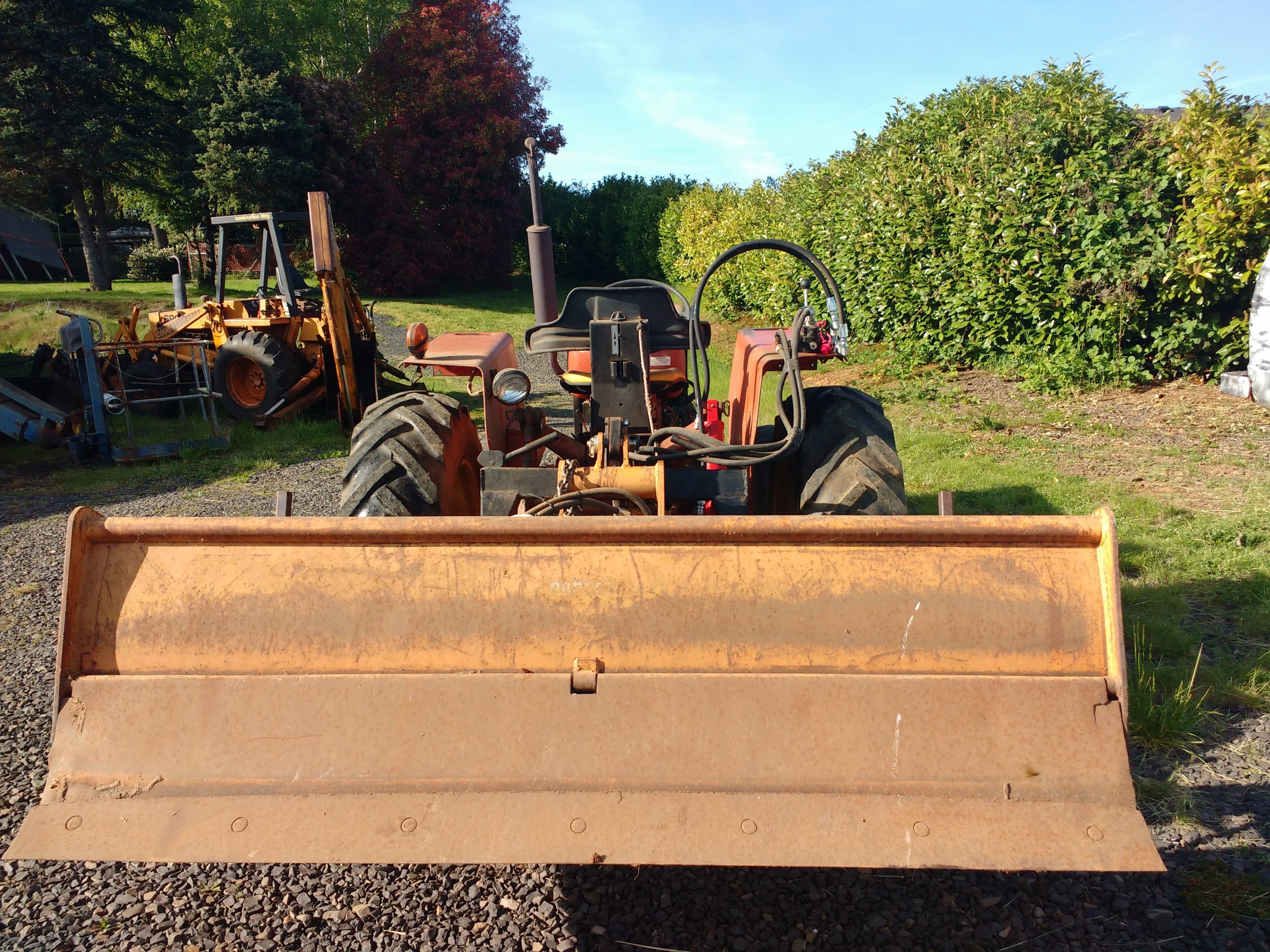

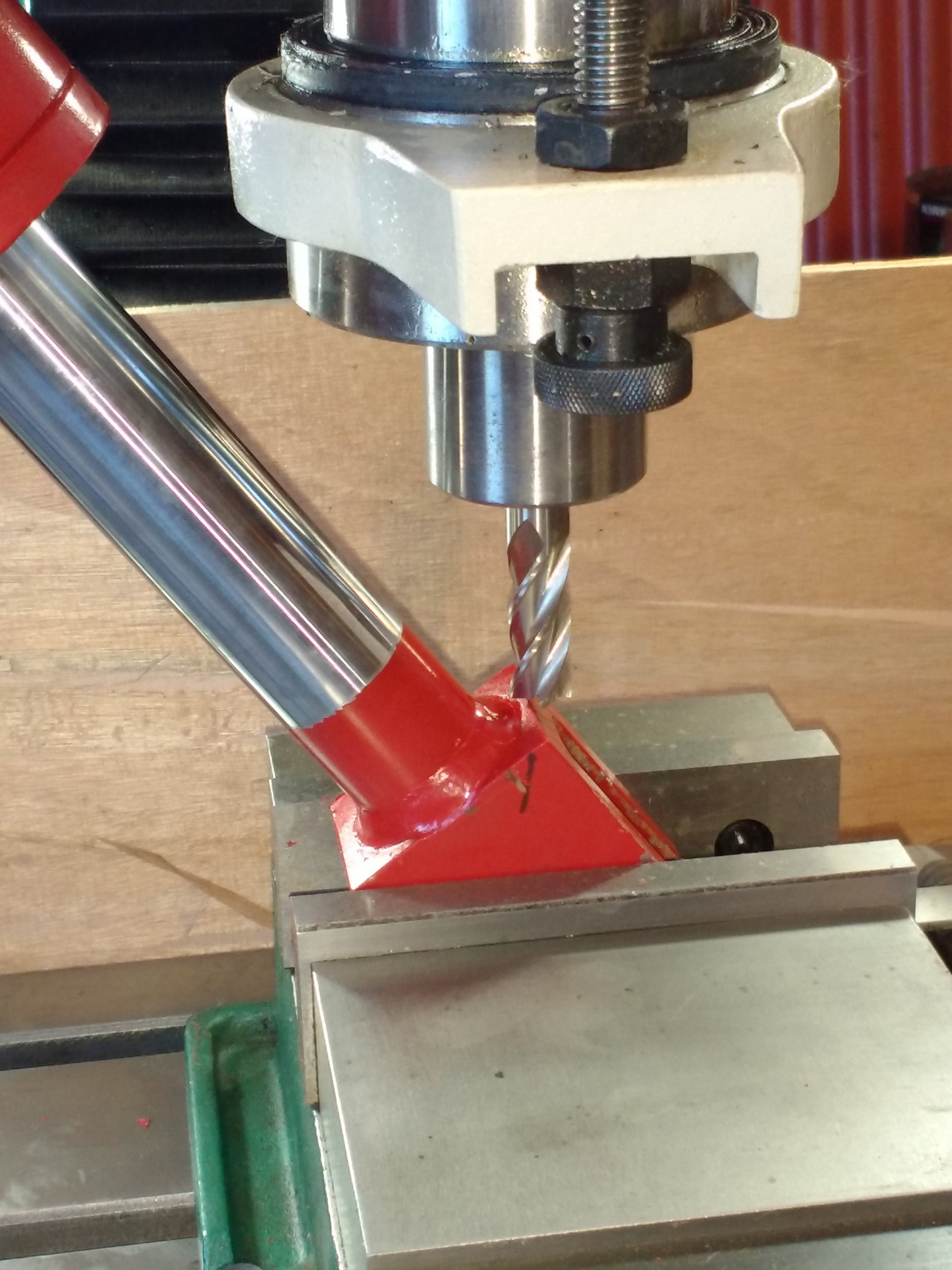

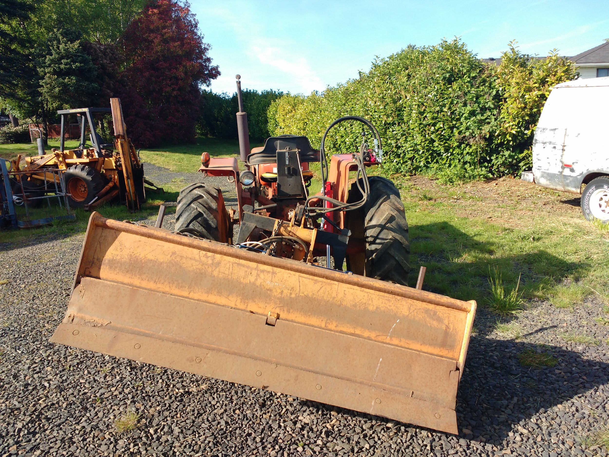

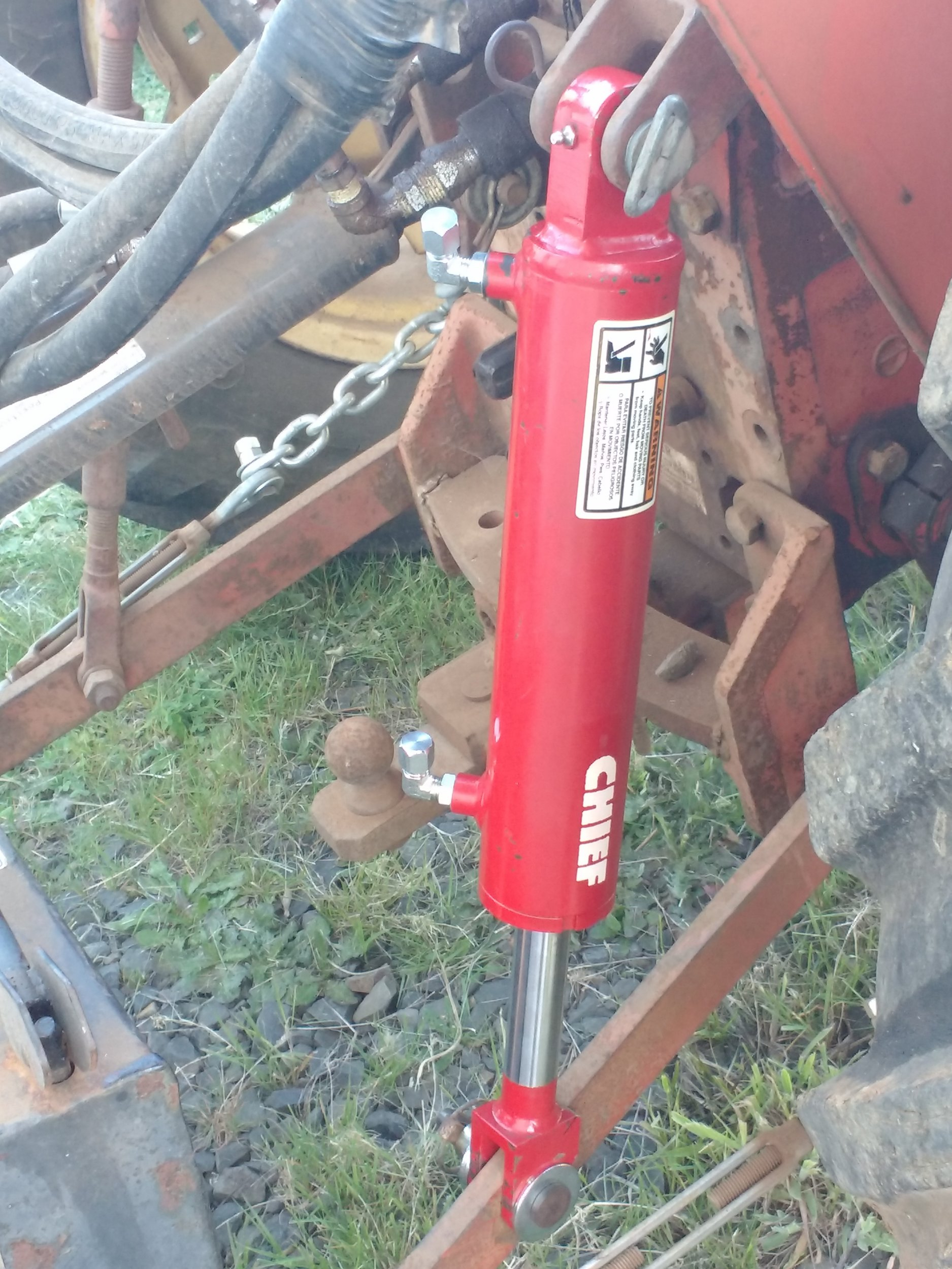

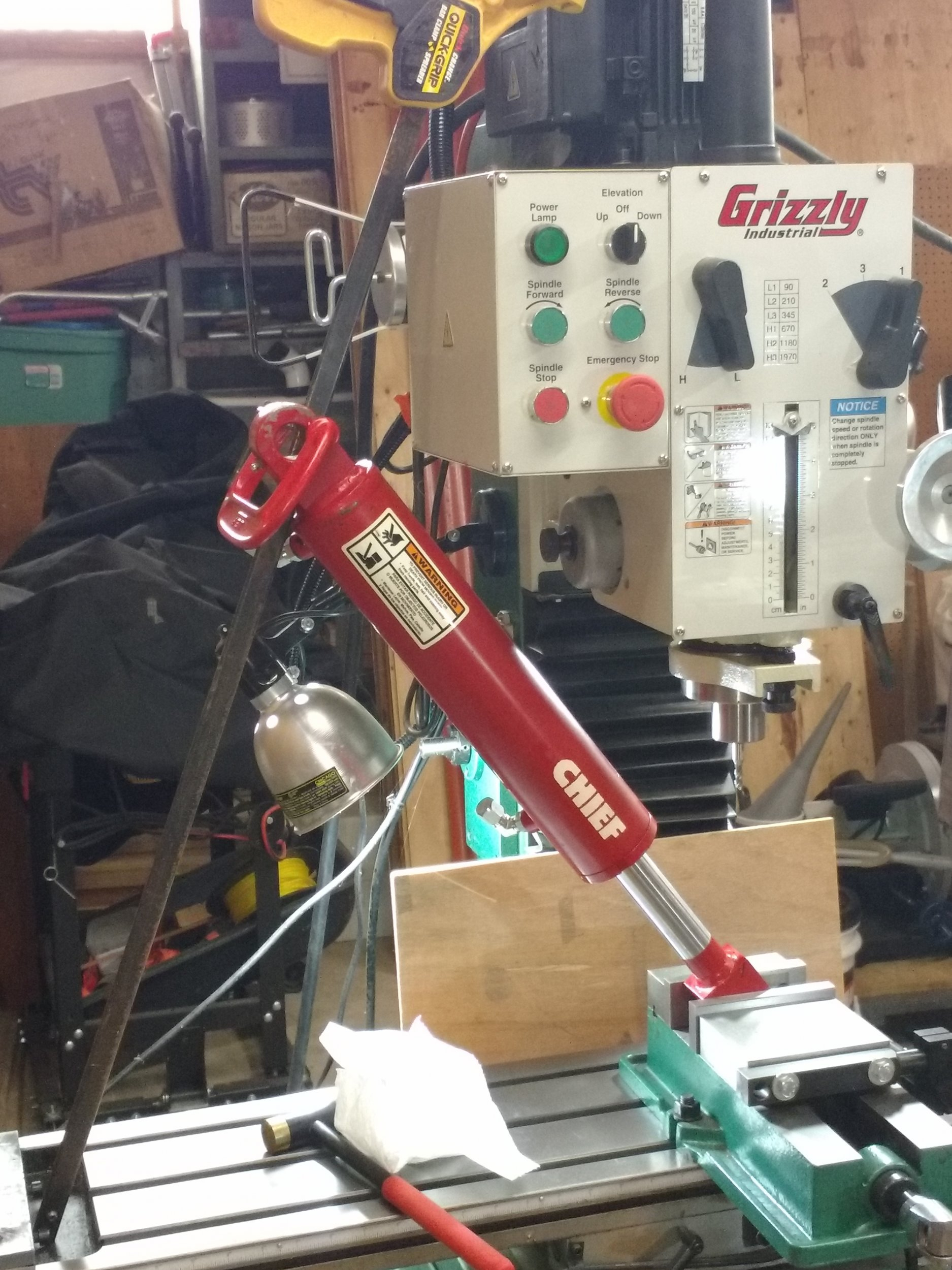

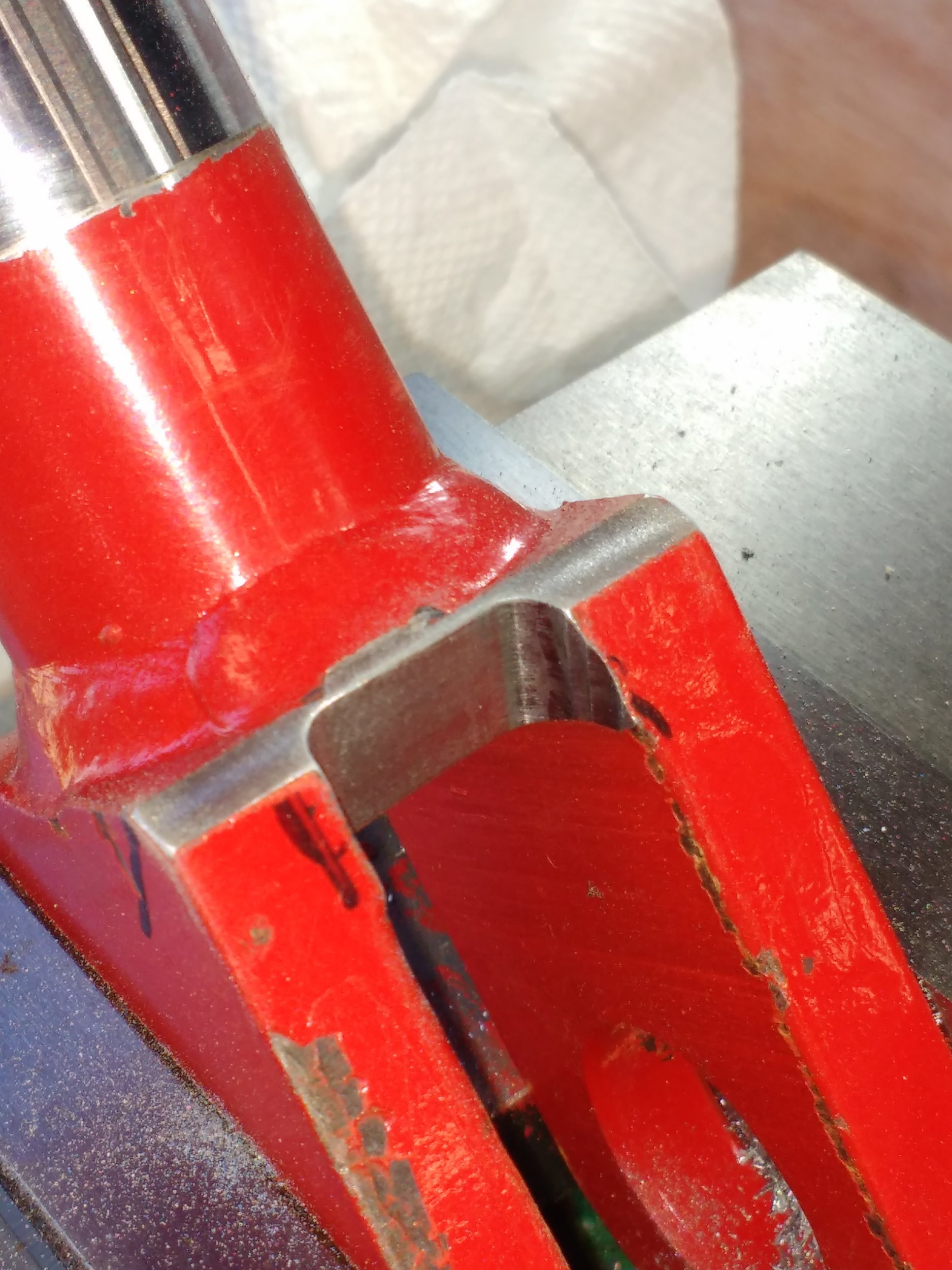

That was BEFORE I got tired of switching the backhoe with the 3ph (can't do that with Case hoes newer than mine) and bought another tractor - I got kinda spoiled with the Case 3ph attachment, it had top/tilt, float AND power down right from the factory - took me awhile, but I added top and tilt to my old Allis 160 - bought the toplink and did my own side link, lucked out (surplus center) and found a cylinder with 10" stroke that only needed a bit of machine work instead of replacing the lower yoke -
The longer stroke on tilt lets me have nearly 2 FEET of range from hard left to hard right. Now all I need is to finish rebuild of the ripper cylinder and add another diverter to the allis :unsure: ... Steve

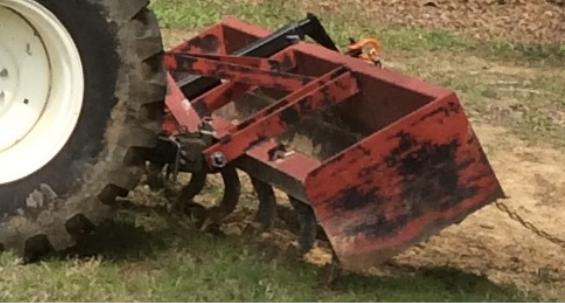

Take a look at pictures of new Rhino BX60 box blades and you will see that the sides are square. What you have is a very worn box blade that has been used for too long tilted forward.
Nope, it's an older model made 30 years ago and the edges are cut, not worn.
