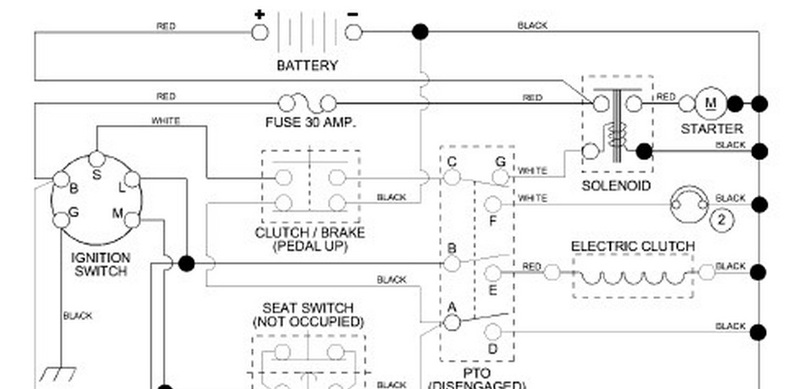

I just had my original motor replaced, a kawasaki 19 hsp, with a 21 hsp. Briggs,OHV. It worked fine for a while but I cannot figure out what is happenig, Something is pulling new batteries down and causing clutch to stall . I replaced battery twice within a month and works for a mowing or two then back to dead battery and stalling clutch.I had a part time small engine guy do the exchange for me and it seems that maybe he didn't wire it correctly I just need a simple wiring solution to go by. there ar too many loose wires from original motor. This motor is mounted on a Tank M48 mower. Can I get some help from some of you knowlegable machanic.
Thanks in avance.

You need to separate this into one or the other problem:
1. Is it charging while running? Check the battery voltage with engine running at full throttle for at least 10 minutes. It must be above 13.5 volts, and 13.8 or higher would better. If so the battery is charging ok. If the voltage is low the electric clutch may not have enough power to operate.
2. Is the battery being discharged while the engine is not running? With the engine off and all devices (clutch,lights, etc.) off disconnect the negative terminal of the battery and measure the current being drawn between the negative battery terminal and the lead you just disconnected.. Be careful and read your owner's meter's manual about measuring current. It is easy to damage the meter. Get help if you are in doubt. The current should be less than 10 milliamperes. Less than one is better.

Thanks guys, I have checked the battery with engine off and getting 12.26 volts. I have not jumped it off to test while running. I have traced wires through the harnest and find only one fuse, and that fuse has 25 amp in it, not broke, however, one wire to fuse holder is diconected and I have no idea where it would connect. where the fuse is there is nothing (no wires) going out from fuse. I touched the diconnected wire to hot post of solenoid and turned key and got clicks from battery so it appears to be hot. it did not blow the fuse. I will check the battery while running and see voltage. I think i might need to just re-wire this thing, but Im not sure of what i need to hook up to get it to work.

If there is only one fuse in the harness, that is likely the fuse protecting the charging circuit. Probabally should be a wire from the engine harness feeding that fuse, and then back to battery. Could run through the keyswitch and then to battery.

One of the first place I would look is the regulator. A Kawasaki engine uses a different regulator than the Briggs. It sounds like the person that did the engine swap tried to use the Kawasaki wiring for the Briggs. I don't think this is going to work. I have attached two wiring diagrams for the 21 horsepower Briggs engine. Check the wiring on your system and see if it is close.

Thanks LD1, I connected the loose wire to the battery and it seemed to work fine, for about an hour, then the electric clutch just quit. i checked the volts on battery and it is down to 8.20. recharged battery, reading 13.80 volts, mowed for about 30 minutes and the same thing happened, clutch quit! Would it be possible the something wrong with the clutch? If so, how could i test it. I set the air gap to .10, but not sure if thats correct. This has a 21 hsp briggs so i dont know the correct air gap. I called a shop and he could not or would not tell me without taking it to him, and I'm sure for a service charge. Can I get some help?
