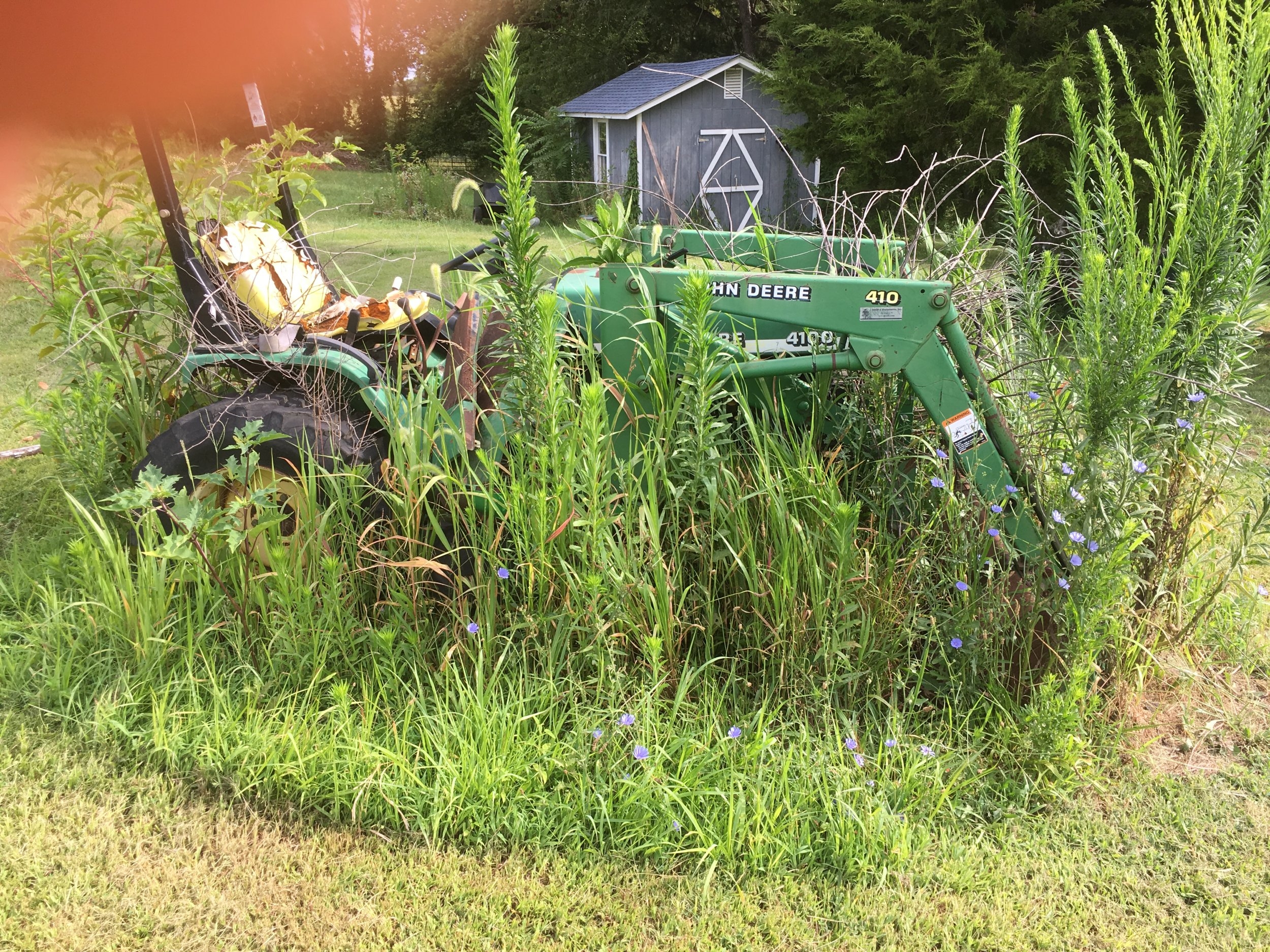

Sat in the open for 7 years. Drained the fuel, replaced the filter, new fuel and jumped battery off a pickup truck. Started on the third rollover. If the key switch doesn’t work, you may be able to bypass the key switch by jumping the starter at the solenoid. You will need to get the fuel shut off to open before starting. I don’t know how the Kioti‘s are set up for this. Do this just to see if the engine will run. I did that on a Kubota that had been sitting for several years. The new owner tried to start it but it did absolutely nothing when he turned the key. He was convinced the switch was bad. The owner acquired the tractor with the property and had no idea if it even ran. He was reserved on experimenting on parts so we jumped across the solenoid to start it. Key switch was good. It ended up being a bad safety switch. That particular tractor had 4 of them. Seat, clutch, pto and transmission. One bad safety switch will prevent the key start from working.
