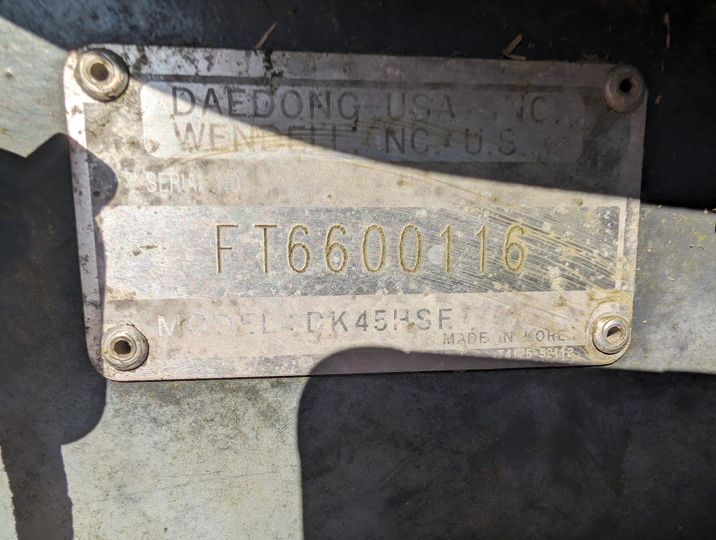

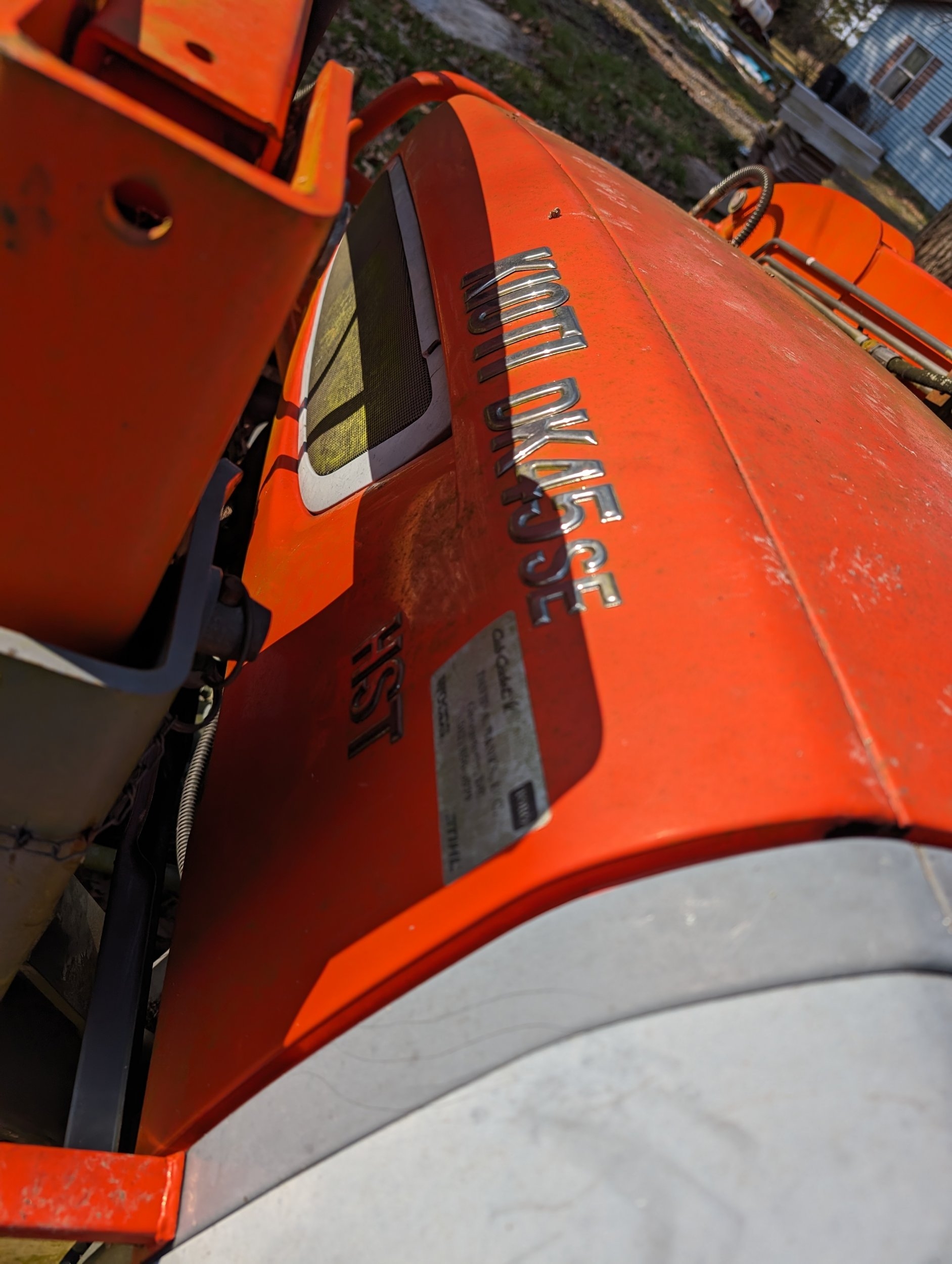

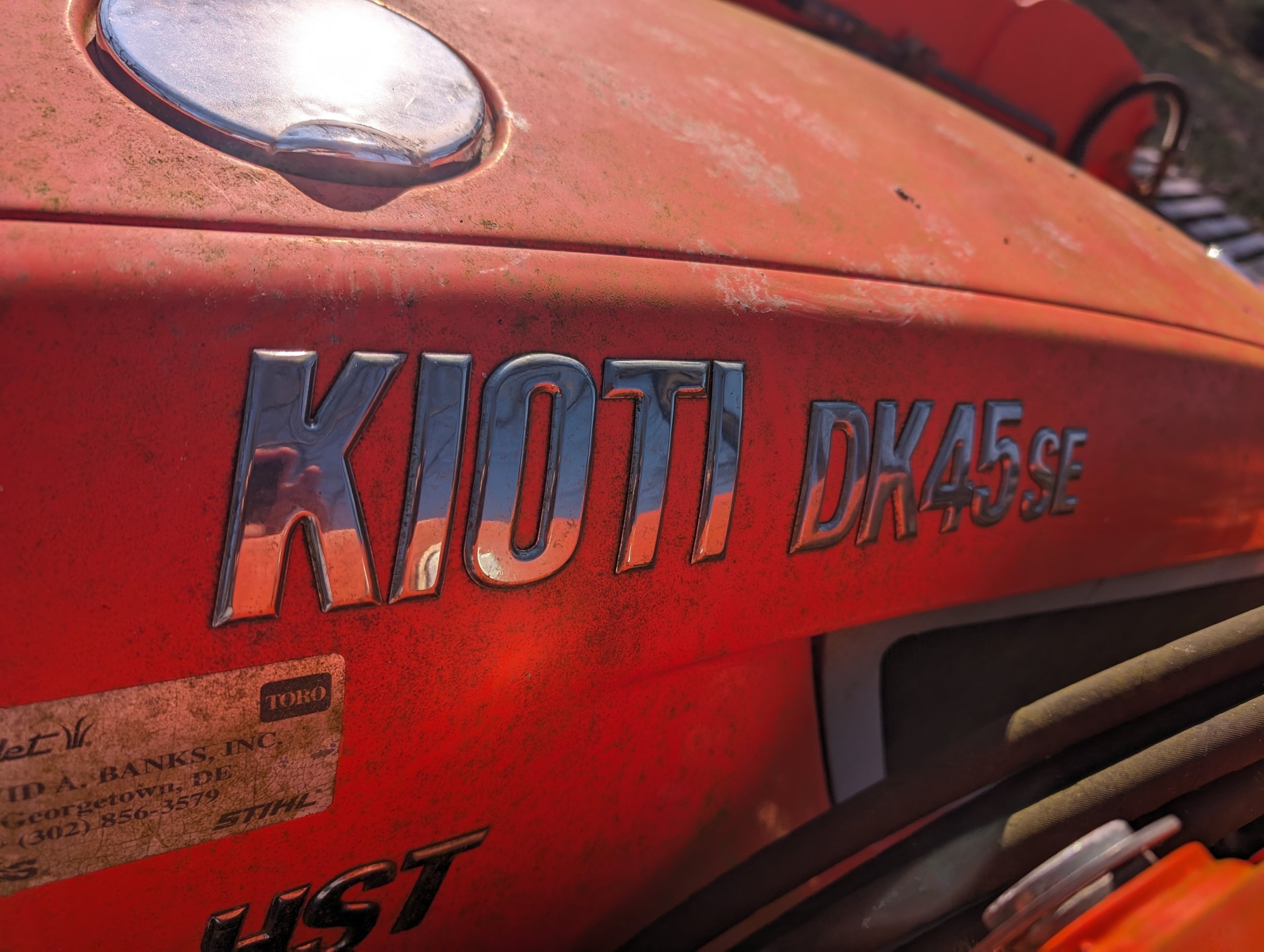

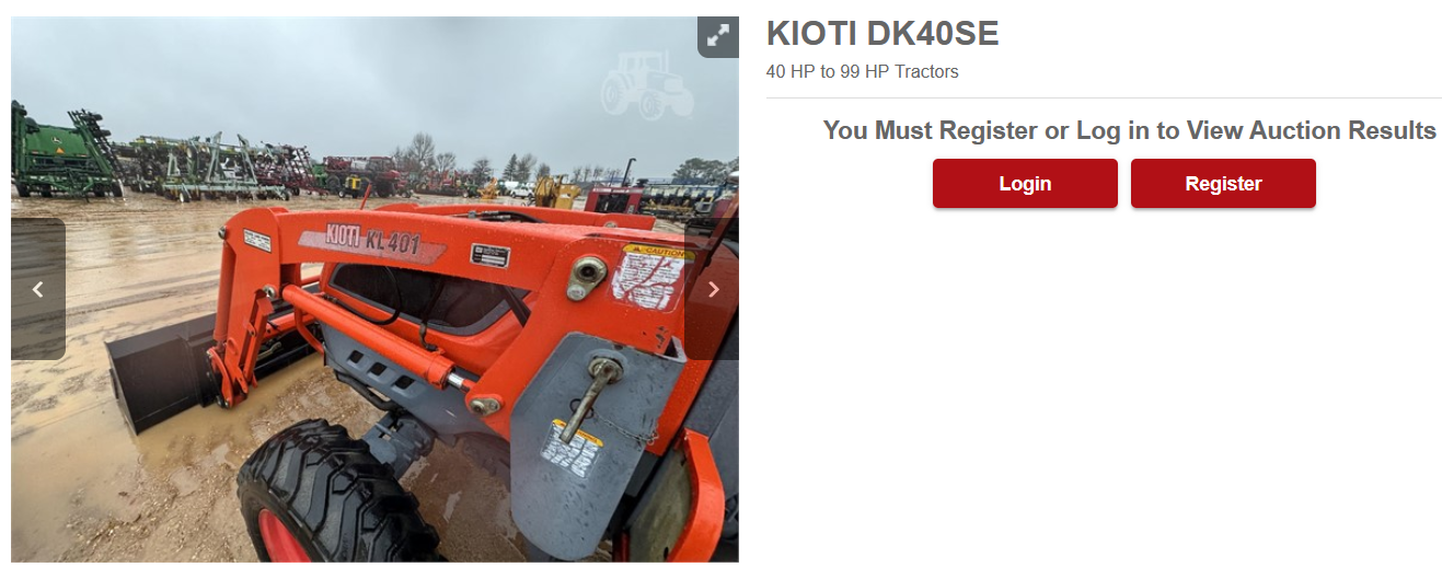

More likely about 10-12 years old. What a find
edit: Kioti manufactured DK45SE between 2007 and 2017.

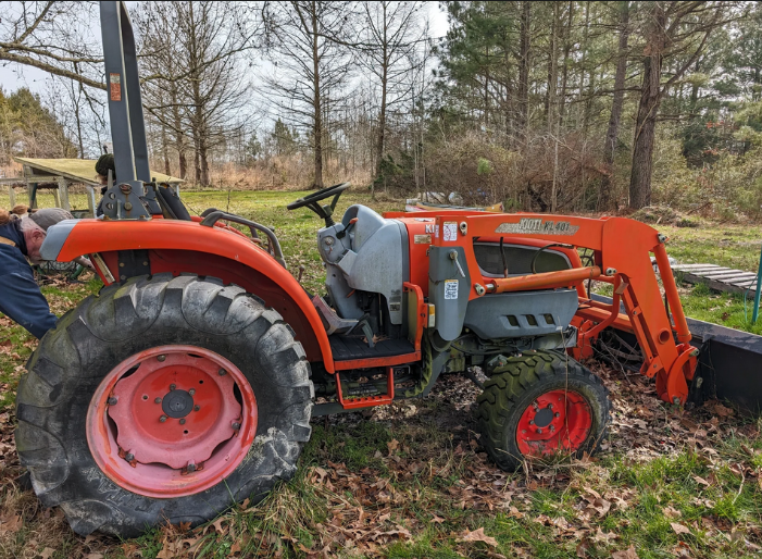

Other given great advice...lift front tires off the ground spin wheels by hand listen for any grinding sounds.

Great find. The serial # starts with F so it is a 2006 model year.

Yep, as others have said, Get some air in those tires, that alone will give you a sense of accomplishment ;- ). Take a good look-see at tractor for broken parts, -- lines, hoses, cracks, especially engine -- no holes in block? Radiator holding coolant? Check tans fluid level. Then Fuel and engine oil -- drain fuel tank and replace filter (filters?) -- check that manual -- run some fresh fuel through tank while lines are open to flush it out. Fresh engine oil and filter, take a good look at old oil for metal shavings. If everything is looking good, put your battery in and give it several shorts cranks to get things loosened up and oil circulating, and give it another once over, if all is ok, then actually try to start it. Hopefully all goes good and she starts and runs. Then you can go through and change out the rest, trans fluid, hydraulic fluid, coolant, ETC. You got a nice tractor there, good luck with it.

Air in the tires. They probably also have a liquid in the tires which is normal/desired. Watch for leaks at the valve stem which can often be repaired easily.
Some tractors have all ignition functions in the key. Others only start with the key, and have a kill switch. And some even have a kill switch and a crank switch separate from the key.
Anyway, many tractors are extremely easy to hot wire while you're waiting for a new switch to come.

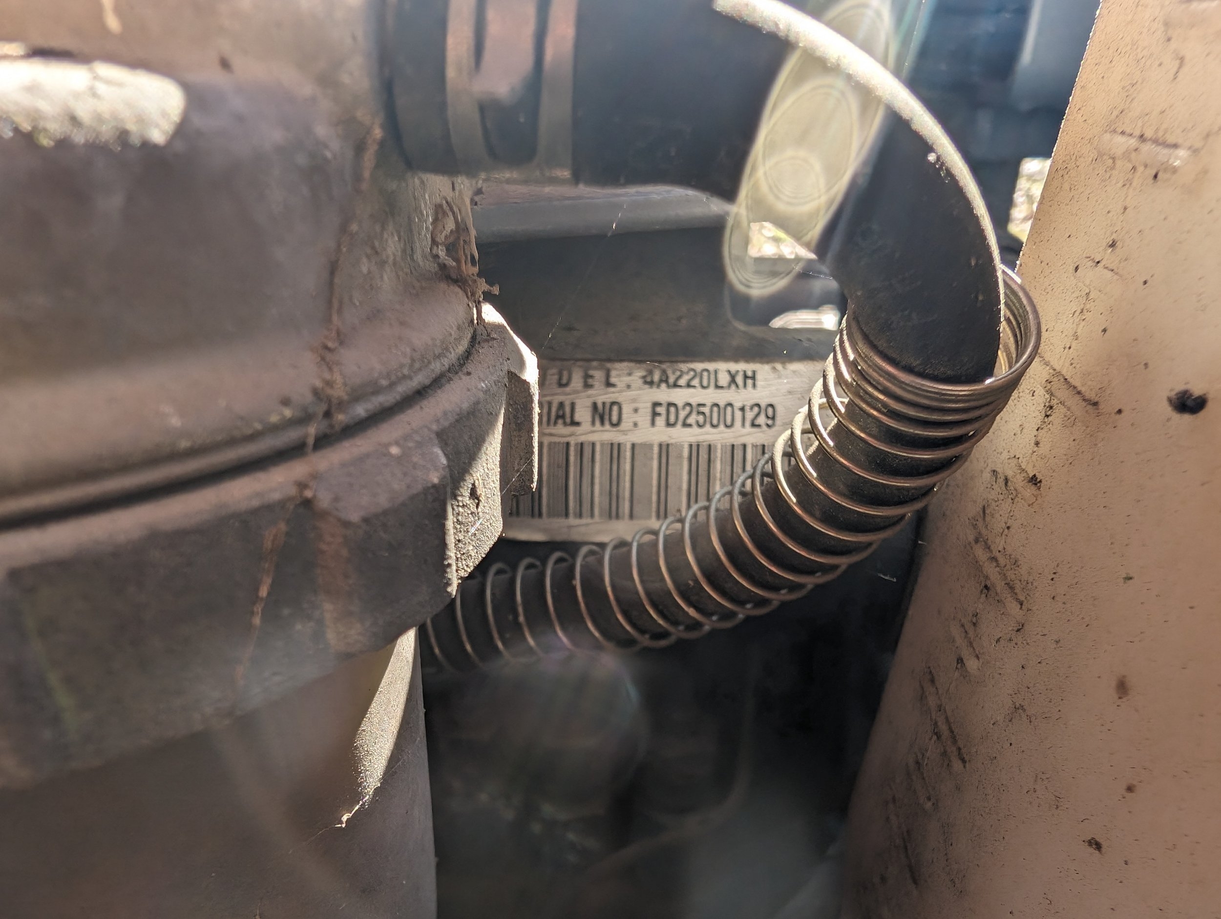

Isn’t that the series that has the brittle gears in the inj pump that break in the s/o position..??

Hey team, this is my first post here. I hope I can get some illuminating responses. My in-laws have a Kioti KL401 (is that the real model# or is that just the loader) that's been sitting quite a while. I told them I'd take it off their hands and they said OK. I can't
Vehicle Hood Motor vehicle Automotive lighting Automotive tire
Wood Motor vehicle Font Bumper Gas
seem to find the year of manufacture by searching on the Internet and was wondering if anyone had a resource. I figure that's a big part of finding parts and equipment. I'm pretty sure it's 20+ years old. They said the ignition switch had gone up so I figured I'll replace it, get a new battery and change oil and filter (twice). Diesel in there is maybe still good? I'm assuming the hydraulics need some love but don't know where to begin. Needs a seat. Tire on the back obviously needs help.
I'm mechanical. Work on cars etc, just don't know much about tractors. Any help is greatly appreciated. Thank you!
that is the loader #
