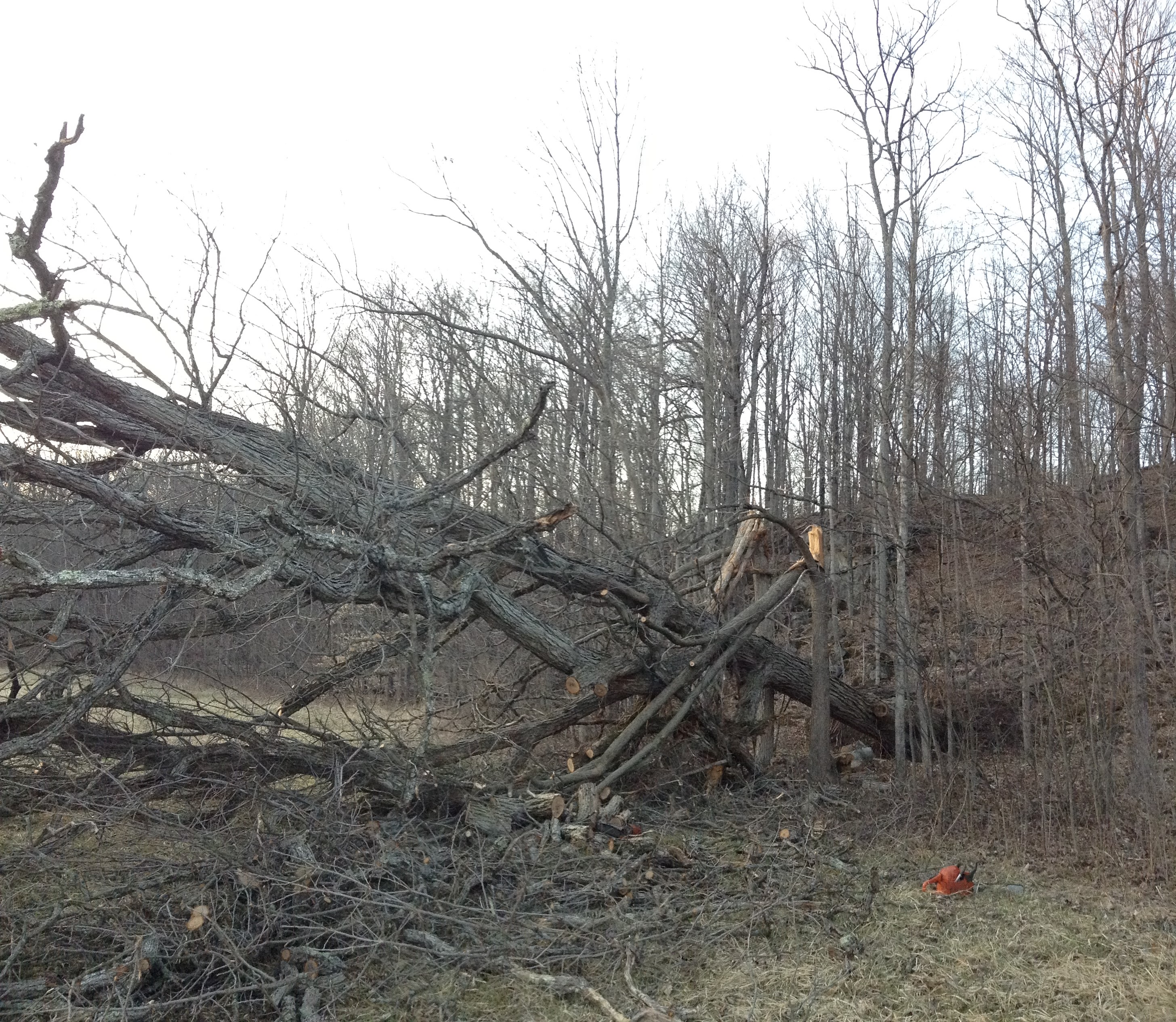

What's the biggest bar that I can (should) put on a 57cc saw (for just a few cuts on one big tree)?
I've ran a firewood saws for about 20+ years and have had no problem running a Husky 55 (53cc) with a 16" bar. My other "big" (not really, but bigger) saw is a Husky 257 (57 cc, 3.6hp (2.7kW)) with a 16" (but maybe a 18") bar.
97% of my use is limbing/firewood, so I don't mind those rare occasions when I have a few cuts on the rare big trunk where you might have to hit it from two sides to get through it with a 16" bar. For me I'd rather run a lighter saw all day when you don't really need that big saw horsepower for 95% of the cuts.
I say this because despite all the suggestions I'll get to go spend $800+ on a professional grade saw that weighs 1/2 ton, I don't want one!
A pretty big tree (elm?) fell over in the field, and from the way it sets, I'm thinking I want a (temporary) bigger/biggest bar on the 57cc to make those ~1/2 dozen cuts on the trunk.
Husky says the biggest you should put on the 57cc (and 53cc no matter what size chain pitch?) is 20". In reality, could I go bigger (24") and just baby it? I really want "reach", not horsepower and speed.
Anybody have any insight, experience or suggestions?
(Other than buy a bigger saw :rolleyes:)

Oh yeah it is. Slow and steady with this one. Getting her down the rest of the way is the most tricky part. The trunk is still a good 14"-16" thick at about 15' above ground. (That's the problem when it falls on the branch heavy field side). Cutting the big trunk is my secondary problem. Think twice, cut once, cause it plays for keeps.

my two cents. I dunno your expertise but I know mine. This larger diameter tree is in an unpleasant position. Bucking timber in unsafe circumstances is best done with all the power and bar you can have. That said, you don't wanna be hugging that tree with your body close by. That is why bigass saws and bars allow you to use the tip to finish it off and give you distance that you need from the danger area. On another note, I don't like one poster's homemade bar. If you aren't familiar and Comfortable with a larger saw, let some one else do'er. Above all, boots, chaps, gloves, helmet and glasses. Self preservation is the key to bucking timber when ever and wherever. Big saws and full skip chains are a different league.

Provide a few more pics and we will walk you through the process.
my two cents. I dunno your expertise but I know mine. This larger diameter tree is in an unpleasant position. <snip>

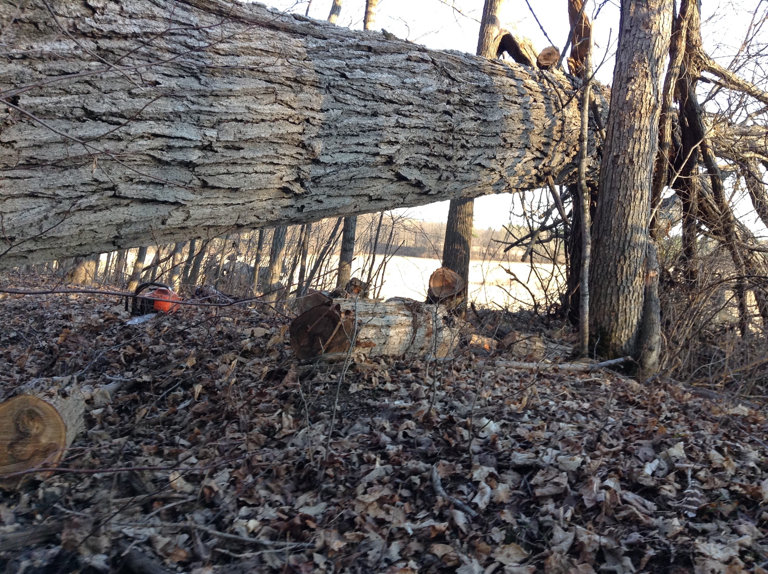

From the one picture it looks like the tree is wedged about 3 foot off the ground.
I'd start at the top and carefully trim it back in manageable pieces, probably with a mid size saw like you have.

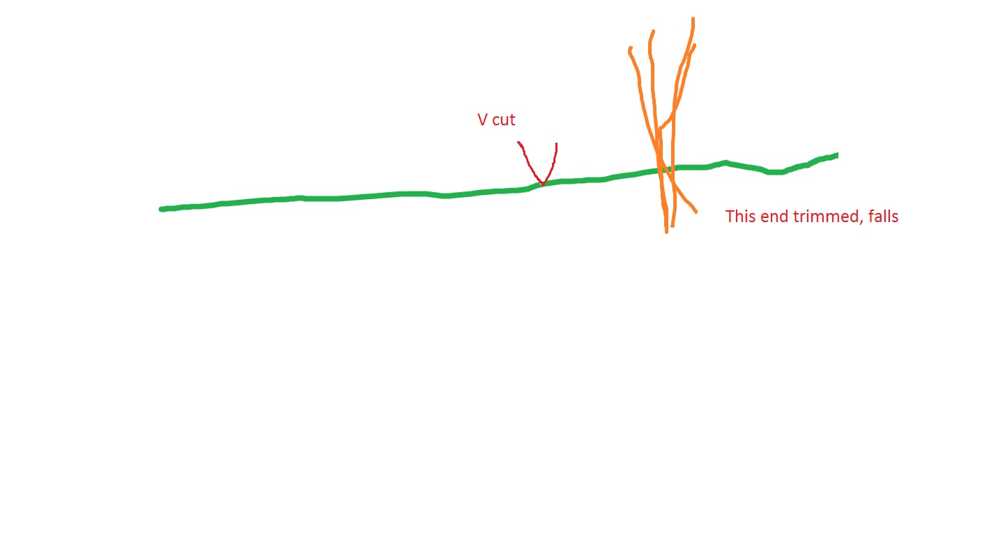

If I wanted to be fancy I'd leave the main trunk hanging beyond the wedge point to provide balance.
Then I'd come back on this side of the wedge point a distance so I thought from where I cut to the wedge point would be about the same weight that I left hanging.
I'd then carefully cut a wide V notch in the trunk on the stump side of the wedge.
The object it to get the front to tip forward and the rear to drop.
/edit - I missed post#10 - for that I'd throw a chain over as high as possible and try to alternate tugging it with my tractor and cutting limbs, whittling it down.
   / Chainsaw versus max. bar length? #16
One approach may be to nibble away and remove all the branch debri that is not supporting the main truck.
If a tractor or similar equipment is available try and pull the trunk around and get it on the ground. If not start near the base and as far away from the supporting trees by making a bottom notch and then finishing with a top notch. ??
   / Chainsaw versus max. bar length? #17
He said the tree is about 6" off the ground. Presumably the other side is touching the ground. I'd cut the other side free from the root ball and attempt to pull it and make it fall.
