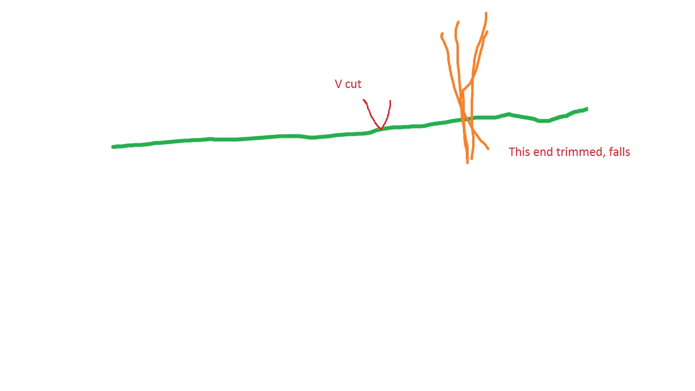

What's the biggest bar that I can (should) put on a 57cc saw (for just a few cuts on one big tree)?
I've ran a firewood saws for about 20+ years and have had no problem running a Husky 55 (53cc) with a 16" bar. My other "big" (not really, but bigger) saw is a Husky 257 (57 cc, 3.6hp (2.7kW)) with a 16" (but maybe a 18") bar.
97% of my use is limbing/firewood, so I don't mind those rare occasions when I have a few cuts on the rare big trunk where you might have to hit it from two sides to get through it with a 16" bar. For me I'd rather run a lighter saw all day when you don't really need that big saw horsepower for 95% of the cuts.
I say this because despite all the suggestions I'll get to go spend $800+ on a professional grade saw that weighs 1/2 ton, I don't want one!
A pretty big tree (elm?) fell over in the field, and from the way it sets, I'm thinking I want a (temporary) bigger/biggest bar on the 57cc to make those ~1/2 dozen cuts on the trunk.
Husky says the biggest you should put on the 57cc (and 53cc no matter what size chain pitch?) is 20". In reality, could I go bigger (24") and just baby it? I really want "reach", not horsepower and speed.
Anybody have any insight, experience or suggestions?
(Other than buy a bigger saw :rolleyes:)

I'd get some support under that thing before I started sawing on it but I don't do that kind of thing every day either. Be careful.

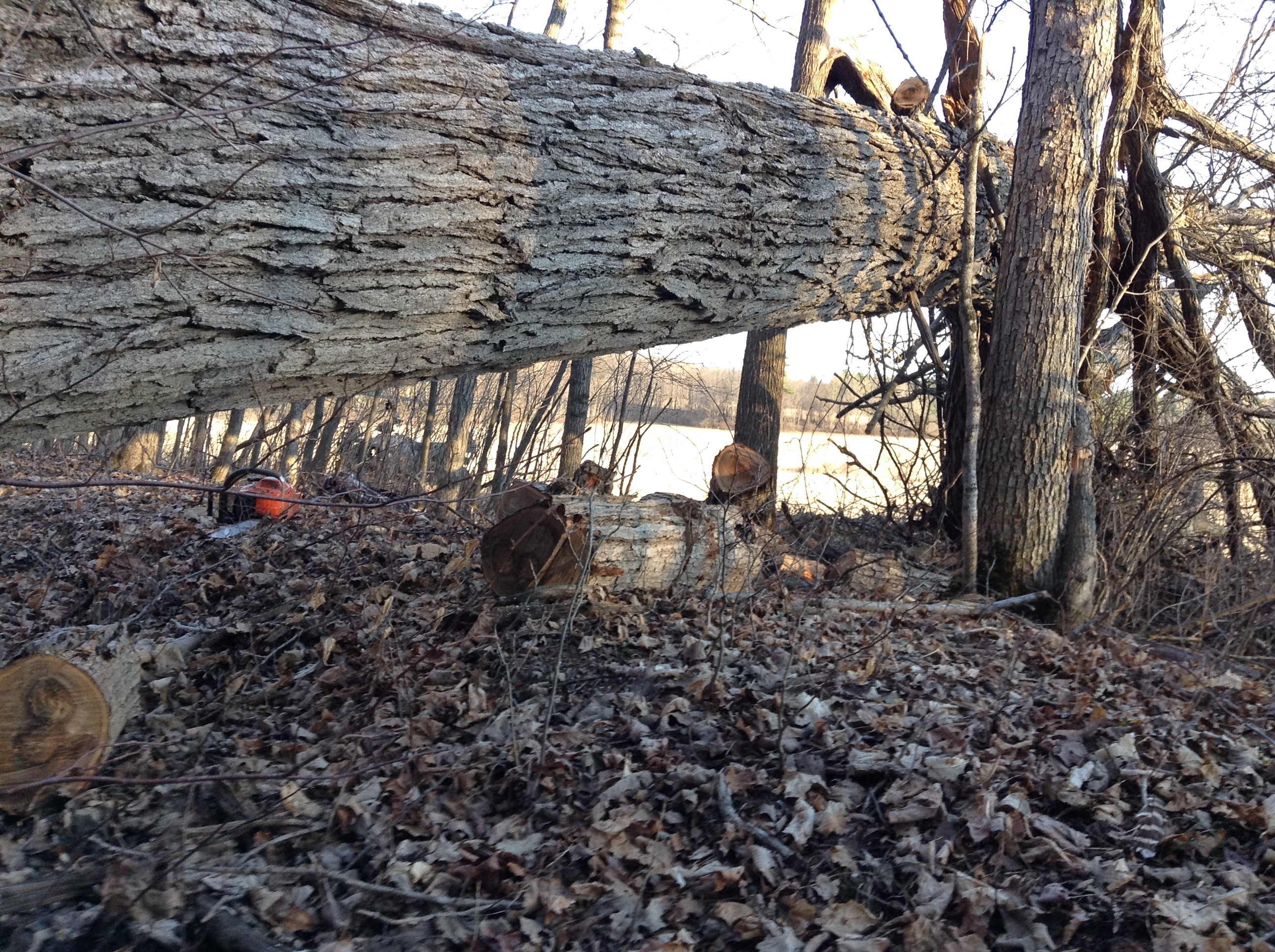

:thumbsup: I put a 28" (gulp) and a standard spaced toothed chain (skip tooth wasn't immediately available, (I'm not the most patient guy when I want to get things done). Even with that setup, the 57cc saw worked fine. ( Yes I know, a new $800-$900 saw for these dozen cuts would of worked better!)
Good point about the oiler, which I should of investigated more beforehand. I could tell the chain was running too dry for my taste. So on that first day, I just stopped very often to feel the bar and make sure it wasn't overheating, and (lightly) rev it a few times under no load to get some oil on it and repeat. If I'd had the manual on me or more experience I would of seen how easy it is to adjust the oil flow with the only tool I had on me (The chainsaw "skrench" tool?)
I started on the top end of the tree and spent one afternoon just cutting the tops with my 18" saw. Some of those branches were under a lot of pressure, but thinking ahead and using wedges did the job. Only got the saw pinched once (stupid mistake, aren't they all), but the wedges easily got her out, and I used them religiously afterwards. I only had one "Oh-sh*t! Run!!" moment, which wasn't really that bad when she popped and snapped and the trunk dropped about 2 feet.
The reason I started on the top end of the tree was because I figured that the root ball would keep it from rolling (on me!) when I was cutting off the limbs keeping it suspended in the air. That seemed to work well.
Glad to read you "got er' done" and kept your chain wet. Now you can justify getting a good 90 or 120CC saw FOR NEXT TIME.
