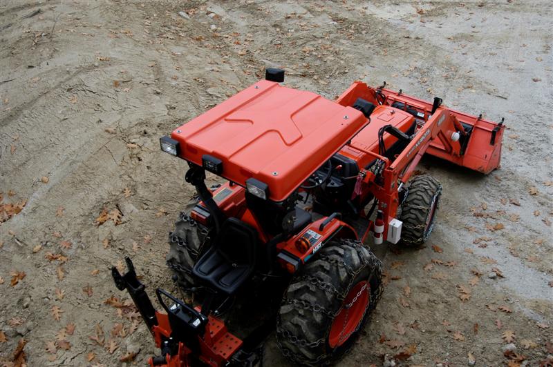

I have about 1000 feet of gravel driveway, part of which is pretty steep. I have plenty of room to push the snow so I decided to hold off on the snowblower purchase and use the back blade for now. I have read several postings about this method of snow management and to my surprise it worked well. Now granted, we only had a few inches so I will reserve final judgment till spring.
My problem started when I began to go up the hill with the rear blade down. The R4's began to loose grip and as soon as they started to spin, that was it. I backed down a few feet, lifted my blade and the same thing happened. I backed down further and started to slide a bit (pucker factor kicked in), I dropped the FEL and rear blade and came to a stop.
I like My R4's because they give me good traction in the woods and they do not rip my lawn to shreds even with 400 lbs of wheel weights installed. However, for snow removal, on my particular driveway, I do not think they are right tire for the job.
So now that I have decided to purchase chains, what has been peoples experience with them???? Particularly with the 1533 (any issues with clearances etc.) I do not have to worry about pavement or garage floors so I want to go with the ice pick type. I have been quoted anywhere from $550.00 - $750.00 a set. Any recommendations on manufacturer or distributors?? What should I be looking for in terms of specs etc.I'm sure there are better chains than others out there.

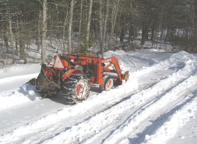

I just put chains on my R4s for this winter. I did some slipping last year but after seeing these rascals on my tires I think sliding is a thing of the past.
I don't know where in vermont you are but if you are in range take a ride to B&B chain in milford NH Top quality at a fair price and they can answer any question you have.

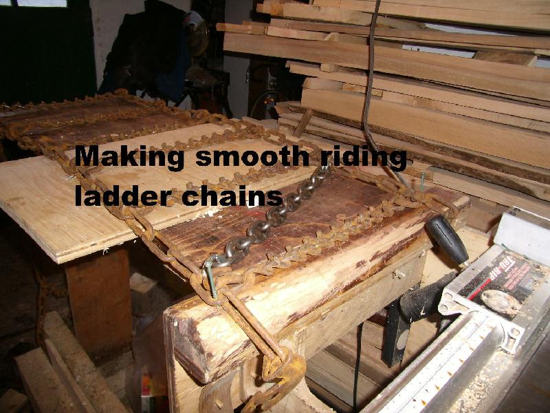

If you get ladder chains make sure they are the two link type otherwise you may have a rough ride.:D
I had 4 link ladder chains and ended up adding a trnverse link between the ladders. Surely helped the ride.:D
