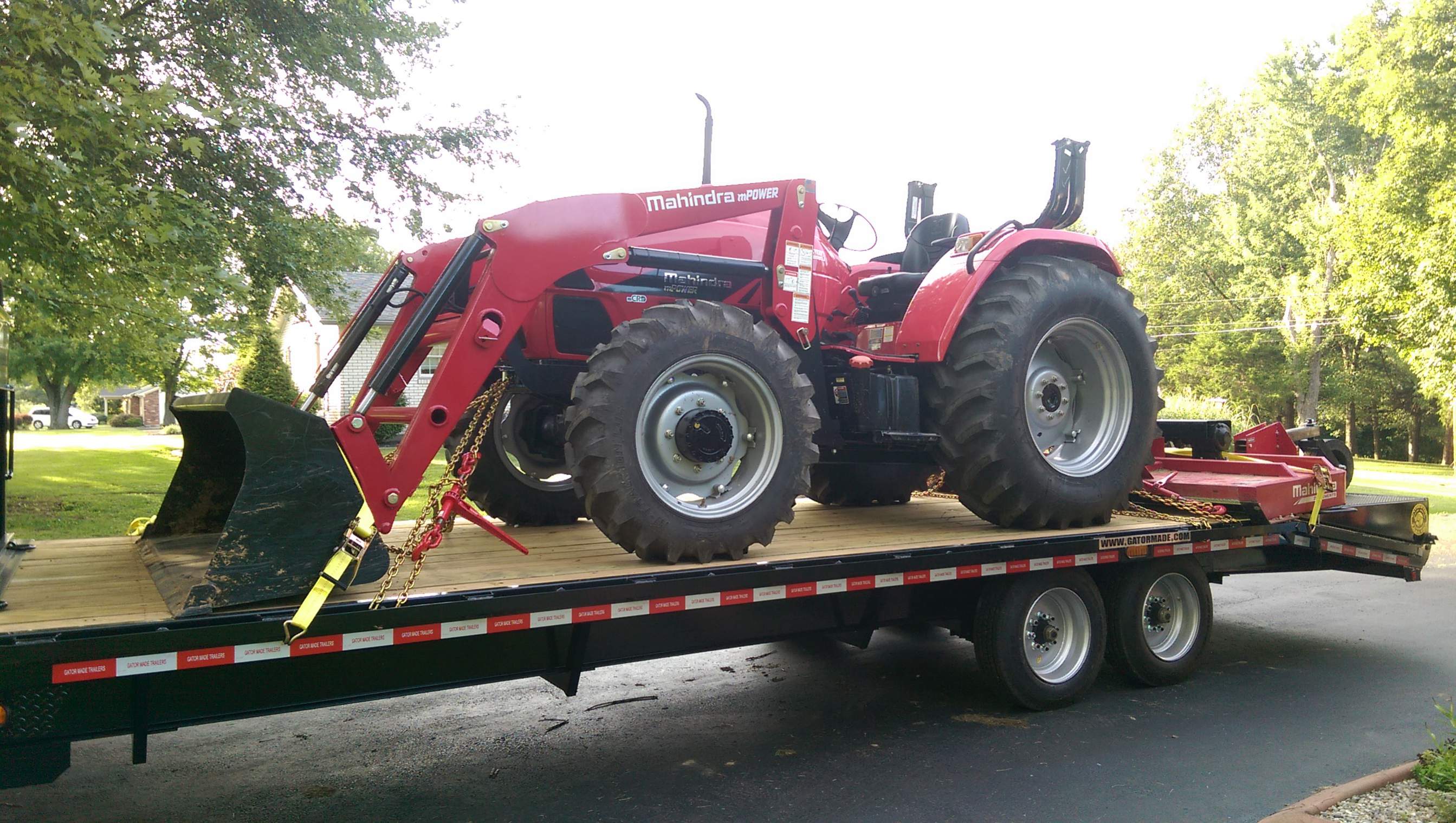

Looked at Harbor's website, found out there's one close to where I work that I knew nothing about...called them...seem to have everything in stock, headed there after work to purchase...thanks again everyone.
Check the web for a 20 or 25% discount coupon!! It'll help for the most expensive item.

ebay and amazon have good prices on chains and binders. much better than i found in my local lowes, tractor supply, and local hardware store.

The ratchet binders I bought from Harbor are rated 9,200...look well built.

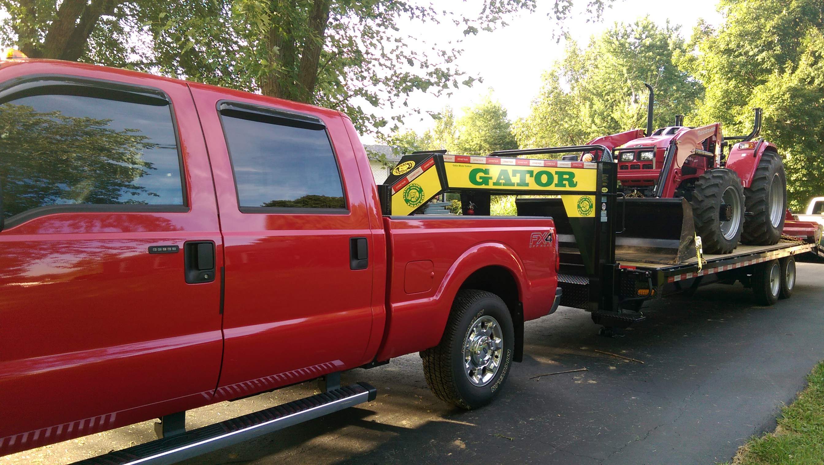

That is going to be a load on your truck. If it is diesel it might handle it, but that load would bring my gas F-350 to its knees. I wouldn't trust mine and other people's life to anything from harbor freight.

It didn't even kick out of 6th gear with the cruise set at 66 climbing a pretty big hill on I-65 south...of course it's diesel...gas model isn't equipped to haul 16,000 lbs.

440 HP and 860 FT/LB torque...no worries...brand new with a great warranty...lol

If I knew I was going this heavy on the tractor, I would have at least got a 350 DRW, but my dream truck which I hope to have when I retire in 7 years is a 450...then no worries for sure. :)
/ Chains, hooks, binders, straps 10,000lb+ load #30
Nice Trailer!
I don't like those style of straps but prefer the more rare ones with a length of chain and grab hook on the end. They loop nicely down and up through a pocket.
Funny how picky the authorities are about chain and straps but have no concern about what the chain is attached to.

/ Chains, hooks, binders, straps 10,000lb+ load #32
Nice Trailer!
Nice trailer AND nice truck.

Thanks everyone...very happy with both so far...first gooseneck trailer and first diesel truck.
