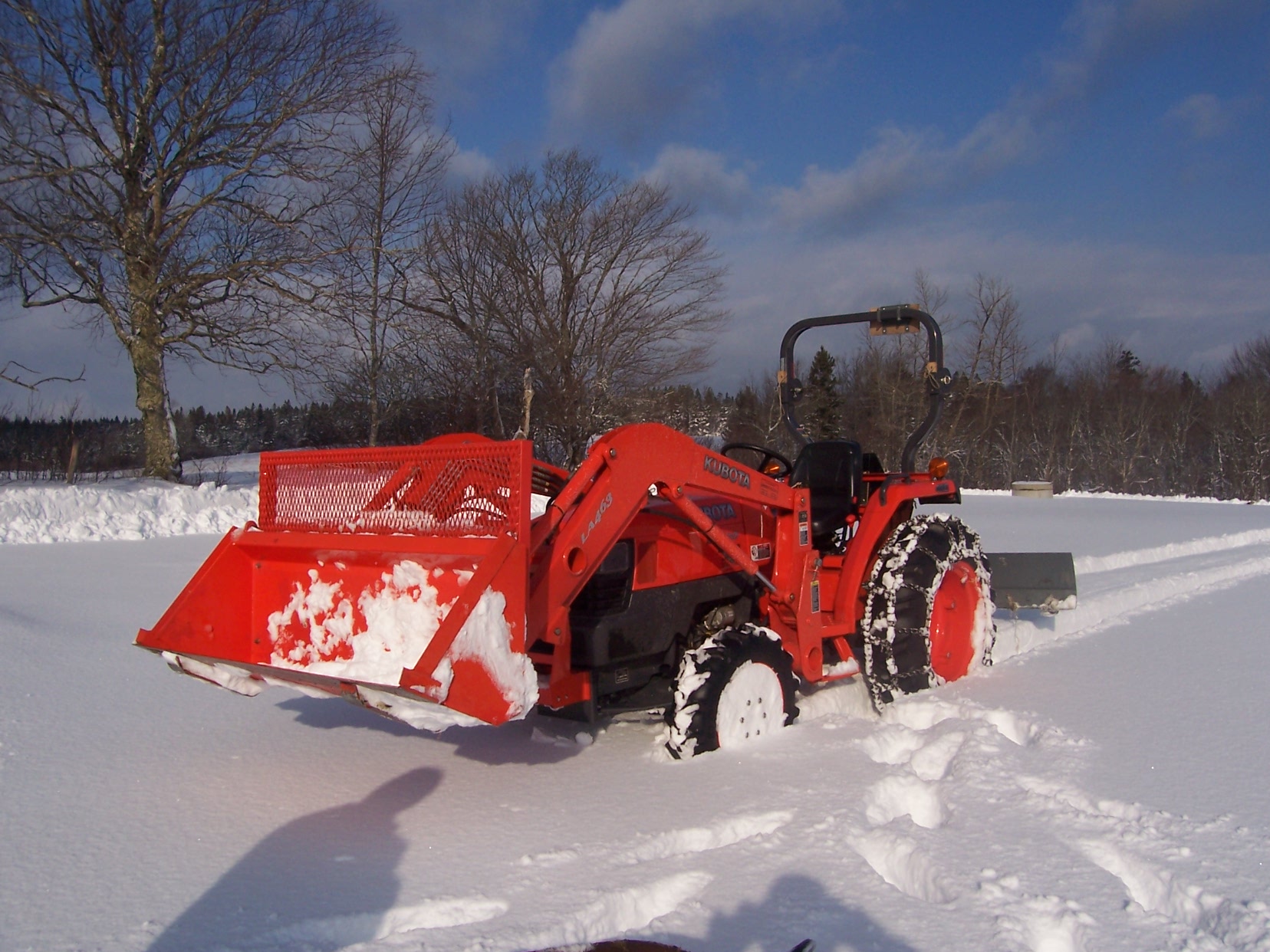

I put Norse ice chains on my L3400 with AG tires. I think your R4's have a lot less clearance than the AGs, you'll probably need spacers. Mine slapped occasionally at first till I shortened them a little more. I had almost 4 inches of clearance.

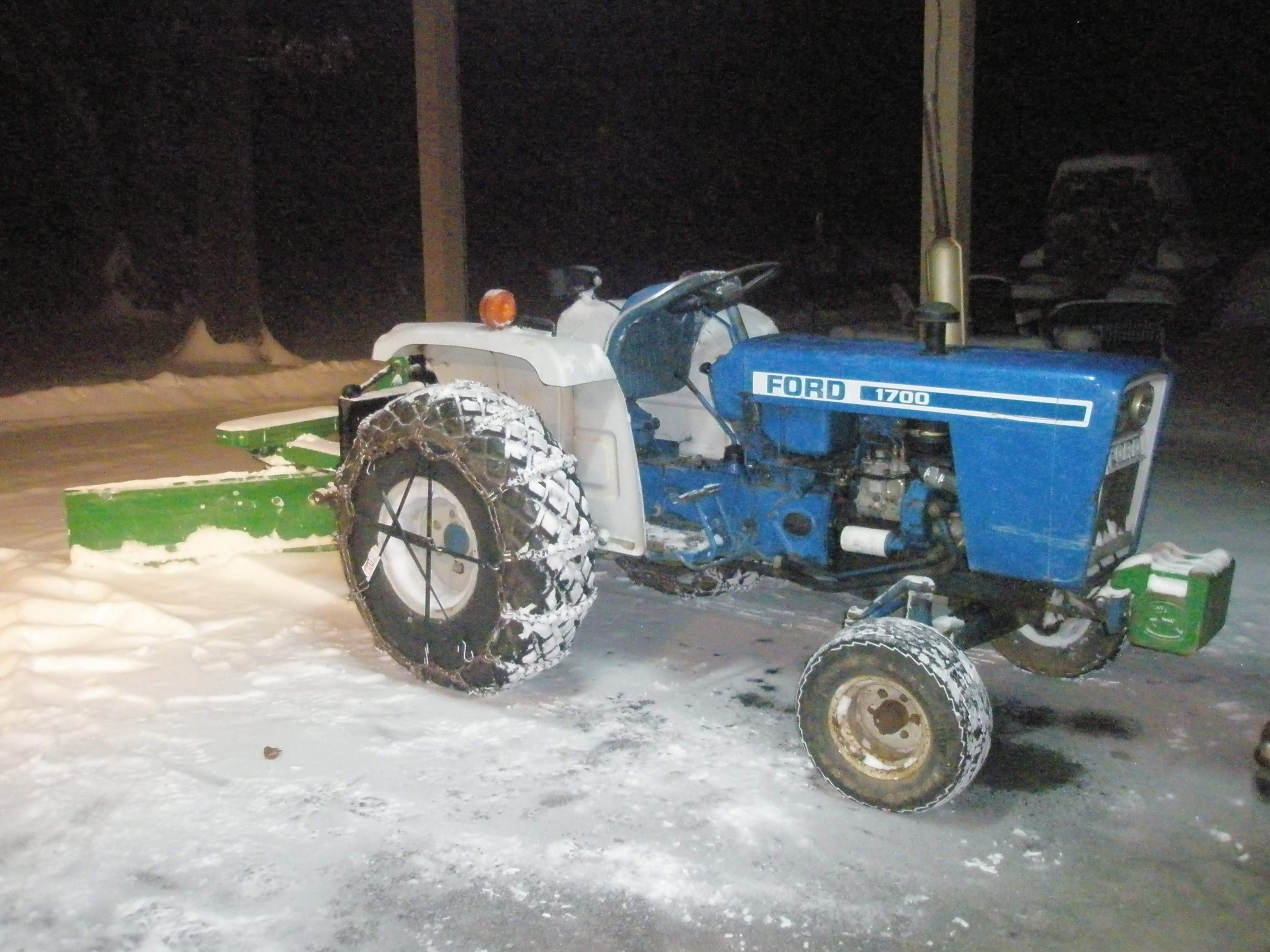

Those look like great chains, but if you have 4x4 you don't need anything more than regular ladder chains either 4 link or 2 link spaced.
I have 4 link spaced ladders on 2 tractors and even on a 2 wheel drive machine with turfs the thing is like a bulldozer. On my 4x4 with R4's and 4 link spaced ladder chains, there is no need for more traction. to much traction and you might break something IMO.
To answer your question about setting the chains up high on the inside, you can do that by leaving more slack in the inside side chain and taking up the extra slack with the outer side chain. that's usually how mine end up cause it's easier dealing with the outer side to get all the slack out as much as I can. I make my chains tighter than a skeeter's tweeter, some like them loose.
Hopefully those 2 inches you have will be enough, it may be close but I think you can do it if you keep them tight.

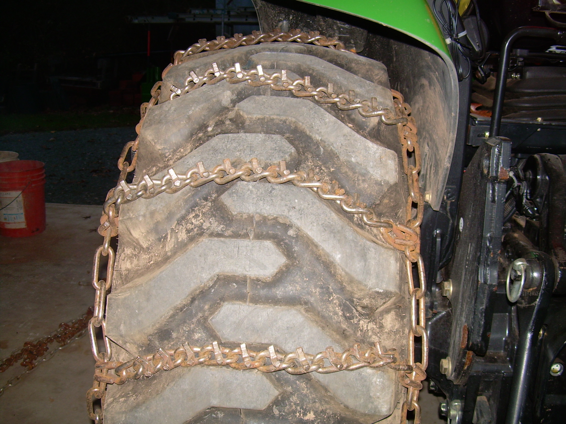

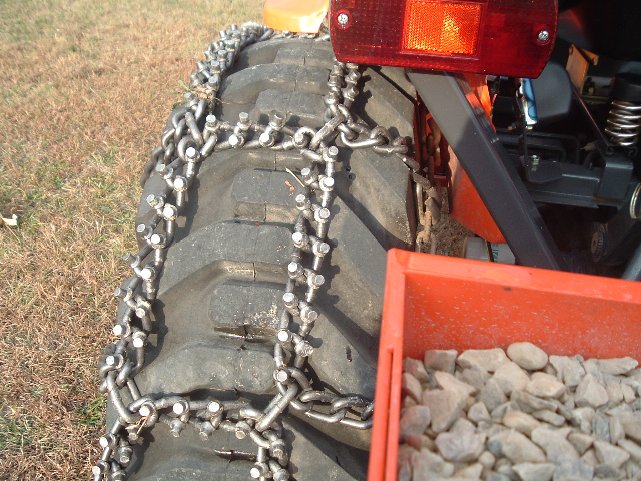

I have 2" fender to sidewall clearance with these chains and ran them all last winter with no problems.

I have the duo tracks on my 1530 nh with no problems.2 inch clearance will be no problem and you only will need them on the rear tires.This chain is meant for r4 tires and work as intended.

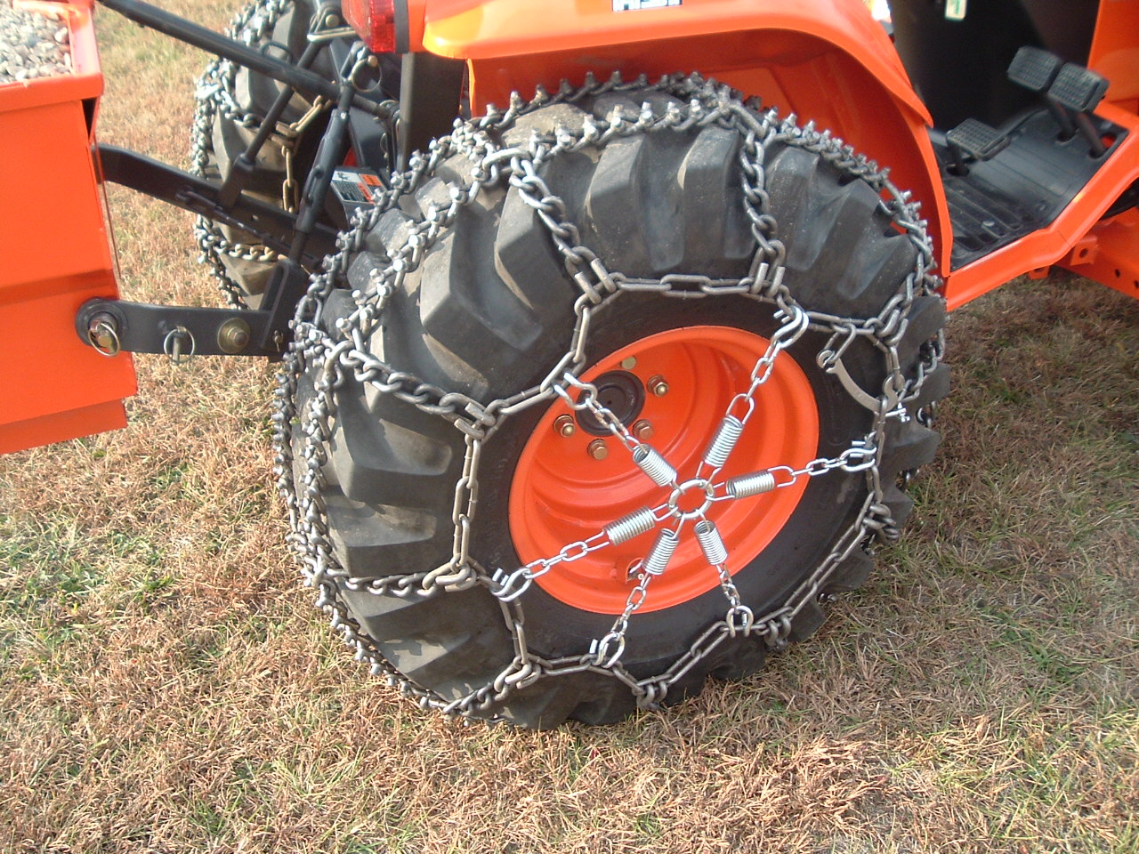

Whistlepig,
I would reverse the auto spring tensioners, the hook should face the outside so they never have the chance to dig into your tires.

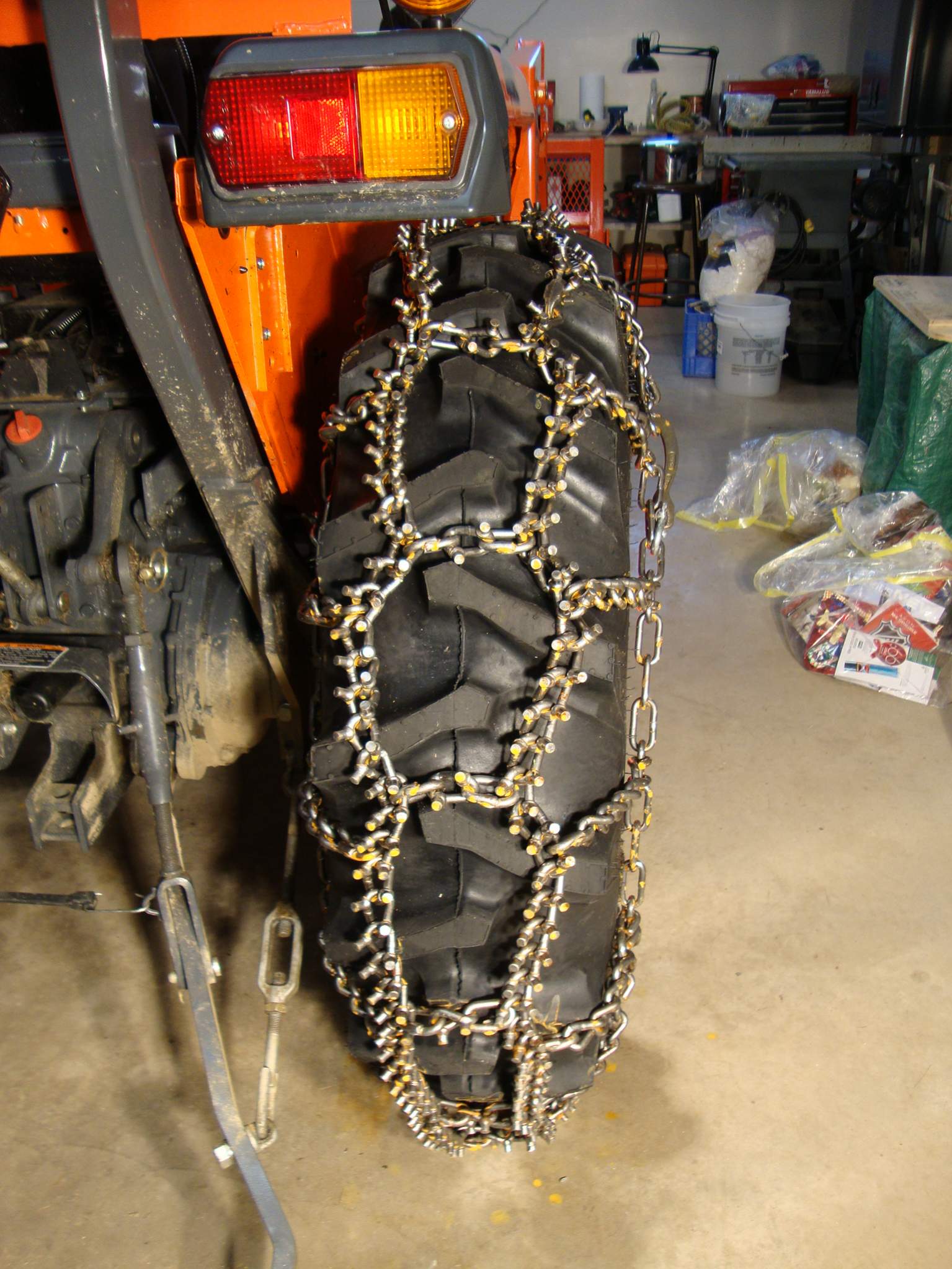

I have the same chains, mine are branded as Norse Super Tractor, I think his are Acquiline Talons, both made by Tellefsdal. They ARE smooth as silk on hard surfaces, and give great traction. Bad for paved driveways if you're inclined to spin them.
I run mine quite loose in comparison, and they have performed very well over the 2 years I've had them. I use them on everything from a gravel driveway to forestry work.

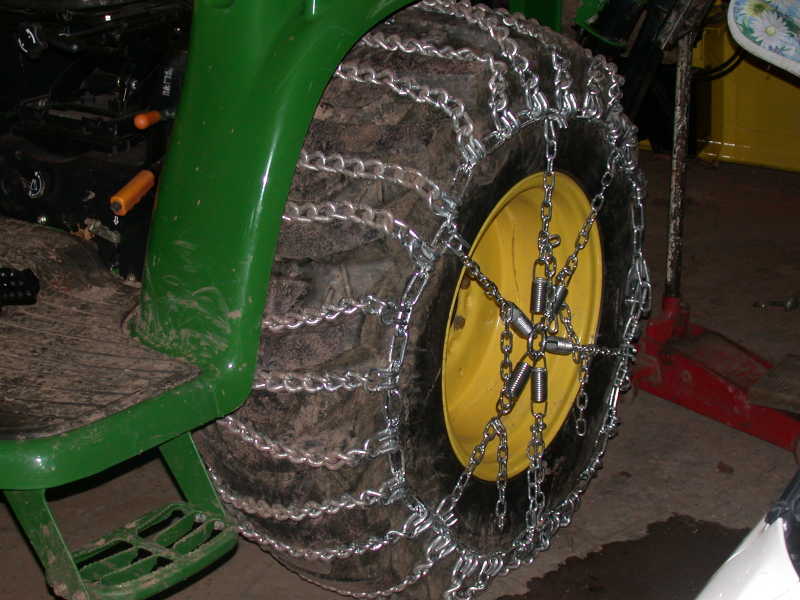

Actually, that pic is from last year...I remember another TBNer posting the same thing you just wrote

I posted these pictures last year and was advised to turn the hooks around. It was good advice and I reversed the hooks.

These are Aquiline Talons. They are almost identical to the Tellefsdal chains except the cross link set up is a little different on the Tellefsdal. These ride very well because there are no gaps in the chain to cause a bumpy ride.
