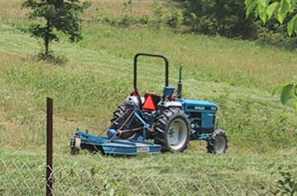

i have 3ft of heavy chain and plan to use to make top link do i have enough .and wondering about what to use for the end. any ideas welcome

I determined the length by hooking up my brush hog to the lower arms and with the cutter sitting on the ground measured between the connector pin on the tractor and the pin on the cutter. I allowed for wrapping around both pins and hooking back into itself at both ends. Also, I allowed for a little extra for good measure. This works great on uneven ground while you're brush hogging.

As a safer alternative, try running the chain through a length of pipe that is a bit shorter than your chain. This will provide a limiter to how much the implement (or tractor) can flip up if you snag something.

Try this method it has worked for me. Replaced the solid bars on brush hog with chains. I would not replace third link with chain . Even with chain on brush hog you still have watch . If tractor would come over backwards you have no "stop" to control it . with a solid bar you do . Check out chains on my unit. This is some thing that helps in hill country like WV as you see in background of picture.

An alternative I'm using is a pair of large D-Shackles. I have one pinned to the top of the slasher (as we call "brush hogs" here in Oz) and another pinned through the top link eye. This gives me a good amount of "pivot". Very simple (except that the shackles needed to be opened up a couple of mm...). I don't (as yet!) have a toplink for each 3pt attachment, so this is very convenient and cost me a couple of dollars. The shackles I'm using are 19mm (3/4") screw pin jobs - with the threads "gnarled" just enough to prevent them unscrewing in use (but also require fencing pliers to do up!).
