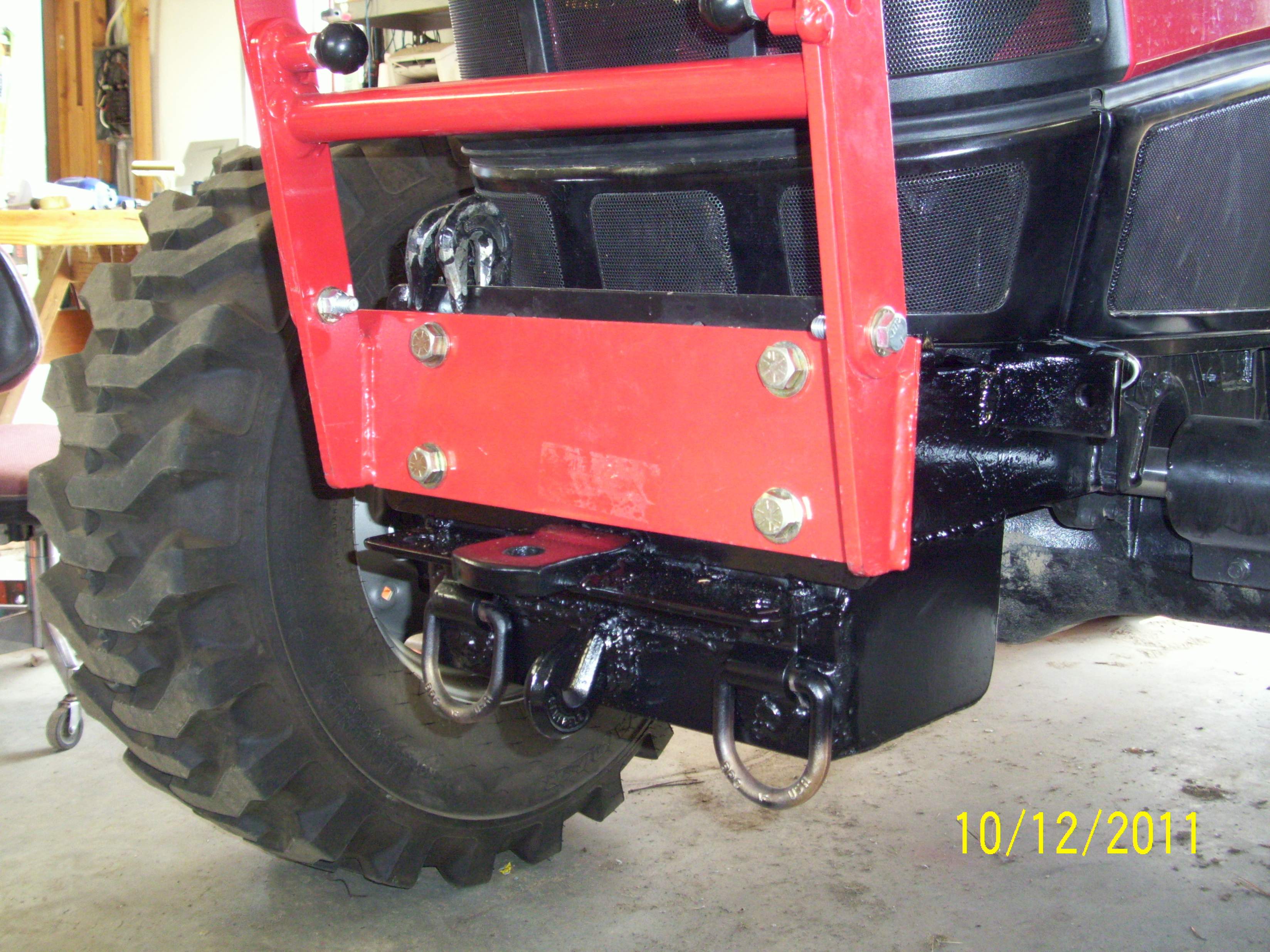

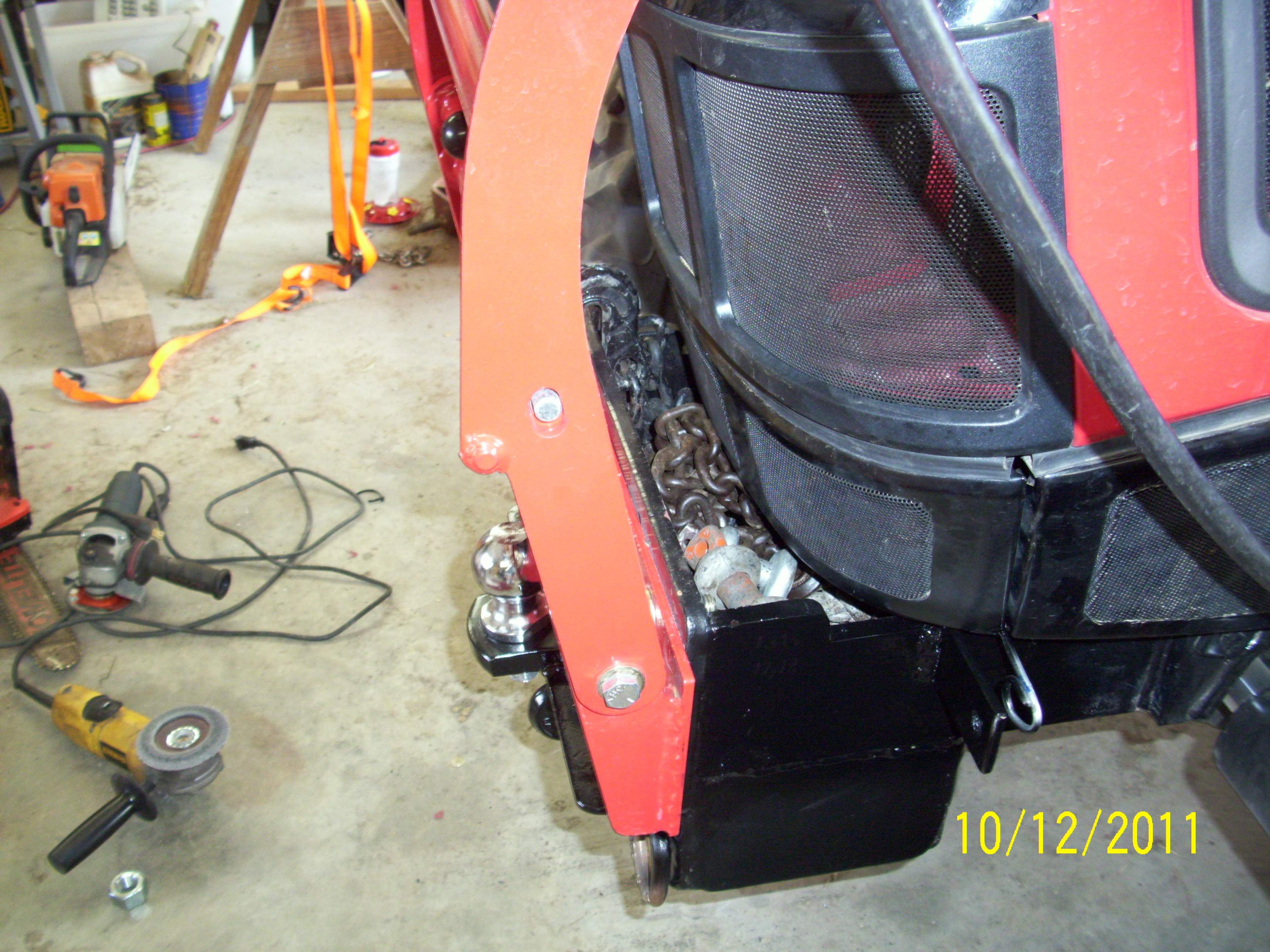

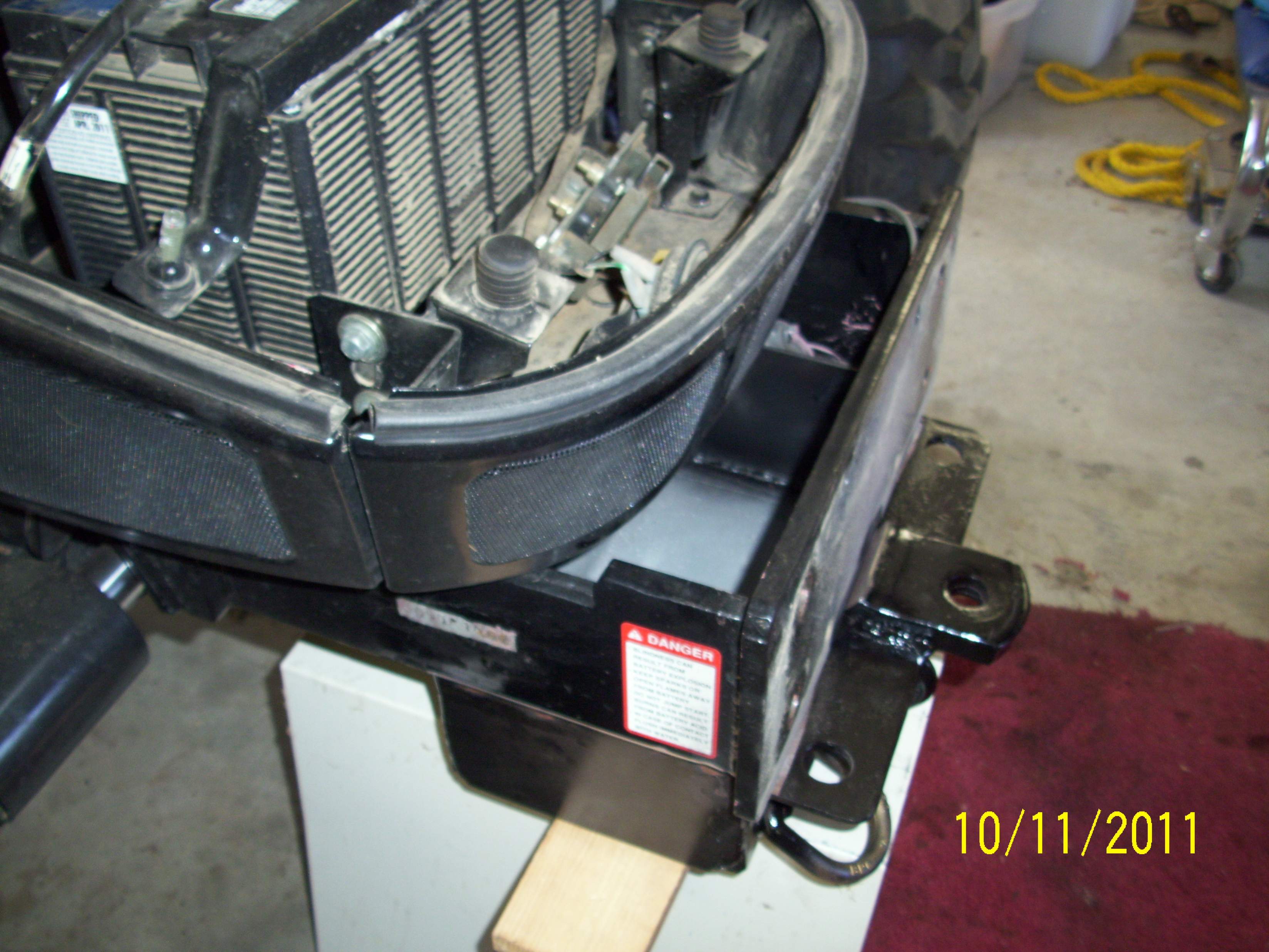

I love my Mahindra 5035, but one thing I don't like about the compact frame size, is the lack of storage space. Also, as one poster noted, a lack of tie-downs for trailering or strong pulling points on the front.
My solution was to make a extra heavy duty open top "box", welded to the frame rails. This gives me a place for several chains, shackles, etc. It also gives me a place for tie-downs and/or trailer ball. Of course, it is "overkill", but wanted to cover all bases, using what I had on hand. Would liked to have added a 2" receiver, but it would not work with the FEL.

I don't think there is anything "overkill" when it comes to a tractor. Nice job.
What is the bottom made of and how will water drain out?

The bottom is a piece of 10" channel, sides welded to the frame rails are 1/2" plate. I drilled 4 holes in the bottom corners for drain. As it turned out, it holds a lot more chains than I expected. I had built a similar one on my old MF250 tractor.
