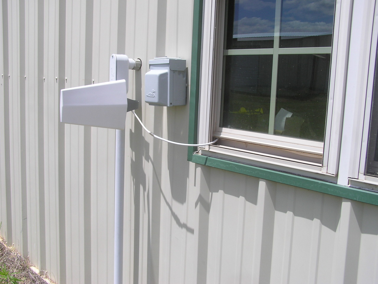

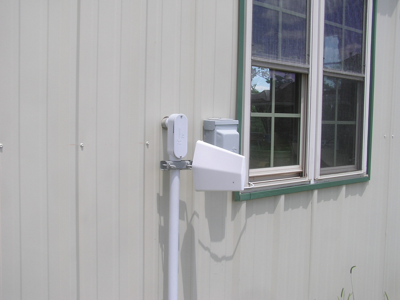

Subscribed, need to get reception inside the shop, a metal building. Have good signal in the house.
My flip phone is 3G.
Update: I ordered this: Home MultiRoom Cell Phone Signal Booster | weBoost
Installed it in the shop with the outside antenna temporarily next to the window that I could get signal through inside with the flip phone close to it.
Works great, went from no signal in the center of the shop, to full signal. Now I get a stronger signal any where in the shop than in the house. (y)

Very happy with the performance of the system.

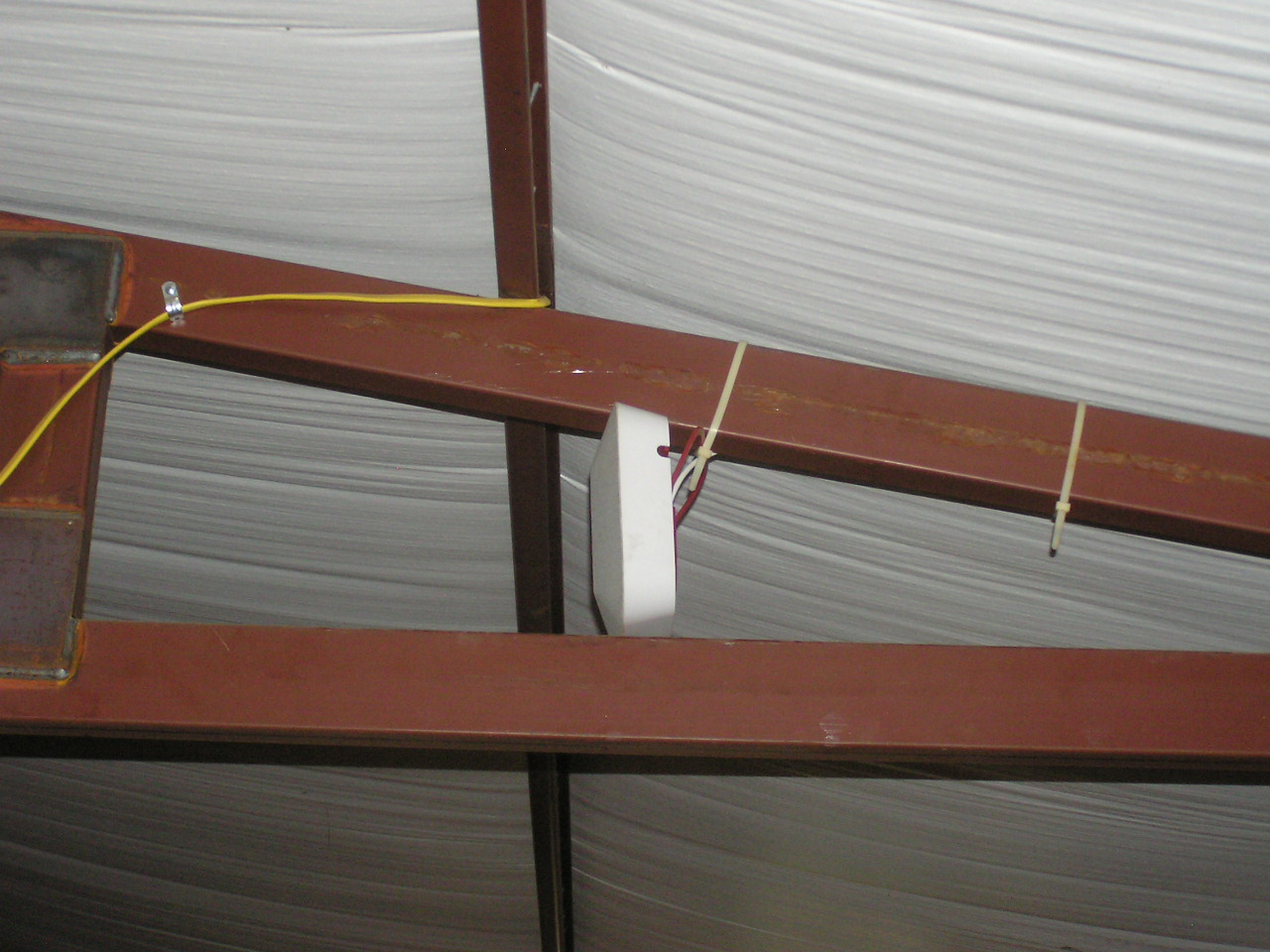

Moved the panel antenna from it's temporary location up higher to it's permanent location on the truss:
Moved the booster from setting on a box on the bench up onto the pegboard:

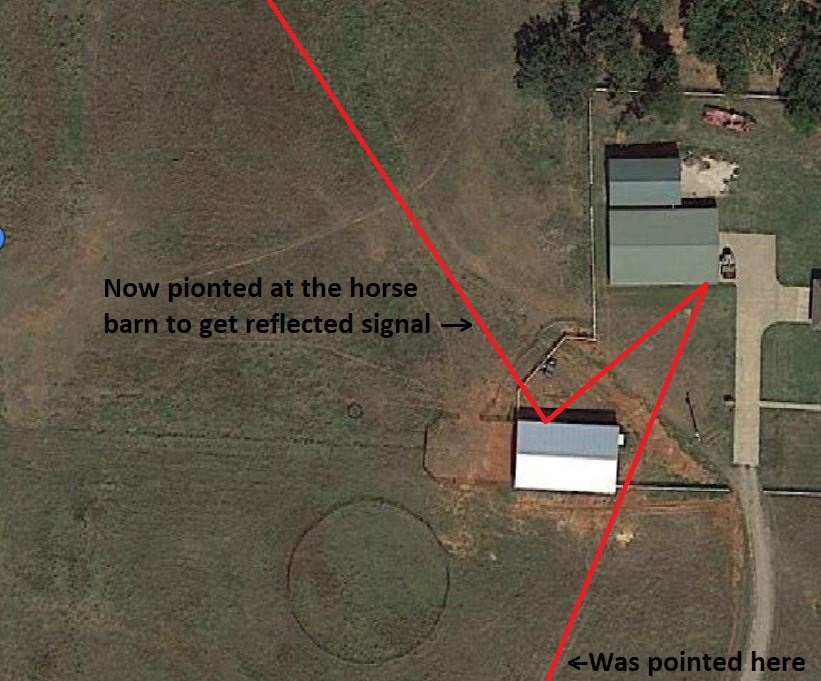

I am surprised that it is working with the outside antenna so low. The tower it is pointed at is over the high spot south of the horse barn, it is 8 miles away and 225 feet tall.
The red line shows the way the antenna is pointing:

After Verizon bought Tracfone my flip phone (upgraded to 4G) signal in the shop was very weak. So I found out that the closest Verizon tower is on the other side of the shop. Didn't want to put the antenna up on the roof, so I pointed it at the side of the barn to see if a reflected signal would work:
Success, I now have 4 bar signal strength in the shop and the antenna is still low.
The antenna viewed from the barn where it is pointed:
/ Cell Phone & WeBoost #30
clever solution to get the reflected signal vs. the primary.
Metal is great for that.

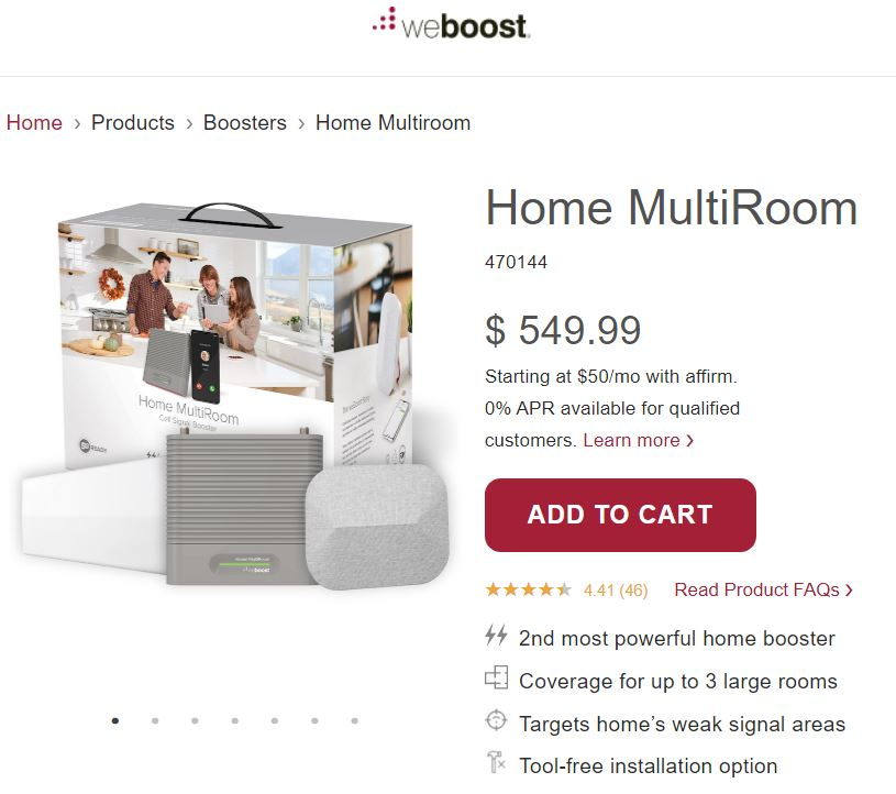

What antenna did you go with?
I've learned where I have signal and where I don't... and it's different between T-Mobil and Verizon
/ Cell Phone & WeBoost #32
weboost.com/products/home-multiroom
/ Cell Phone & WeBoost #33
Thank you...
