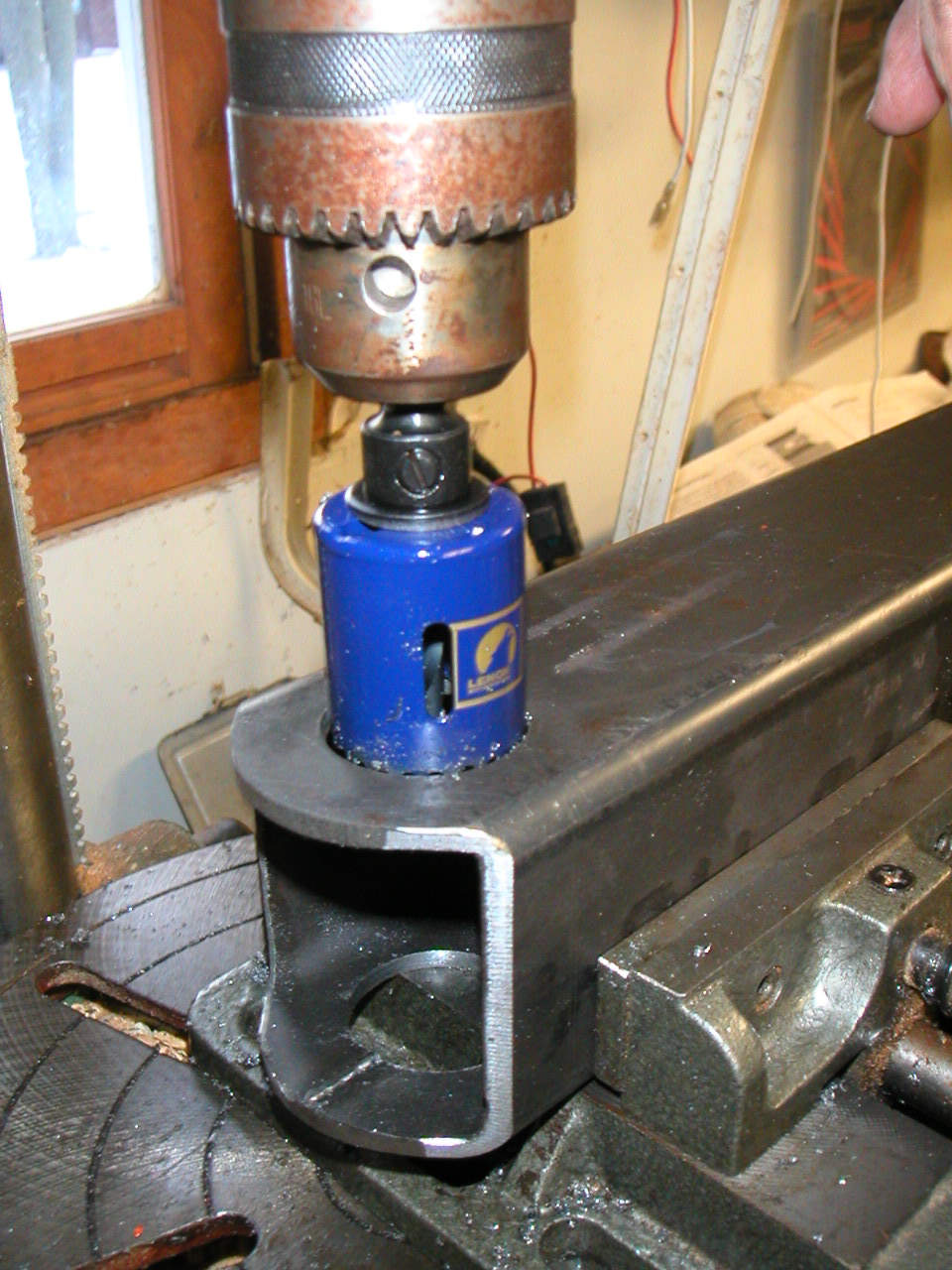

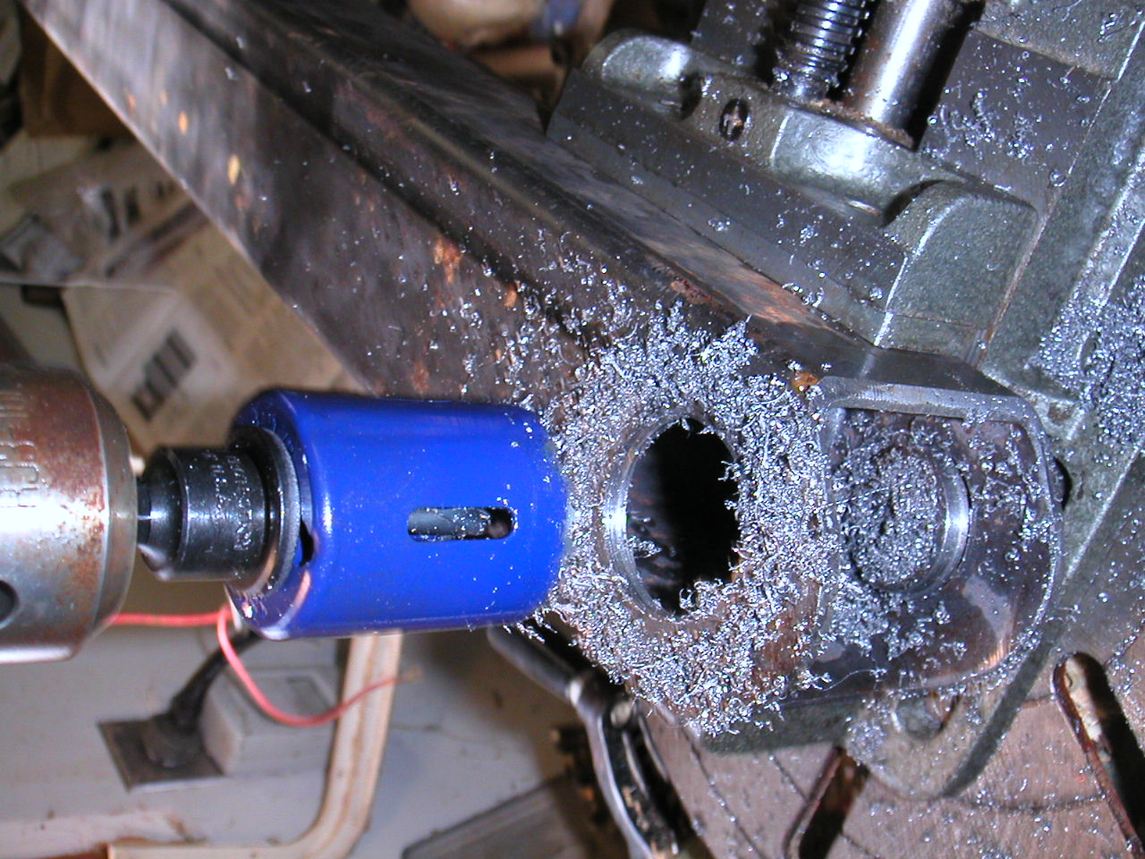

This is off subject but what hole saws do you guys recommend for boring in steel?
I have used high dollar and low dollar saws with pretty equal success.
While the high dollar saws are usually constructed better, a decent low dollar saw will work, providing: Slow the speed down and use cutting fluid!
/ CDP BACKHOE BUILD #22
Same here, I have bought Black and Decker, which were very good BTW, Morse, Rigid and Milwaukee and they have all been good. Slow and cool is the key to longevity. In fact, I am still using the B&D bits (I've never had to resharpen after hundreds of holes) and arbors and just replaced the saws.

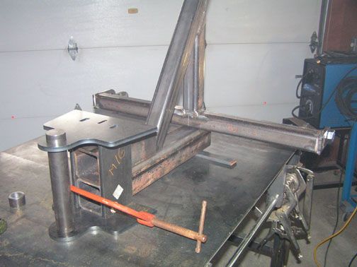

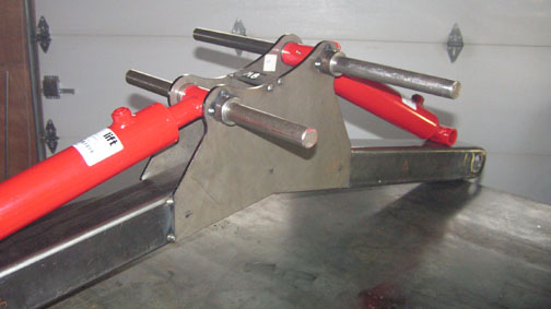

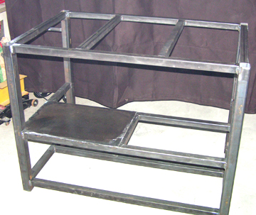

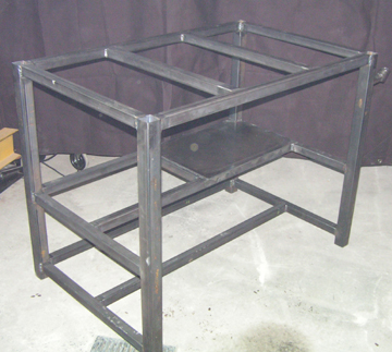

Just about 2 weekends lost on other responsiblities than the backhoe work.
1 item or say tool which does not get to be taked about much in discussions about building a backhoe and for that matter is a sturdy level welding table. So I had to spend a good deal of spare time fabbing a table, which unfortunately I have not completed. (need to get 3/8 inch plate for top)
I also spent a great deal of time grinding and cleaning boom and dipper arms. Progress is slow, but I need to be patient, do good fit up and resource economical material ( ie: plate for table top, $270 cdn, for sheet 4 x 8 , wow). I included some pics.

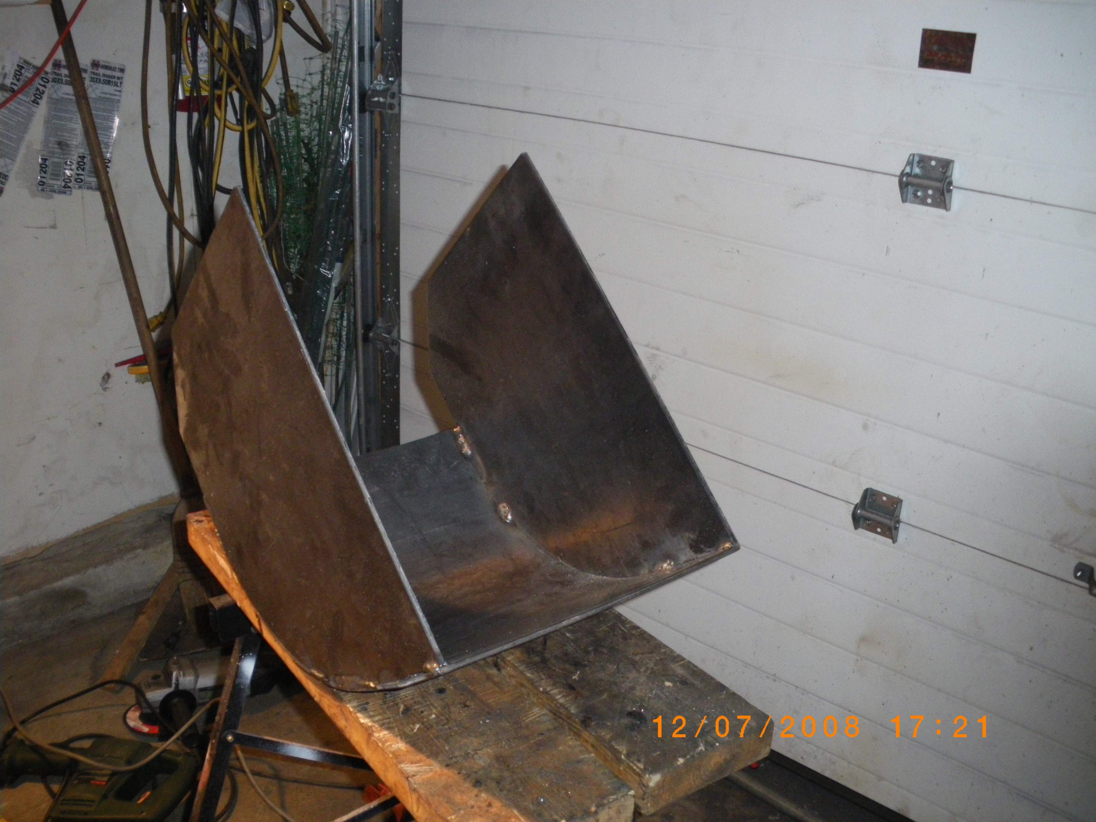

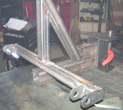

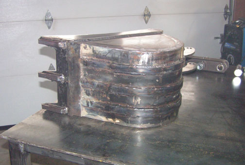

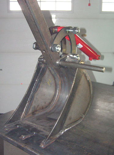

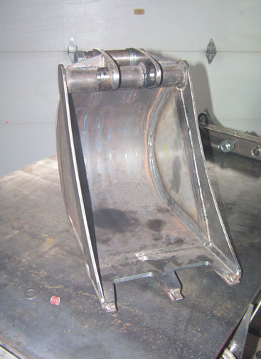

Made some progress lately on my project. First the table is finished. 2nd the bucket is done except for one bushing. Tacked up the boom, and aligned the cylinder plates. I'll weld it up when I am sure that the fit and movement with the swing piece is correct. Started to put together the frame and swing part. Progress is slow as family and work commitments have taken up most of the free time. I only hope is that I will finish the hoe in time to dig my water entrance.

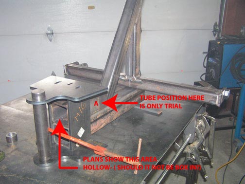

I have a question on the frame. Between the upper and lower plates of the swing part which connects to the frame it is left hollow and open. Should this not be boxed in and strenghten some how. My idea was to turn the tube I placed for trial fit and see on end and cut to size weld in place. That way there will be more support and be box in so muck does not accumulate. Or is there a reason that this area needs to be left hollow. I am thinking to order this valve (see attached). Will this work.
That looks like a nice valve, I wished they would of had them when I ordered mine duel joystick valve.
I believe my assembly is boxed in. I will take a look when I get a chance.

I looked at my machine, and it is not boxed in, looks like yours. Perhaps they thought to run the hydraulic hose through the tunnels.

To bend the back plate for your bucket. If you have a hydraulic press you could turn that into a small press break. Weld some 2" angle to a plate to create a valley and set the plate on it put some bar stock on top of the plate and press. move a few inches and repeat. This can get you close. I have a 20 ton HF press and this worked for 1/4" plate 14" wide.
Good Luck
Phil

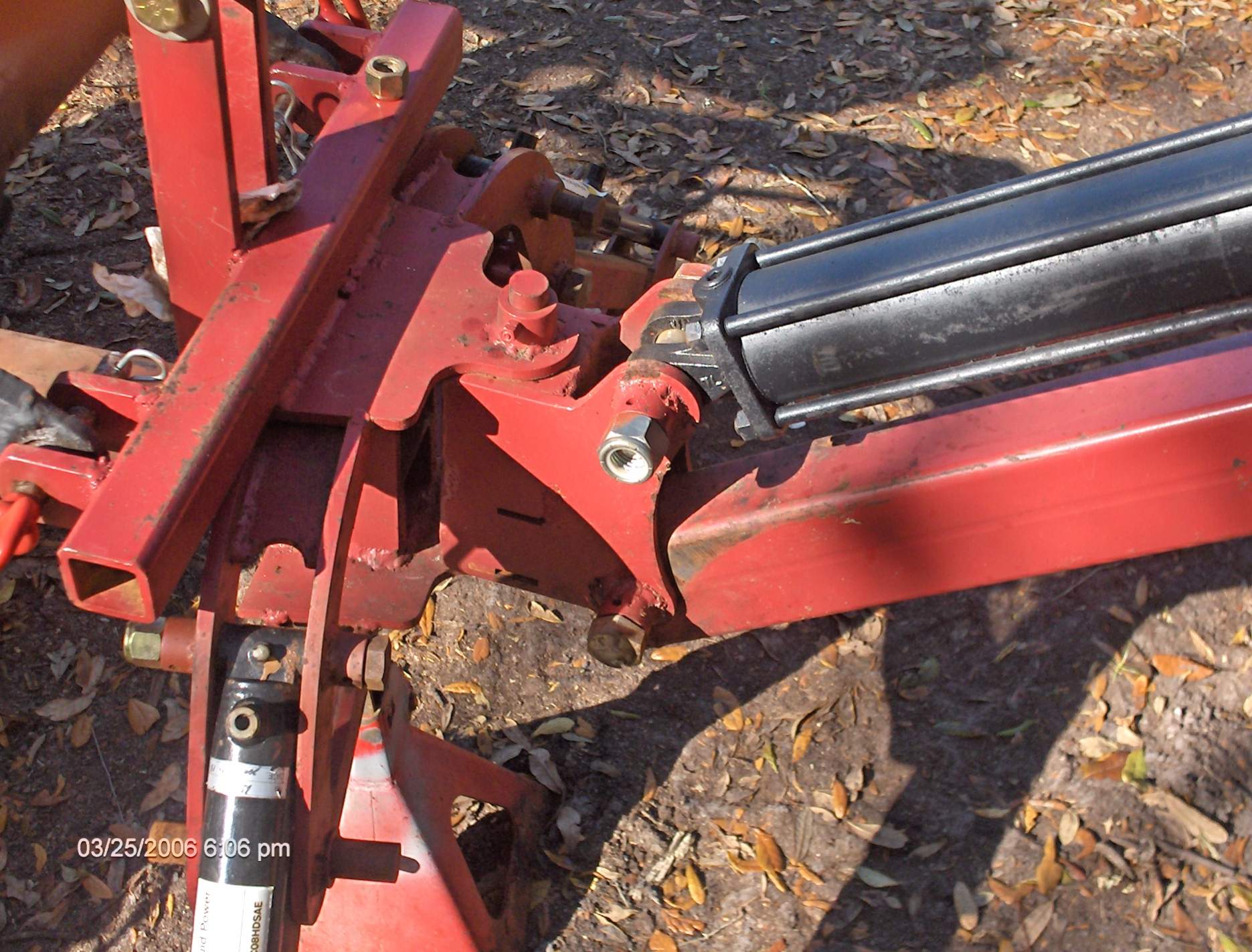

I am putting together the pivot and swing assembly and am a little confused about the bushing placement. Should they be flat to the plates of the pivot or slightly pertruding to keep the swing assembly from dragging and possibly getting caught up. If I weld flush to the inside top and bottom of the pivot plates then I will need to get some shims to space the pivot centered inbetween the plates. I could use your suggestions and help. A picture would be nice!:confused:
/ CDP BACKHOE BUILD #37
Here is a picture, am I nice or what? The boom is flat so it will ride against the flat surface of the receiver. If you put a protrusion on the outside of the boom, it would eventually eat a hole in the side plates. Besides that, the receiver is built to take a 4 x 4 box steel. Is your wall thickness 3/16, or i/4 in?
Do you have the complete plans for the BH? A picture would be nice, but not necessary. Mine is somewhere else right now,

Yah you nice. Thanx. I can see that I will need to put some brass shims apporimately .060 to .100 " on the swing assembly as I had mine milled parallel and flat. Thanx again for the pic. My plans ask for 3x3 tubing for the boom.The sleeve /bushings will pertrude by approx. 1/4". I can see that 6this might create a problem?! I will verify the plans but I'm sure they ask for 3x3.
