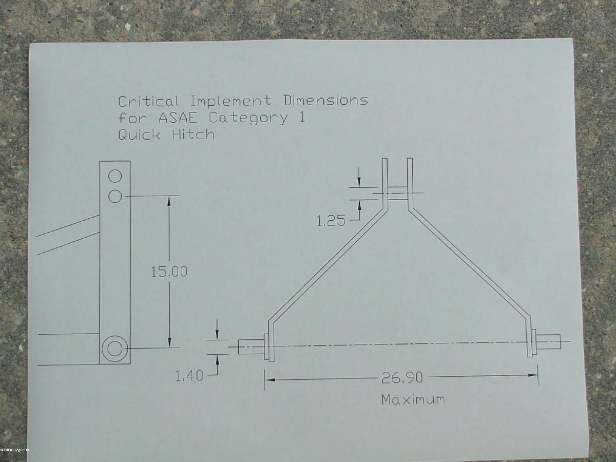

Do you want to know implement specs, or quickhitch specs? Let me know, all ASAE specs are on my shelf, would take about 5 mins to look up for you.

I guess both. Whatever you have would be great.

Sorry, I got busy and didn't get back as soon as I wanted.
Let me know if you need any clarification on the terms or what the measurements are for.
Quick hitch spec, ASAE cat I
Lower socket inside span 27.03-27.15 in
Lower socket width 1.10-1.16
Upper hook verticle spacing 14.78-14.88
Upper hook width 1.25
Three point implement spec, ASAE cat I
Lower hitch pin span 683+-1.5mm (26.89+-.059 in)
Mast height 460+- 1.5mm (18.11 +- .059in)
   / Category 1 3pt hitch specifications #17
And a drawing for the quick hitch ASAE standard attached.
