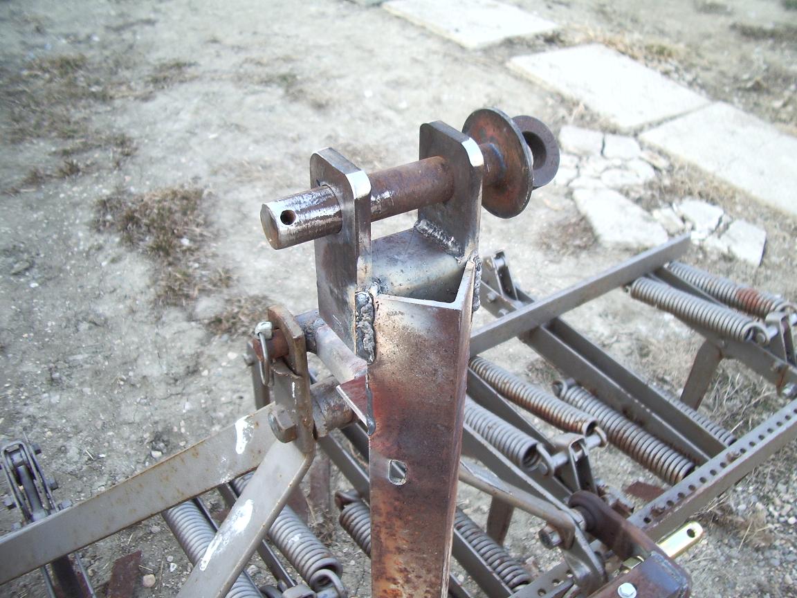

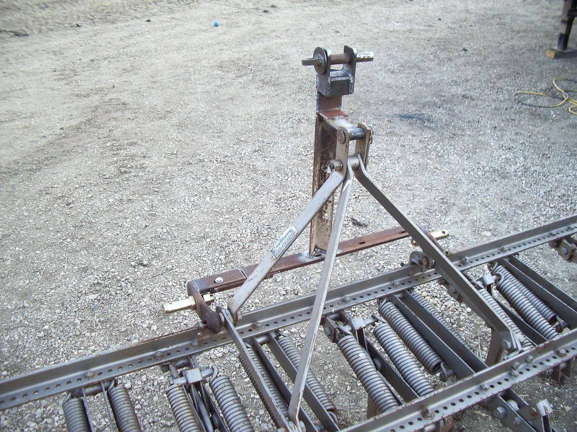

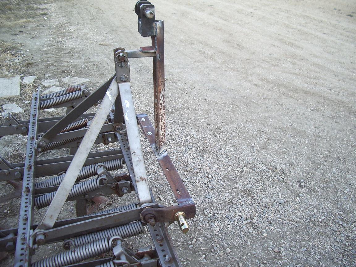

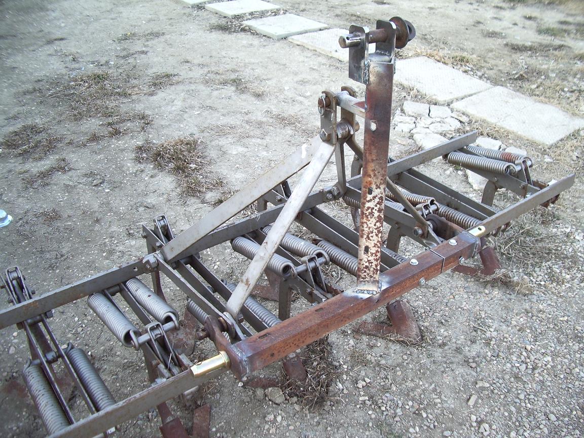

I bought an old Ferguson cultivator not realizing my tractor was a cat2, and the cultivator was a cat1 3 point. I didnt want to hack up an antique, so I came up with this from the scrap pile:

Looks like it should work.
Let us know if it holds up to the larger tractor pulling it.
   / cat1 to cat2 adapter #3
Man, you should have come here first! For about 5 bucks at TSC or any ag supply they have a sleve type adapter to go over the cat 1 pins to size it up to a cat 2, same goes for the top link. But what you've made looks real nice and should work fine.

I can buy the bushings here for about $1.50 a set (I already have a set) but the arms wont physically fit on the cultivator, the frame is too close.

Rusty has the correct response I believe. The bushings work to size a cat 1 pin dia. to use a quick hitch. Cat 2 arms are a wider stance and a higher top link. Will a cat 2 rear shrink in adjustment to close the difference to a cat 1 implement. Will the cat 2 components adjust to get the proper performance from a cat 1 implement? What you did looks like it will serve its purpose fine. Just thinking ? My 4420 is cat 1, so I have not encountered this issue. Gene
