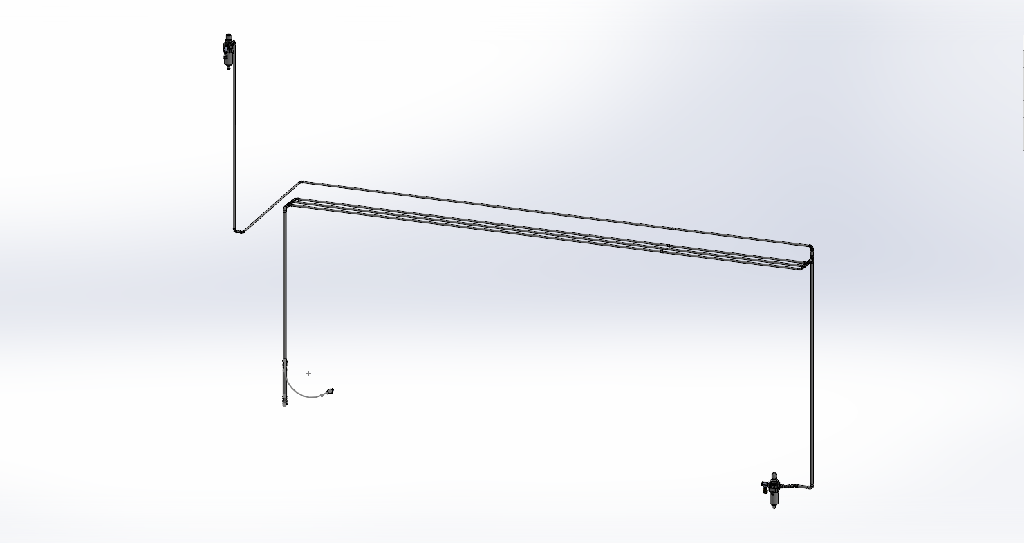

Got tied up working on an air compressor project tonight, sort of re-doing my entire shop air dryer and distribution setup, which meant the figuring of dozens of new fittings, pipe, etc. Ended up putting it all into 3D CAD and doing up a full BOM, going to try to pull this one off without the buckets of extra fittings I normally have on hand for jobs like this. Buy only what you need, use only what you buy... or at least that's what I'm going to try!
