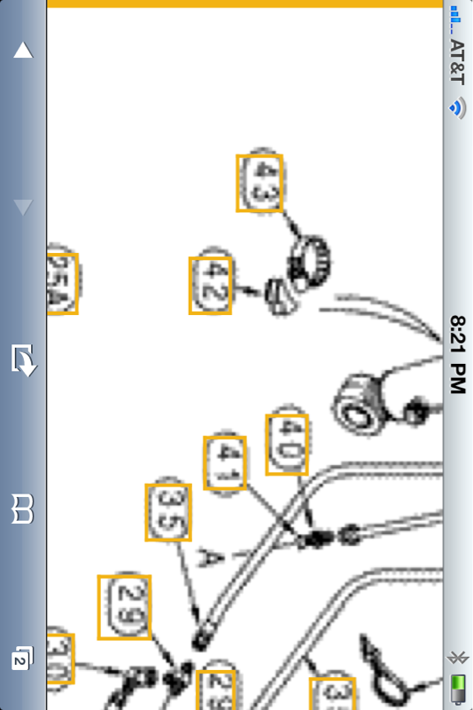

I own a 1979 580c case. While bring it back from the dead I noticed 5 or 6 of the rubber spacers that hold the steel hydraulic lines to the cylinders are missing. I called Case this morning and the cost for each spacer is $18.00 a piece. This seems a little rich to me, but I might be wrong. Have any of y'all found a cost effective alternative to this part. Thanks

638 here is your pick from the case parts book. See #42.

McMaster Carr, page 3501, cut it to shape on a bandsaw.
