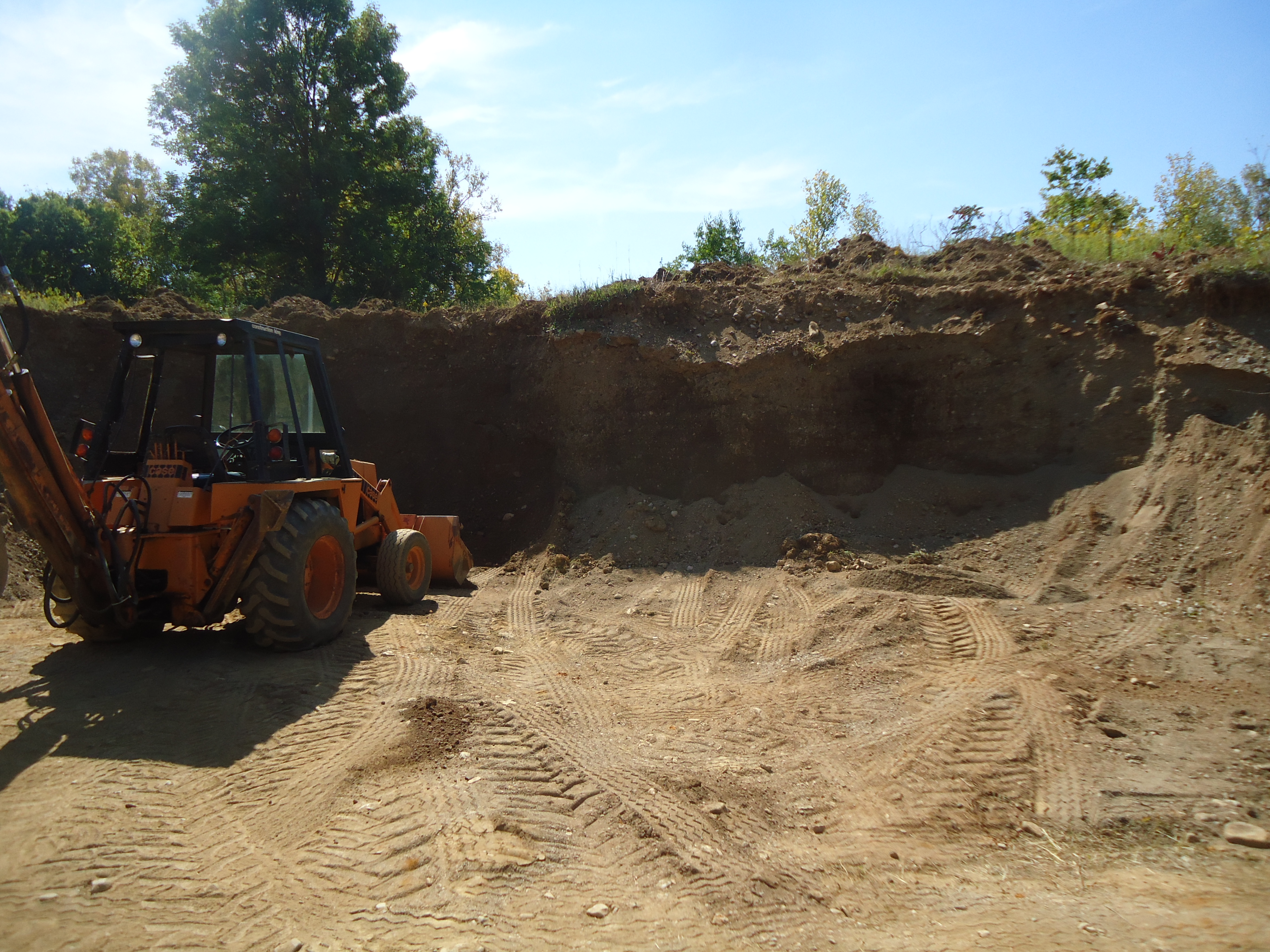

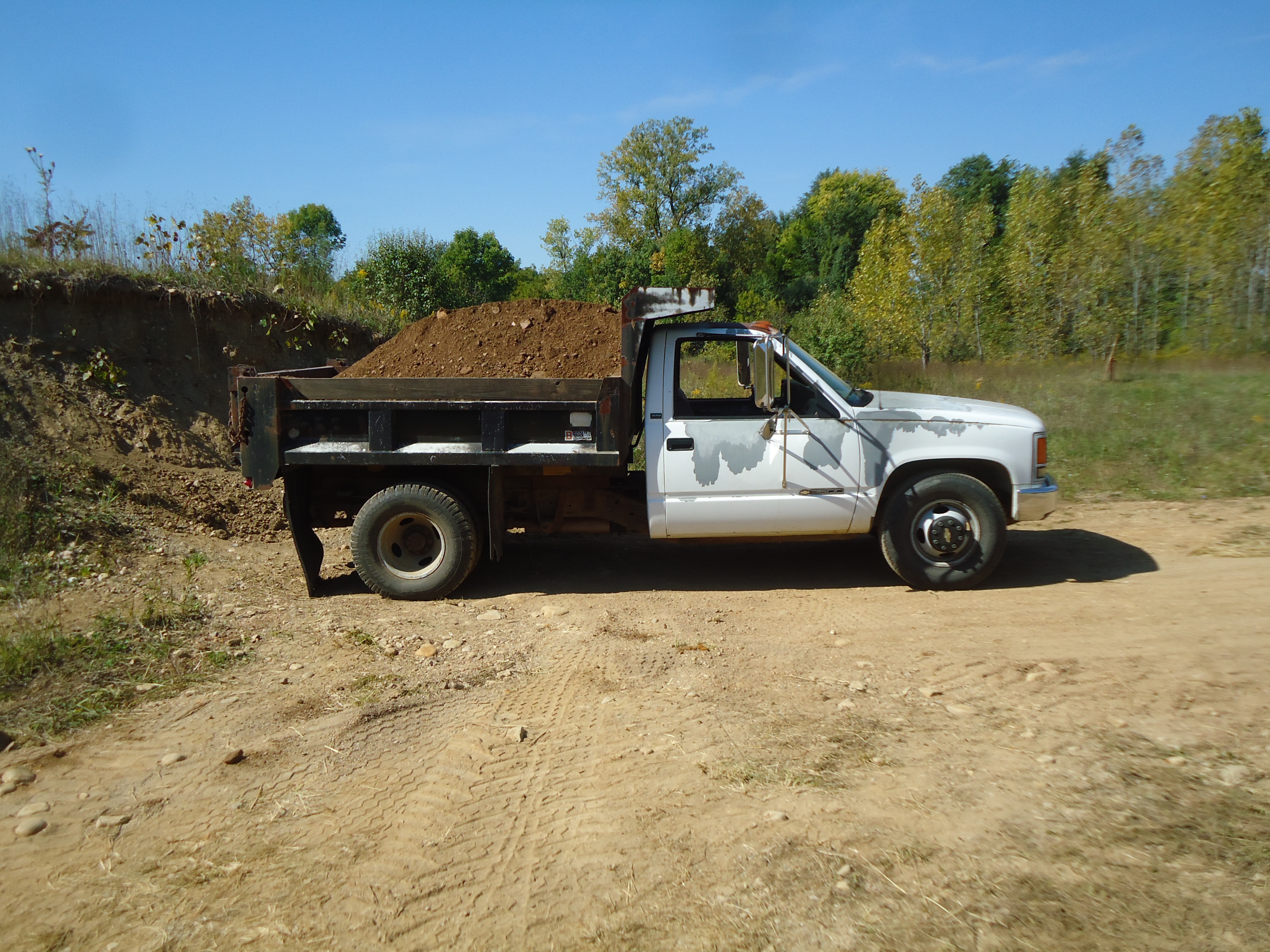

Good to hear back. Mine is still kicking. Loaded out another 700 tons, or so of bank run gravel last fall, and this fall, for a new building pad. Still need another 200 tons, or so, this Spring to make a gentler grade on the slope going up to I on the one end.

The torque converter has me spoiled, especially when you load out 30 some loads a day, and 5 buckets full to fill the truck. The old 310 had a clutch, and I definitely felt it at the end of the day, loading that many loads. The important thing with a TC, is to come to a complete stop, before changing directions. That's a lot of torque slamming something, if you don't, and shortens the life of it dramatically.

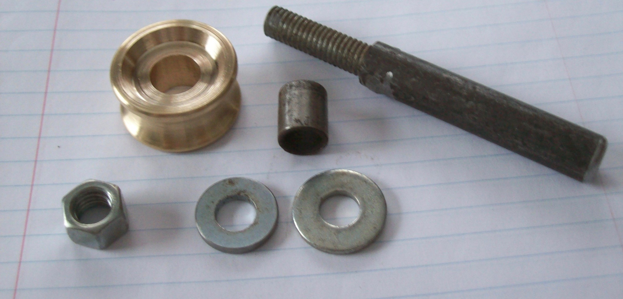

I am now in the process of rebuilding the stabilizer arm bushings, they were completely gone and I had to weld the egg shape hole to fit the new homemade bushings.
