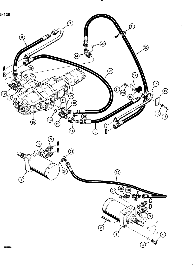

Can anyone tell me why my drive chain housing is filling with hydraulic oil? Any info would be greatly appreciated.

I do believe your drive motor is leaking.

The hyd drive motors are connected to the planetary drive which are bolted to the chain housing. I believe the only way hyd fluid can get into the chain housing is through the planetary gear box.
I believe a way to check if the drive motor is leaking is to jack the skid steer up on blocks, and remove the wheels and the drive motor. Then start up the engine and engage the drive and see if the shaft seals are leaking. Another way would be to remove the drive motor, and take to a hyd shop for testing, and if leaking, get an estimate for seals or whatever. If you think you can do it, have them order the seals for the motor and do it yourself.

The 1835B is a little different than the 1845.
The drive motor doesn't bolt to a planetary on the 1835B, it mounts to the chain case and there's no center or 'idler' sprocket in the chain system.
I've attached a parts diagram that may help you.
Mark
