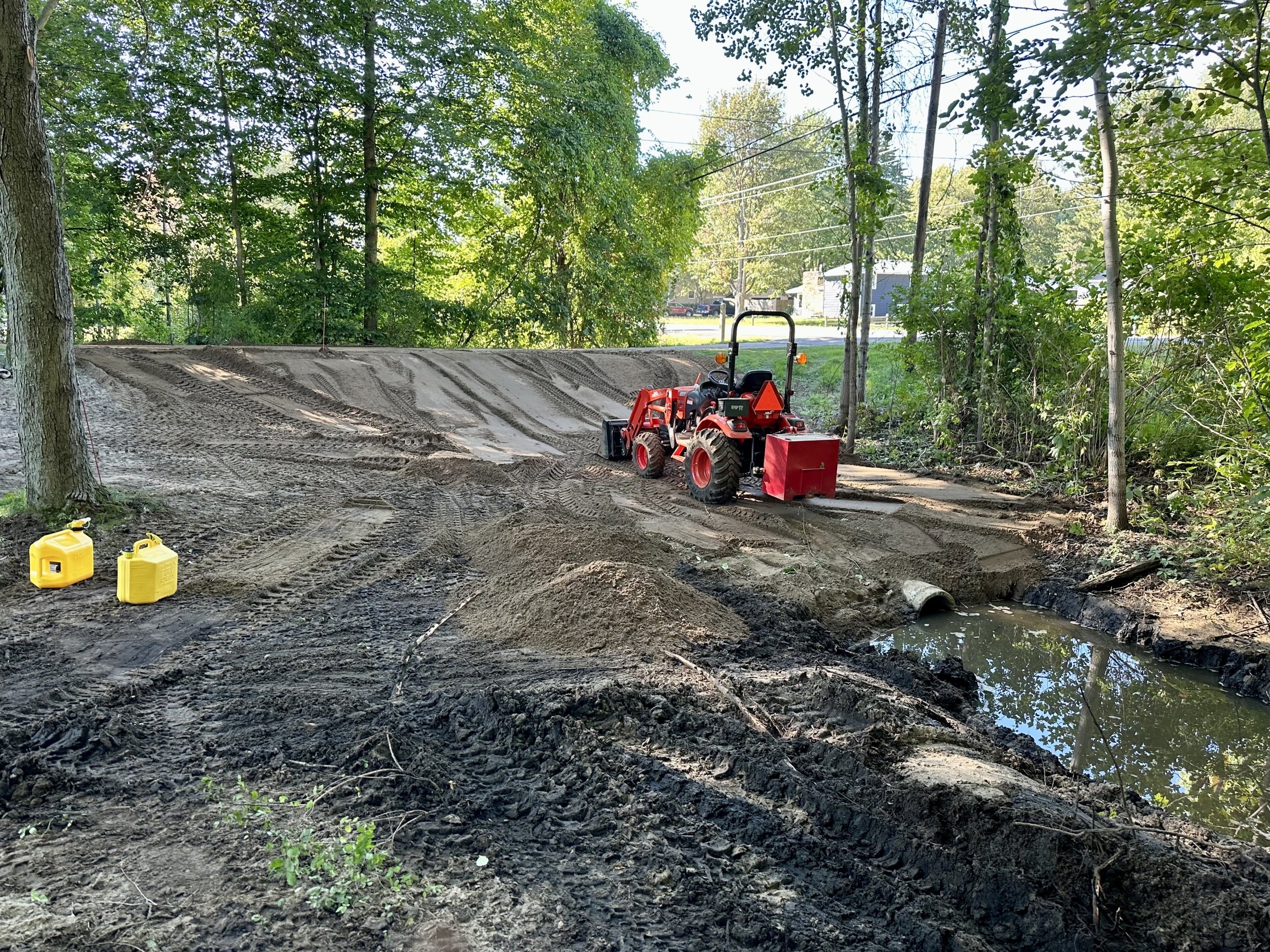

Glad you're okay. Definately a "pucker" time... Get your rear tires loaded. I have RimGuard in mine. One time install, not in the way. Install and forget.

Rear ballast was something I learned I needed very early on when I had a butt puckering moment while working down a slope. I bought a cheap steel ballast box off Amazon and filled it with concrete. I won’t do loader work without it anymore. Makes a world of difference.

the machine's small size and short base is important for where I'm working
I totally sympathize. A ballast box can, though, be pretty small, only sticking out back by less than a foot, and as narrow as a cross bar. I bought one and filled it with scrap steel and then concrete over it all, brought the weight up to 800 lbs. It is very little in the way. Just my two cents.
The one I bought seems to be exactly the one kozal01 shows in the picture.

Was moving dirt on the kubota b7200. Little tractor, big jobs, it does pretty well for what it is. Ran into the dirt pile and got a good scoop. Left side was heavier, I could feel it. I backed up and the right rear tire came over a mount of dirt, and the back end came up, and everything started to roll left.
I had my right hand on the controls and left on the grab handle, but I was going left, and I began to fall out. I put my left foot down on the ground to stop myself from falling, and I saw the tractor coming down and the foot rest was going to hit me mid calf when the tractor fell, and my brain was screaming MOVE.
It all happened in slow motion, my mind was racing, right arm was searching for grab handle, right foot was on reverse, which was the wrong thing, left hand still holding it's grab handle. Just then, the bucket hit the ground, and everything stopped. It gave me a split second to re-orient myself, right hand lowering bucket, in forward to come off the hump that elevated the right rear tire, left hand steering left to turn into the roll to push weight to the outside.
If that bucket hadn't hit the ground at that moment just before hitting the point of no return, I'm fairly certain I'd have lost my leg at least from the knee down.
Also I'm gonna need a ballast box.
