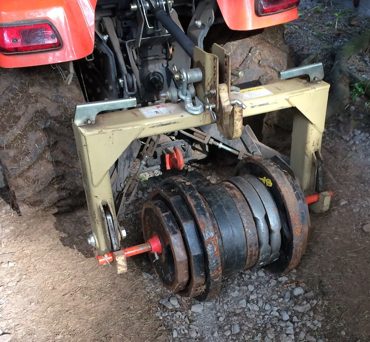

I don't want an implement or ballast box, the machine's small size and short base is important for where I'm working. I think I'm going to lower the 3pt arms and put a bar between them and put weights on it. I don't want to make the machine any longer than necessary. I bet I could get 400lb on it.
/ Carry low #4
Bx weight bar. It is now up to about 420 pounds.

Found a guy locally selling suitcase weights, so i'll have 240lb to start.

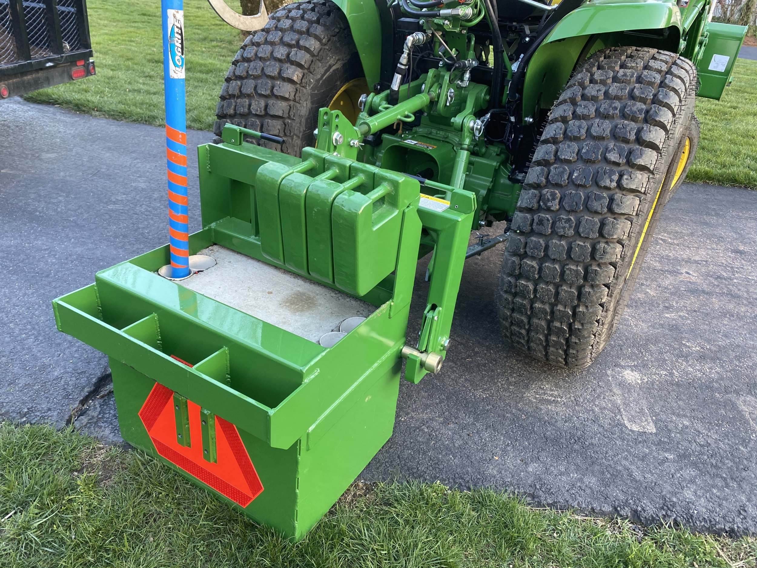

I know you said you don't want a ballast box, but it is a good way to make something that is the most compact and useful method of quickly adding weight, and of course they do not add to the wheelbase of the tractor at all. They do extend LOA, but not wheelbase.
Filled tires are probably also recommended in the user manual for your loader or tractor. They do make for a stiffer ride, and can't be easily unloaded when you want to run light, but if you usually have the loader mounted anyway...
Speaking of which, Deere puts tables in both the loader and the tractor manuals, showing recommended ballast for various tractor/loader combinations. This is usually very conservative, including filled tires + wheel weights + 3-point ballast. The main advantage of ballast on the 3-point is that it's the only way to remove weight from the front axle, which is usually recommended with today's higher-capacity loaders.

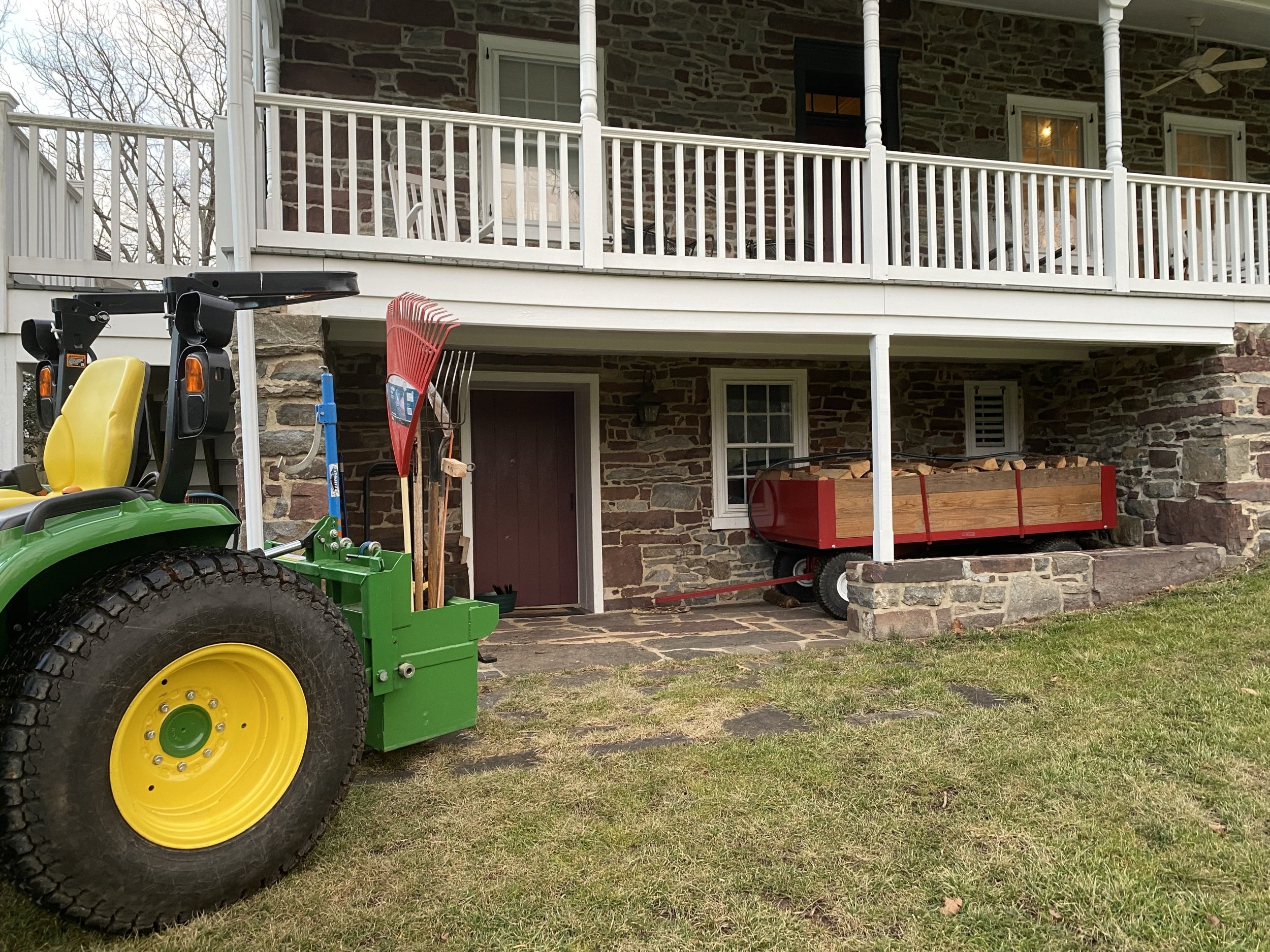

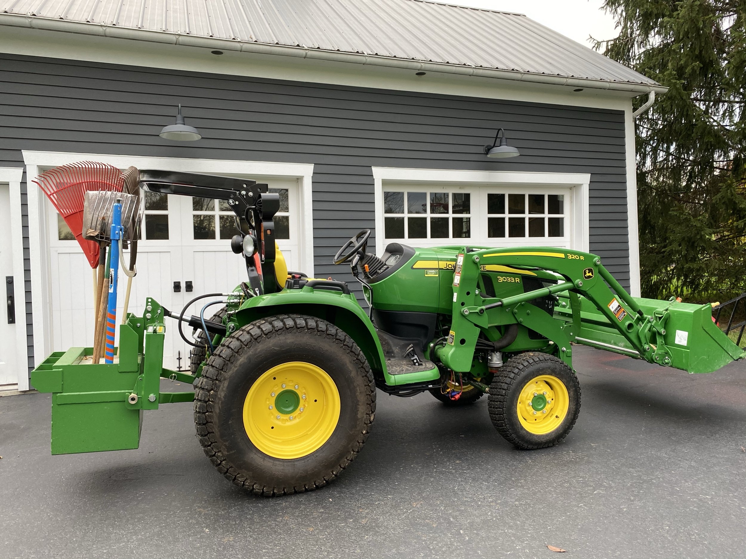

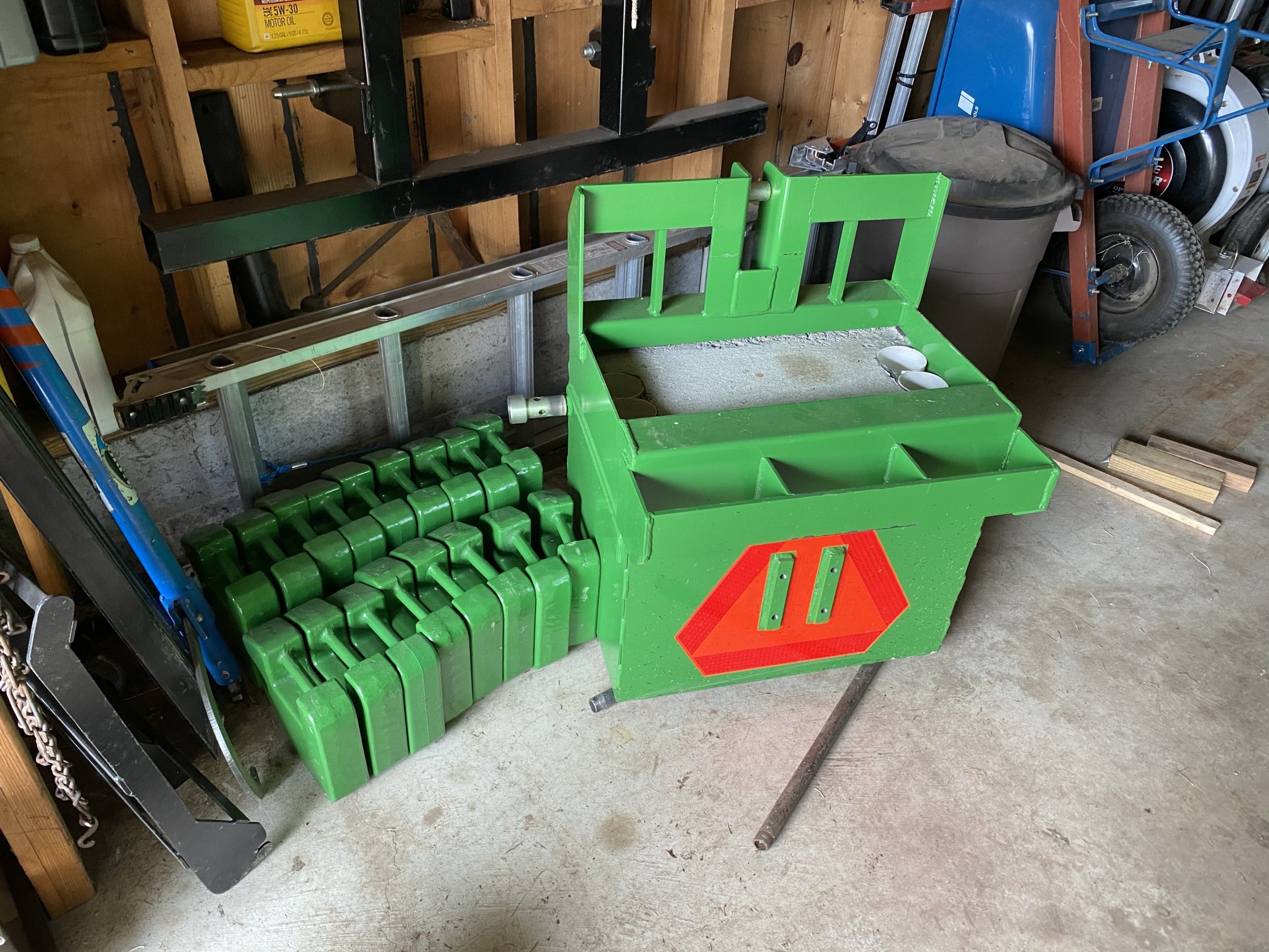

I actually made my own custom ballast box, starting with a stock John Deere box and welding what I wanted onto that. I sunk four 3" PVC tubes into the box before filling it with concrete, and they're the most handy rake and shovel holders I've ever known. In fact, I couldn't imagine using my machine for yard work, without that handy tool carrier. I also left the top dished, as that's where I carry all my log skidding chains, chainsaw, and even my thermos. I welded bars onto it for mounting 17 suitcase weights, either 42 lb. or 70 lb., and even welded a trailer hitch to the rear of the box. The hitch is a lifesaver, as it moves the hitch about 6 feet aft of my rear axle (bigger tractor than yours), giving me the steering drawbar throw capability I need for backing up 4-wheel wagons with steerable front axles.

If you have a welder, you can make your own box any size you want, even keep it super-short or invert it to sit up between the lower arms of the 3-point for zero added length. Just keep in mind that you want the weight low, and that placing it further aft of the rear axle makes the weight both more effective as loader counterbalance, and removes more weight from front axle by pivoting on rear axle fulcrum.
