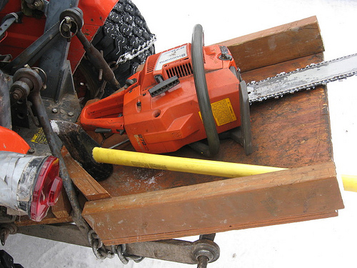

I cobbled this slip-on 3PH tool carrier in about 20 minutes.
Knees got tired of carrying tools in the bucket.
Loved it so much I jury rigged some line to the ROP that allowed it to accommodate long handled tools.
It's just slip on slip off...just adjust the 3ph down limiter wing nut so the tool carrier always angles up and it's good to go.
LESS...is more.
