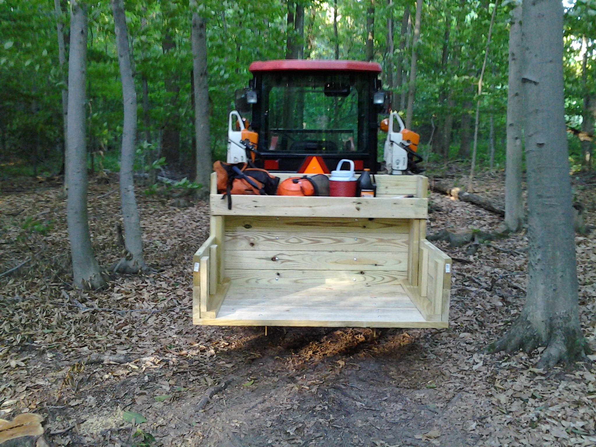

I welded up a 3-point forks assembly similar to TSC's. I can pick it up in a moment with the Quick Hitch.
I use the forks to carry several oversize pallets that have a sheet of plywood added. For the one I use mostly, I added a backboard on its front edge so I have something to tie cargo to. Another has high sides for a portable mulch bin, and a third has uprights along its back edge, for storing and then carrying a load of short tree props into the orchard.
Last week I lashed my table saw onto a basic pallet and took it out to the scrap lumber pile behind the barn to rip scrap lumber into tree props, with minimal handling. Pile > Saw > Trailer.
It is very handy to leave different projects on different pallets, and go pick them up with the rear forks when needed.

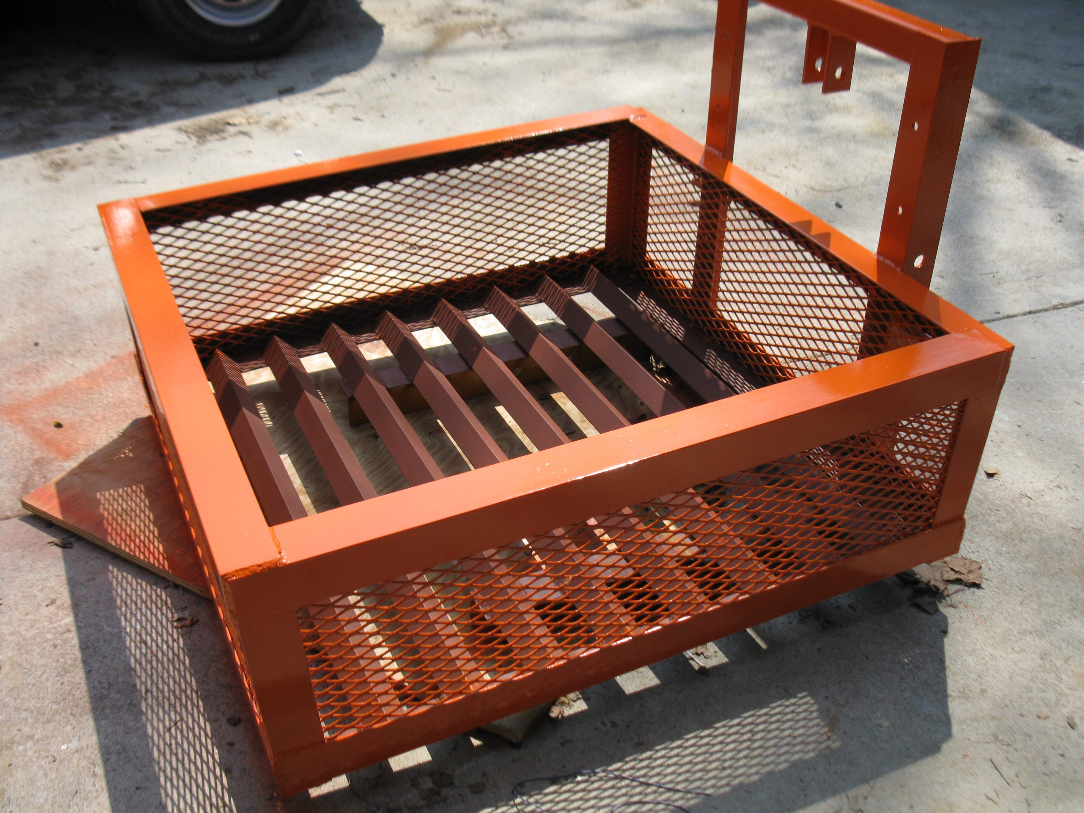

Crash.....
I have a MIG welder (which I am not too good with.....)
WHERE do you get the diamond plate for the floor and WHERE do you get the diamond mesh wire that you used for the sides?
Thanks
Hi,
Sorry for the long delay in getting to you with an answer.
Most good sized towns or cities have metal yards. Locally I'm pretty lucky as the yard has a good selection of used metal or drops (cut offs). Once a month or so I stop by to see what they have and pick up most anything that may be useful in the future. Never really sure what I am going to build or when. So its nice to have a supply on hand.
In the last few years I have built 4 wood stoves, mail box, roller, sheep's foot (compacter), pallet forks, wood racks, metal stairs and a bunch of little things.

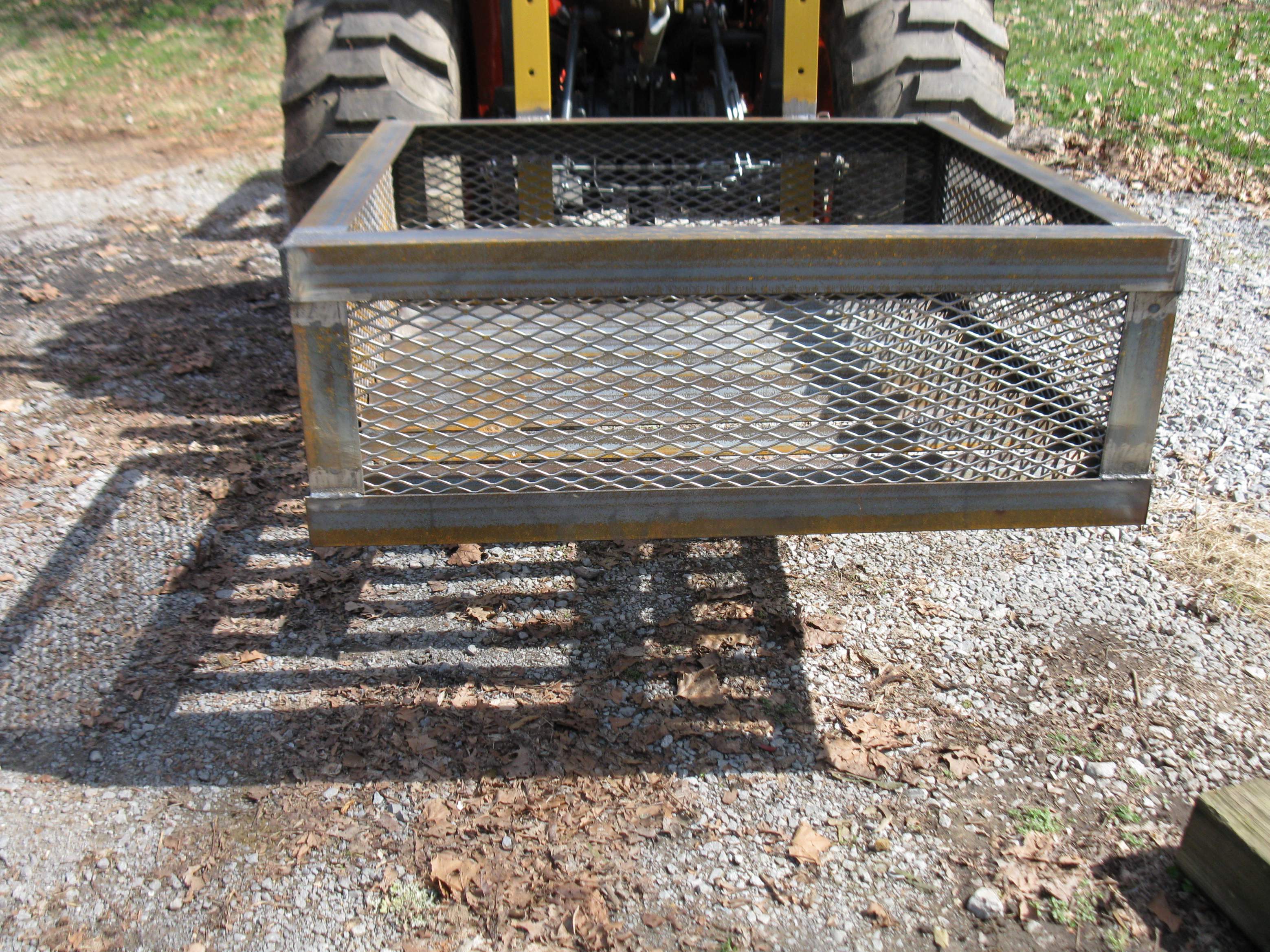

Here's mine. 3 inch angle, 3/16" thick. Inverted angle for the floor. I plan to add 1/4 to 1/2 steel plate in the bottom to add weight. The sides are 16" high. Started with a TSC frame and went from there.
