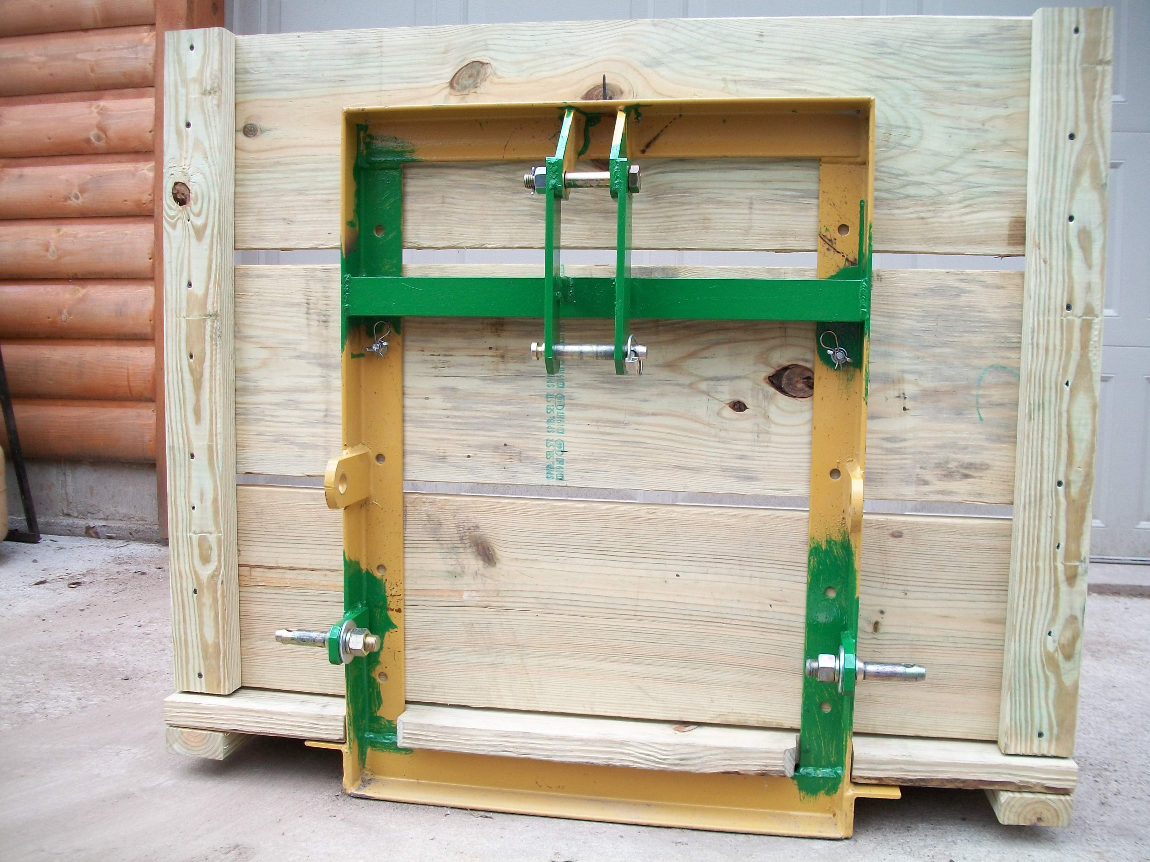

I bought the TSC one then bolt 5' 2x8 treated planks on then put 2"x2" angle iron over the cut ends to keep the lumber from warping. Works great. Right now I am using it for garden irrigation water supply, have 2 55 gallon barrels strapped on it to haul water and it handles those fine completley full, that's 880 lbs.
Build your wood rack out of light tubing may safe some weight.

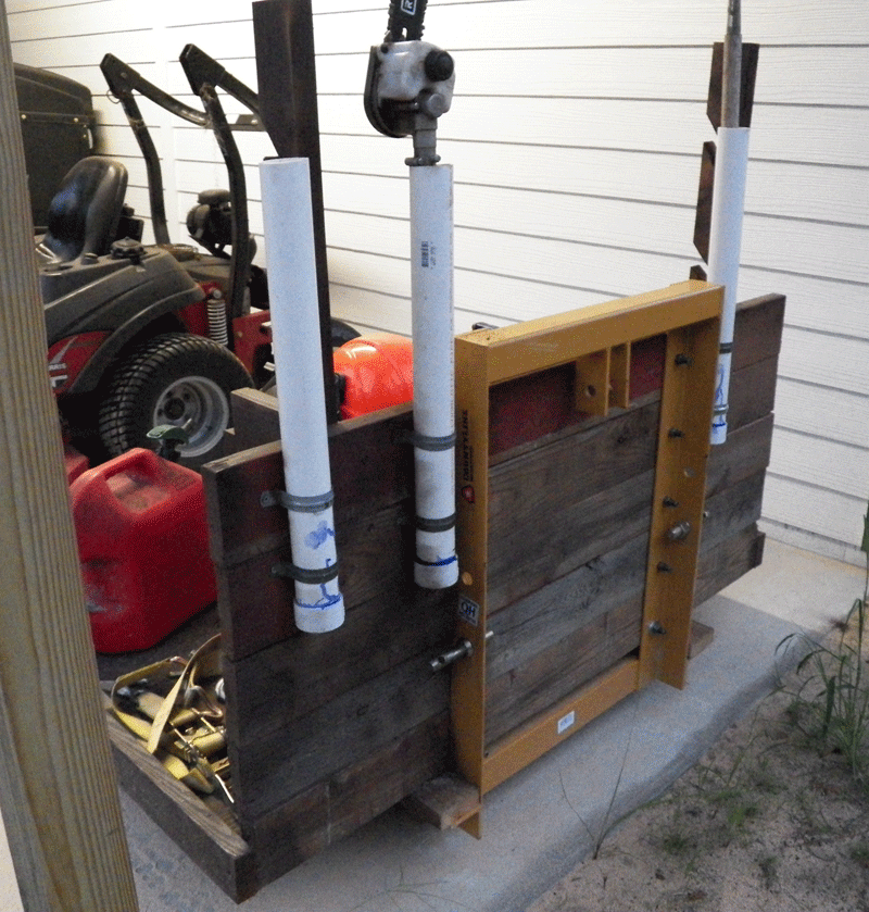

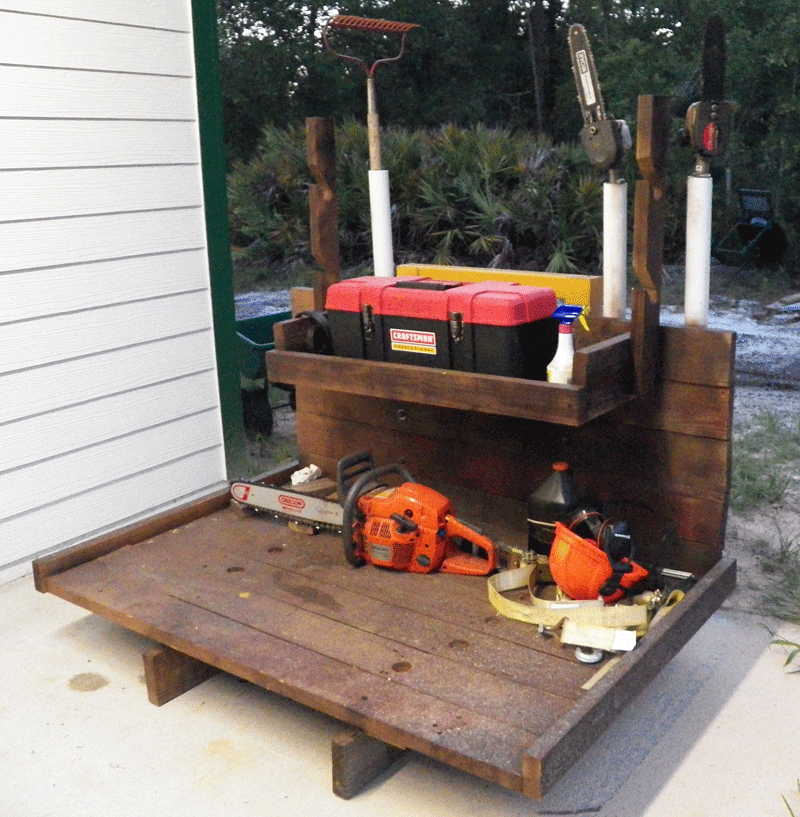

I made a carry-all using the TSC carry-all based on a video I saw at Wilson Ultimate carry-all at Wilson Outdoors Ultimate Carryall - Part 1 - YouTube .
The modifications I made were to add racks for my pole saw and weed-wacker, a tool box rack, and a water barrel rack (not shown) to place a filled plastic 55 gallon drum on it for a counterweight. I also put 2X6 skids on the bottom so the metal didn't dig into my concrete.

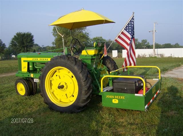

I made this one to use, then remodeled it for tractor cruises. Started out with a $5 one from a farm auction, homemade one similar to what TSC sells. Tore off the old planks, cleaned up the frame, made a new outer frame & used 1/2" CD plywood. The rails are made with 1" plastic conduit, more for hand rails than heavy use. ~~ grnspot

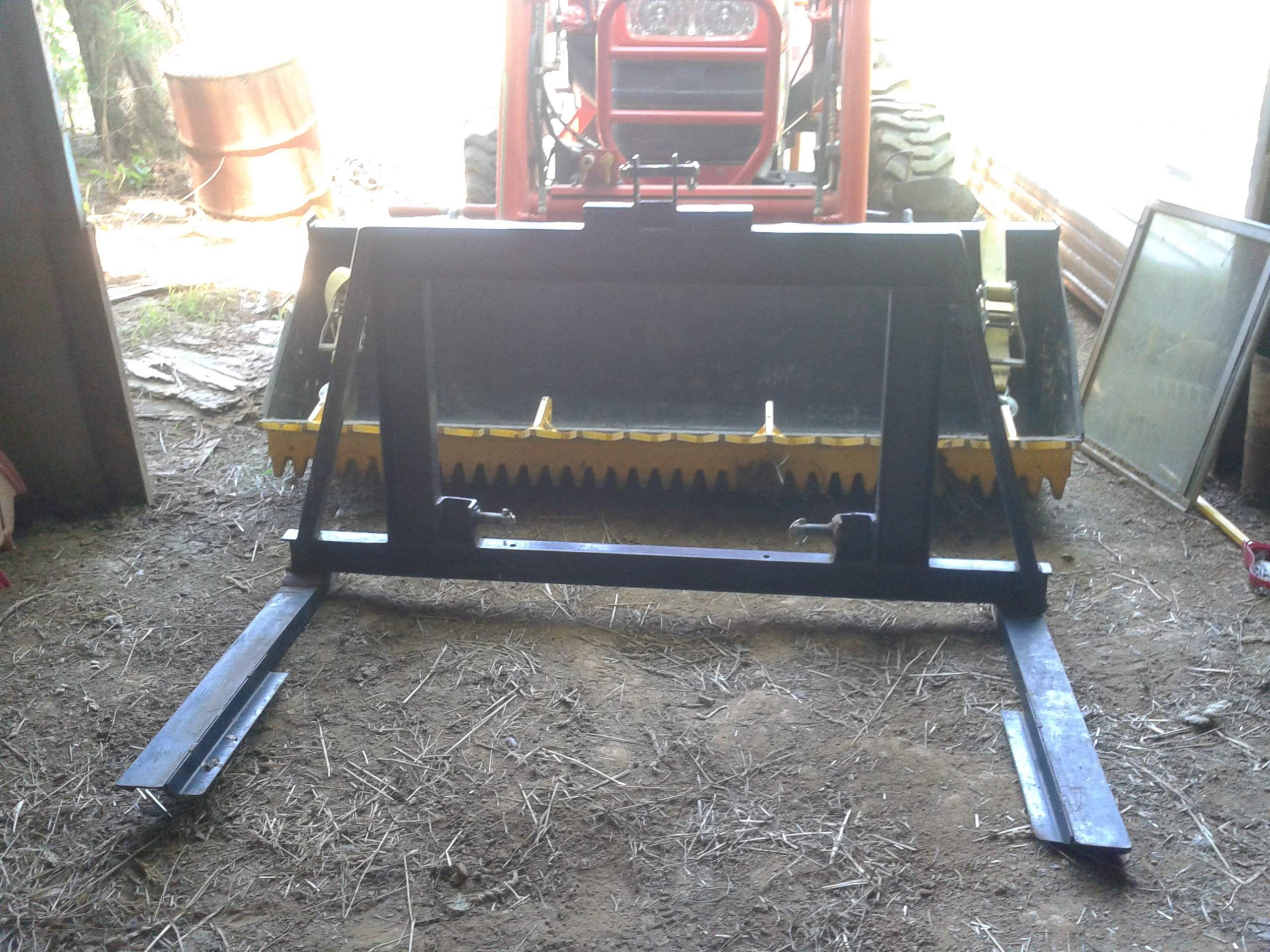

What about a set of pallet forks. You could stack would on the skid or get one of these. I have been stacking all of my wood on skids. It keeps it off the ground and you can move it with the tractor.

I made a carry-all using the TSC carry-all based on a video I saw...
Doug,
SWEEEEET! :thumbsup:
I really like that!
David
The modifications I made were to add racks for my pole saw and weed-wacker, a tool box rack, and a water barrel rack (not shown) to place a filled plastic 55 gallon drum on it for a counterweight. I also put 2X6 skids on the bottom so the metal didn't dig into my concrete.[/QUOT
I made a similar one. Yours has some nice features I would like to copy. I added two receivers welded to the frame for vises or towing.It's used mostly as a mobile work platform. Coupled with a small generator , a very handy thing.
