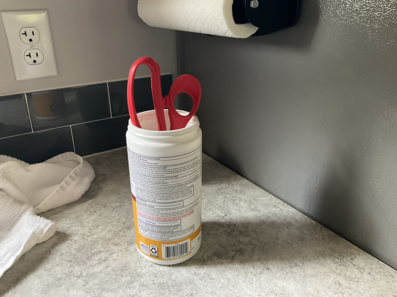

My solution took some trial and error to find the right vessel. Tip of loppers just touches the bottom and protects the paint while stretching a bit at the mouth for some grip. Example:
I did remove the label :giggle:

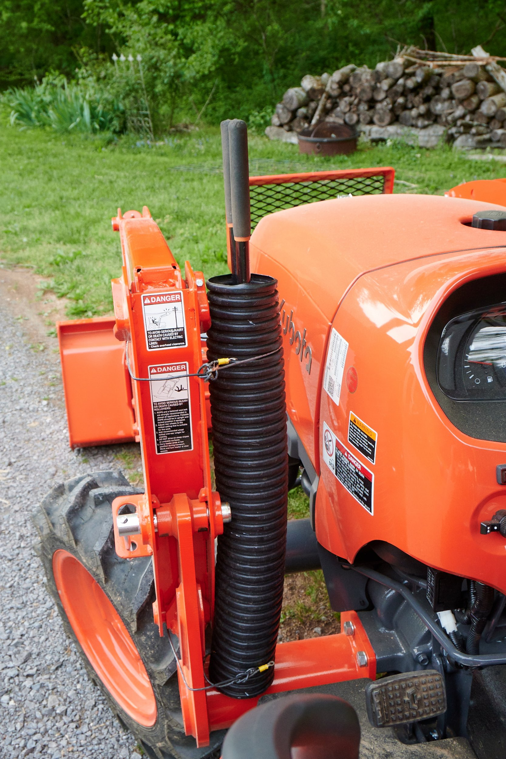

This is what I've done so far. Doesn't seem to rattle. It's pretty convenient to work with.

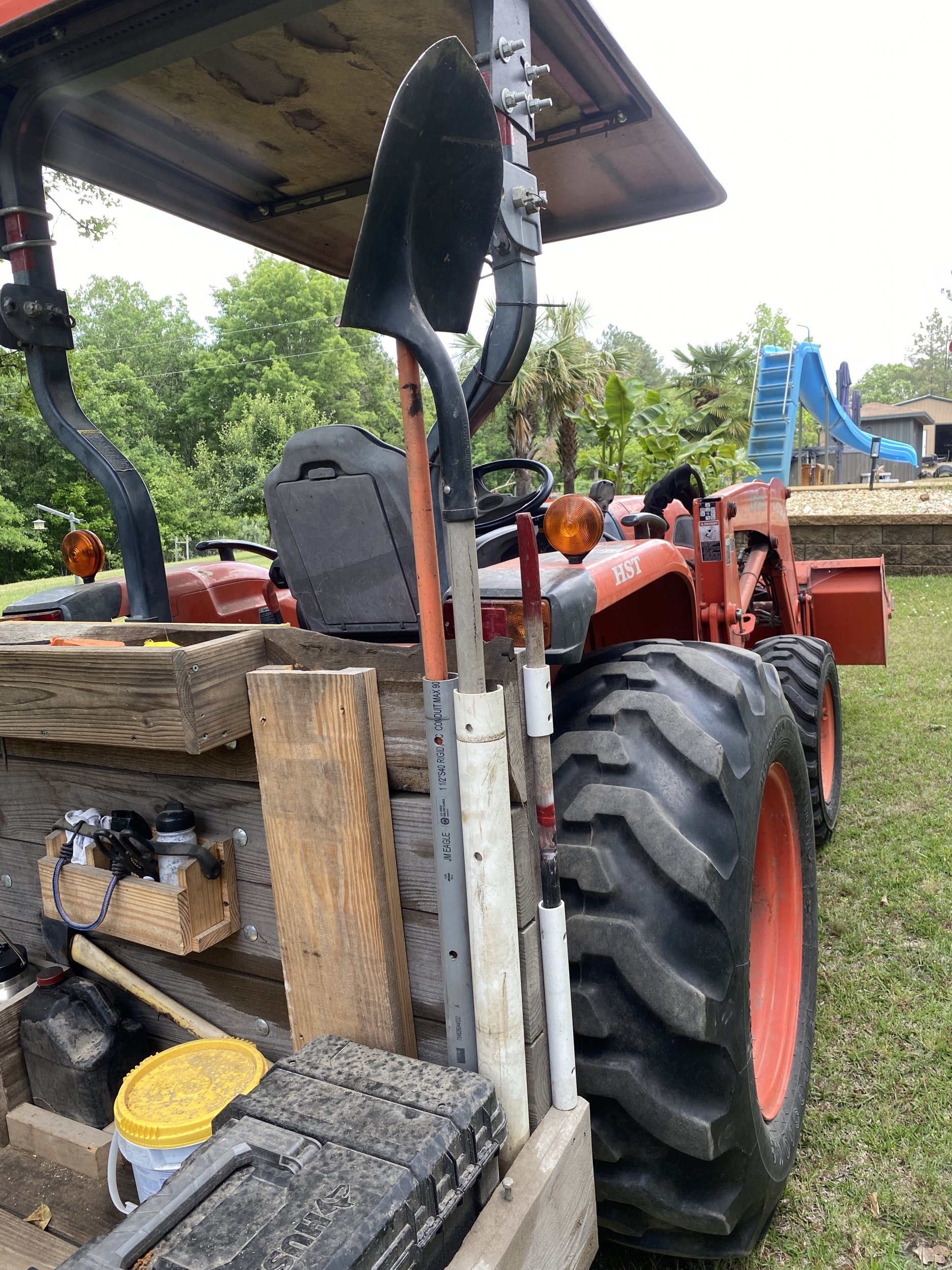

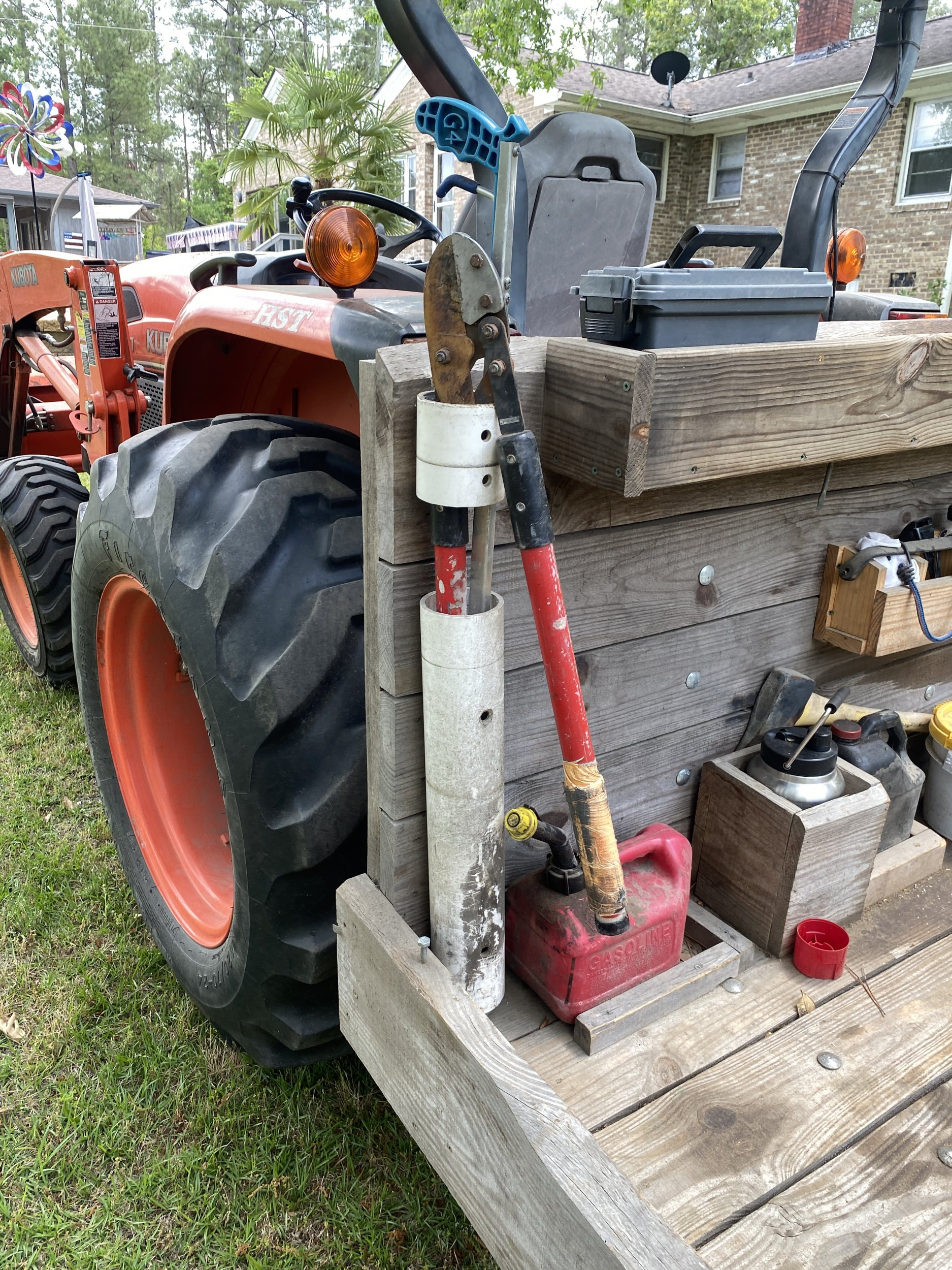

Yes, PVC is your friend. My carryall is almost always on my tractor and PVC helps me carry a lot of tools. I drill a larger hole on the outside to allow the screw head to go through and a smaller shaft size hole on the inside for the screw to go through and attach them where needed, no bottoms on them to allow drainage.
