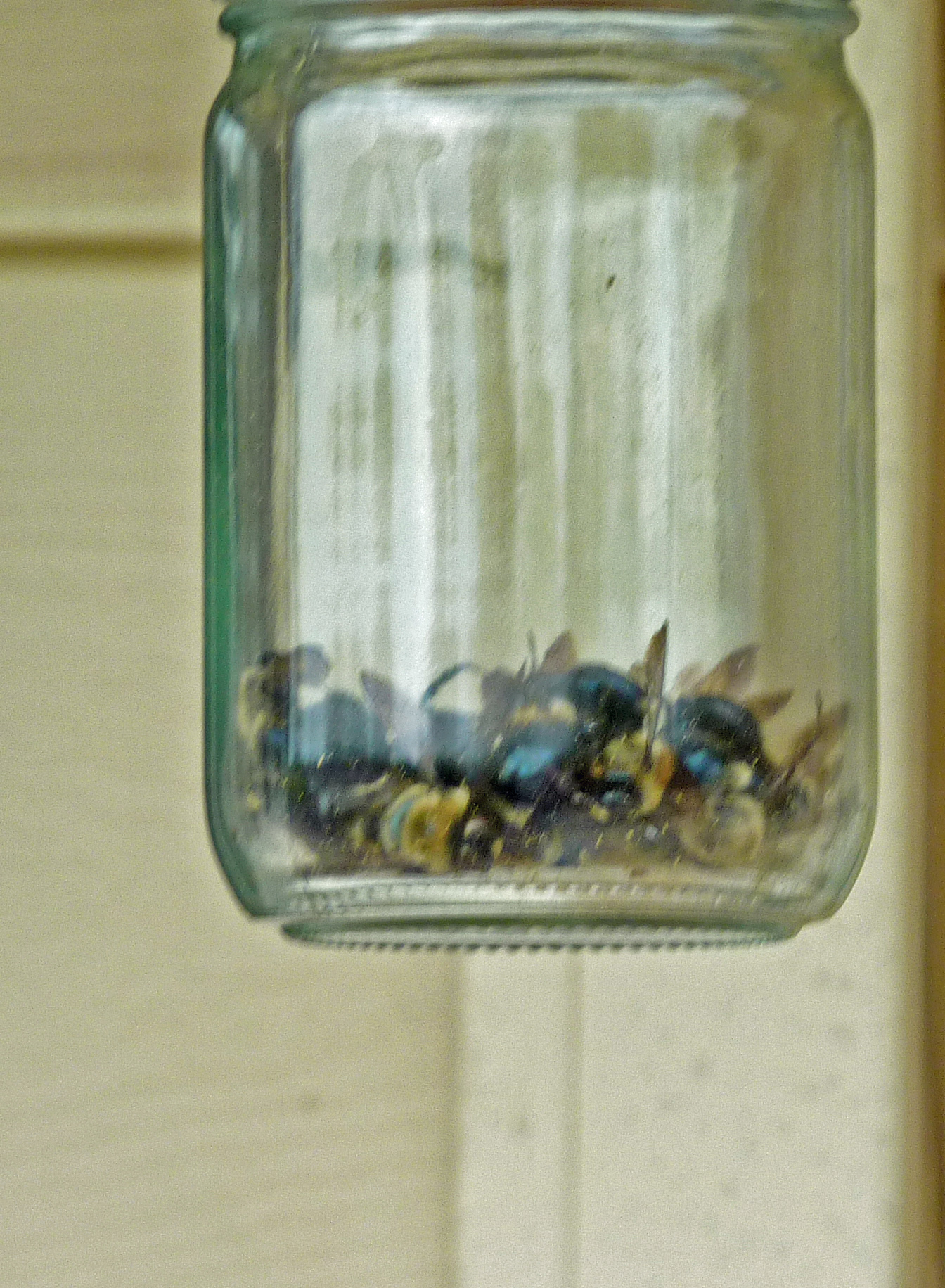

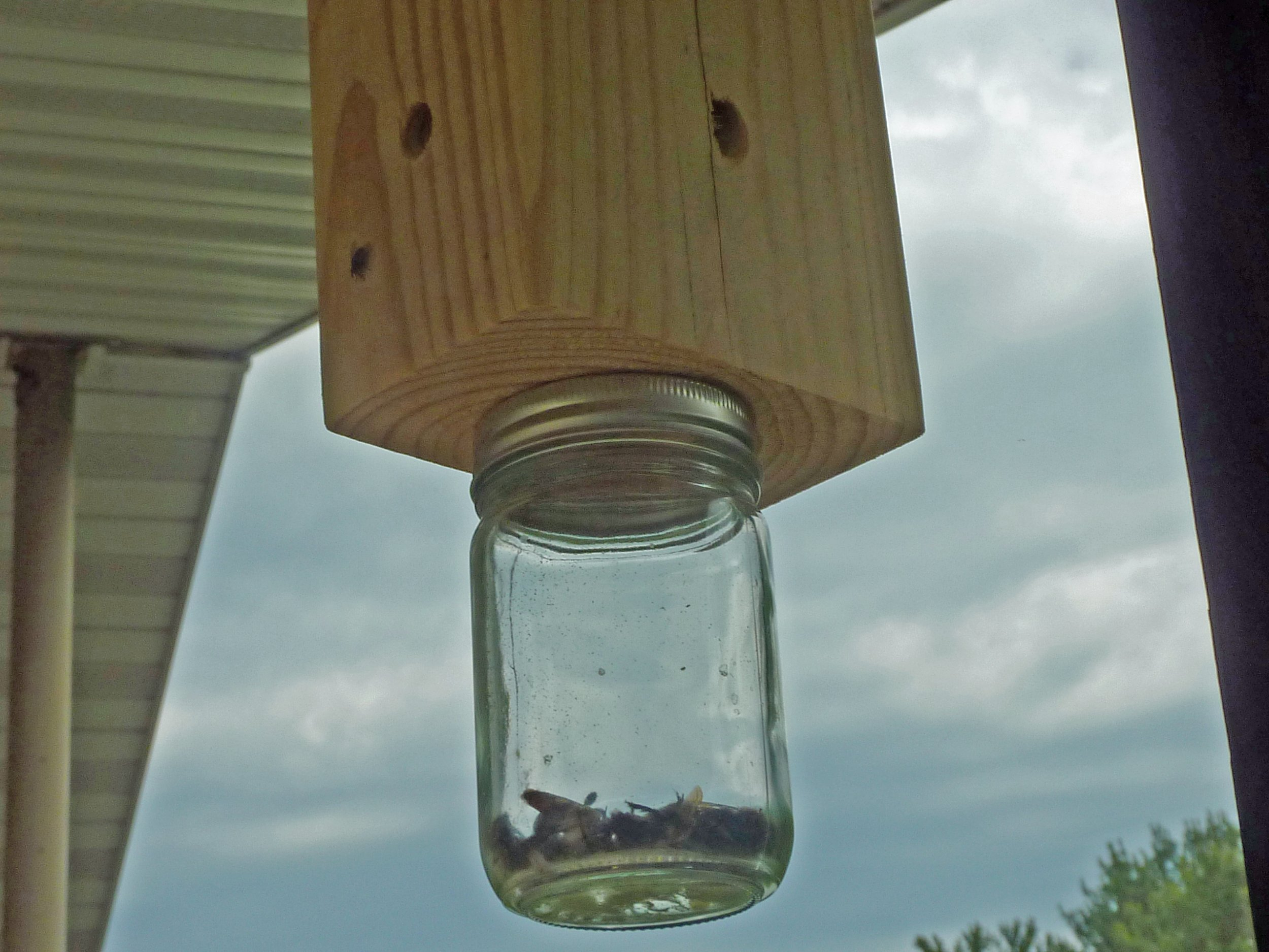

I live in a log home and I built 6 carpenter bee traps. A 4" block of 4x4 post with 4 3/8" holes going upward into the block. The 4 holes meet inside the block to a 1/2" hole going straight down. A mason jar is mounted on the bottom of the block. The bees climb into one of the 4 entrances on the side, and then down the main tunnel into the mason jar. They can't get out. Each trap will capture 30-40 bees in a few weeks. I empty them and keep capturing more bees.

I've made 12-15 of these and they will catch hundreds of the little buggers. I don't want to just 'empty' it as some are going to still be alive in there. I'll wait until season is over and/or take the jar down to the lake and drown them.....then turn them into potential fish-bait! (I have no idea if the fish would eat them or not.....I leave that decision up to them!)
It amazes me when the traps are up that some of them are prolific at catching the buggers.....others not so much. Not sure if it has to do with sunshine, lack of, star alignment or pot luck. Those that are prolific in catching them, I might add a second one next to it. I've got them on all four sides of the house with the most of them on the front deck area.
The light that hits the jar may be the reason some traps work, and some don't.
I have read that the bees are looking for light when looking for an exit,,
so, some have said to add a crumpled piece of aluminum foil in the clear jar.
The foil will reflect light, attracting the bees to "that" exit.
It is cheap enough to try, and probably nothing negative about adding the aluminum.

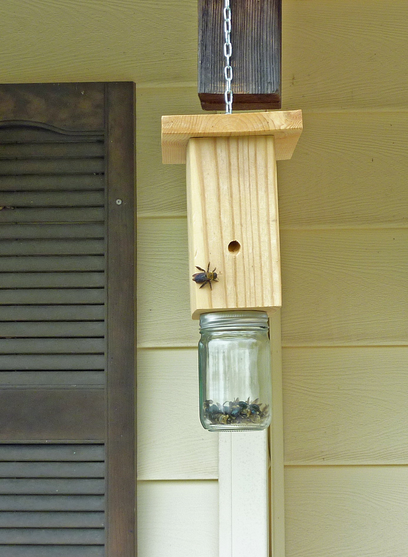

My understanding is the entrance hole has to be drilled on an upward angle AND closer to the top verses bottom of housing. There is a hole in the bottom for them to enter the jar.
When they get inside, they fly around... can't find their way out (since there isn't a direct view out the entrance hole because of it being angled) BUT, they see the light in the bottom.....so go there to escape, only to find themselves joining up with the rest of their ilk.
If someone tries one of these and it's not working then I'd review how it's constructed (is the hole about 1/2"? Is the hole angled upwards? Is the hole on the upper section of the box?)
