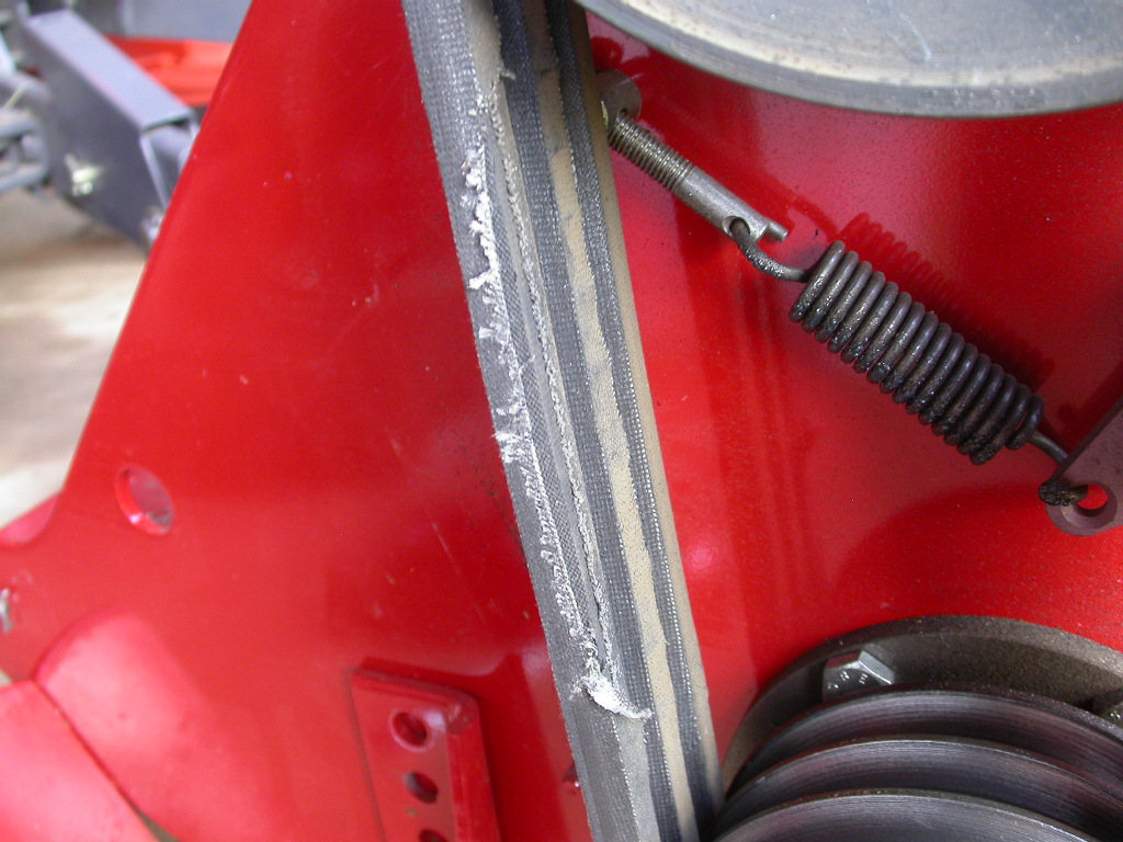

I thought I'd weigh in with my experience. I have only about 5 hours on my Caroni and did the heat test with my hands. After mowing short grass for about 30 minutes, I could keep my hand on the metal cover for about 5 seconds before I had to pull it away, so hotter than I would have hoped. It was a cloudy day, so the sun didn't contribute to the heat.
I removed the cover and took a picture of the belts. As you can see, the cloth has worn off one part of the belt already and it is down to the rubber part in that area. I'm assuming that is bad thing, but would like to get feeback from the experts on whether this is normal after 5 hours or not.
I've not ever adjusted the spring, but the tension actually seemed rather tight, although I'm not really sure how to judge the tension. I've read the thread about using a 3/8" deflection, but I'm not convinced I can judge that too well.
I know Matt at Agri-Supply monitors this discussion board so maybe he can weigh in. I'll probably contact him in any case to see if there is something I need to do differently or whether the belt wear I'm seeing is normal. I'm not in favor of replacing the spring with some other sort of mechanism because of my lack of experience and the fact that it would probably void my warranty, at least in regards to the belts.

After reading this though I would have to say that it appears to be (D) all the above.
The cause of heat is what needs to be solved, most likely it is an issue with the tensioner, however this should be easy to test. If the Kevlar belts do not have the same ill (shreading) effect, is there still heat? If so then the tensioner is most likely the problem. If the problem of heat is no longer seen with the Kevlar belts, then the belts being used are most likely the issue.
I am still leaning toward the tensioner as not everyone has the issue, and the tensioner is adjustable. I am betting on two items that are the cause. First there is probably an exact tension (sweet spot) that needs to be held by the tensioner, does anyone know what it is? Another is the trip one of these must make to get to the states, I am betting that even if it were adjusted at the factory, it may need to be checked on arrival.
I really hope this get's solved, as this will probably be my next purchase... :D
   / Caroni Flail Belt Failure #90
Now this is only my opinion , i believe that spring would be quite adequate to keep one belt at the correct tension . If it were able to say , apply 60lbs of tension on the belt , but we have three belts . That's 20lbs each , not nearly enough . I would like to see the results of someone putting a spring scale on the idler at it's center and find the exact tension that it actualy has . The belts on Foozle's mower are going to fail , and they will fail big as when one comes off it tangles with the others .
