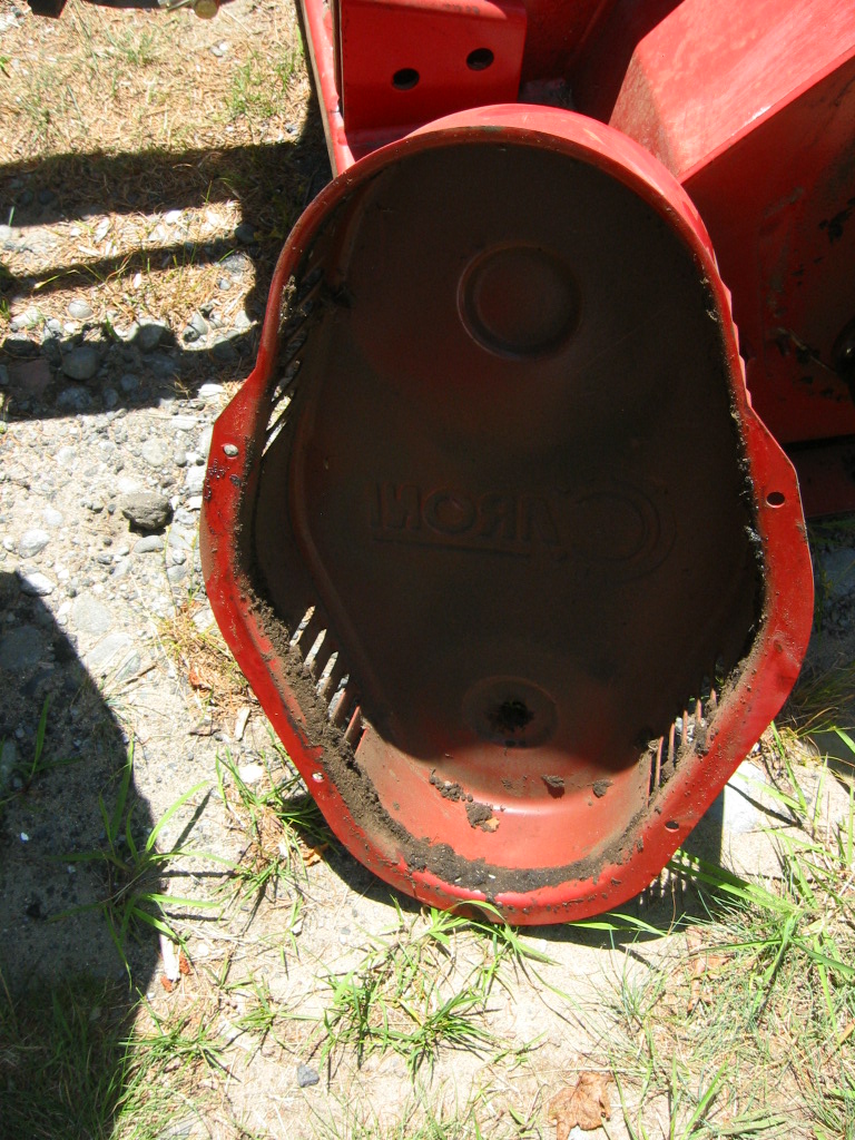

I have stalled the tractor occasionally while mowing with the flail. I don't believe I've ever heard belt squeal. However, there was quite a lot of what I think may be belt debris (fine fluffy stuff that did not appear to be vegetal in origin) at the bottom of the belt cover when I took it off this weekend. That was only about 5 mowing hours since I last took the cover off. Just for reference what I mean by quite a lot is enough to half fill a spray paint can cap...it is light and fluffy so it weighs next to nothing. Again, I did not do any careful inspection but it seemed suspicious to me that it was almost all grey brown in color and that I'd only been mowing green grass the day before. See photos. I'd love it if someone told me it was just fine mowing crap and not belt related.
I think I will first try to max out the existing spring adjustment. Then I will try a solid replacement for the spring but will be careful not to over tension it. I did get a infrared thermometer (thanks Amazon) so I should be able to tell if there are any changes in belt cover temperature. I just read IronHorse's new suggestion regarding strength of the spring replacement. I'd already picked up some 1/8 inch smooth steel rod that I intend to cut and bend some v hooks onto the ends to serve as a spring replacment. I may or may not get around to doing the switch this weekend but will report back. I could not find a more powerful spring in appropriate size at HD and don't know if I'll have time to track one down before the weekend but that is the other route to consider.
