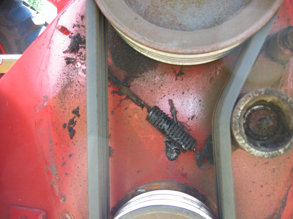

Well until now i did'nt realise how puny that spring is . Theres no way that spring can keep the belts as tight as they need to be . If you can't keep your hand on a cover that is nowhere near the belts and has a supersonic air stream inside it to keep it cool , how hot are the belts getting ?:eek: After all the belts are made of rubber , and probably Chinese rubber too boot . I would strongly suggest making a solid threaded link , turn buckle or chain so that they can be adjusted correctly . It would be no different that the way you adjust the fan belts on an engine or any other thing with belts for that matter . I can see in my mind when that rotor strarts to load up and the torque of the tractor is kicking in , that idler would be moving away from the belts . If you want to test this , block the rotor with a piece of wood and put a big shifter on the gearbox spline and apply some torque , i'll bet the belts push the idler away without a lot of effort .

The idler is on the slack side. I agree the spring is much too weak tho. The belts should be strung tight to carry that much power.

I understand your point. I wonder however what the effect of using a solid link rather than a larger spring would be with regard to shock loading when the mower hits something. I presume that the spring loaded idle provides a measure of "slip clutch" effect and that it might be preferable to get the right size spring rather than a solid link. In your example of solid links in automotive serpentine belt systems, there is no need to allow for a shock load. On the other hand maybe the proverbial 3/8 inch deflection slack is adequate to allow emergency slippage on the flail. Does your flail have a spring loaded tensioning pully?

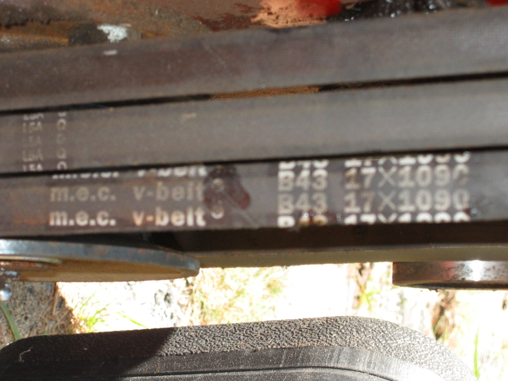

I checked and measured the tensioning spring. It is a simple 1/8 inch (0.15 inches by micrometer) by 3 inches extension spring with standard machine hooks. I forgot to measure the diameter but it is about an inch. It should not be too hard to find a heavier duty replacement but I haven't tried yet.
I also tightened mine up by another inch and a half. I'll do some mowing and see what the effect is on belt guard temperature.
Also, the belt size appears to be a B43 17x1090 (I presume millimeters).
(Note: 1 hour of medium/heavy mowing left the belt cover too hot to touch for more than a couple of seconds even after taking up most of the adjustment on the spring.....Will look for a heavier spring first and also, per IronHorse's suggestion, a chain to replace the spring.)
