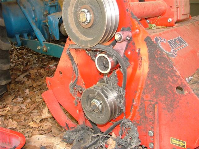

My belts failed. I have 10-15 hours on the flail. Both the power and rotor shaft turn freely by hand. There was no noise or smell of burning rubber. After a few hours of first using the Caroni, I checked the belt tension and they were a bit slack. I tightened them up a wee bit. As there is a spring loaded tensioner it would be difficult to over tighten them.
I'll call Agri-Supply in the morning to see if they are covered under warranty. I was not able to find the belt number at Agri but the Caroni number is #2142. I think I need to find a US automotive belt that will work in place of the Caroni belt.

Guy's, I looked real close at the unit and I can't find what caused of the failure.????

I guess you've already thought about a stick getting caught in the belt, and checked the belt guard for gaps and such. Do you think it's possible that a little oil got to the belt? I've seen that destroy them pretty quick.
Bob, sticks caught may be the reason but I never felt or heard any jams. I did pull the unit up and the rotor area was clean. There was no wood debris under the belt cover.
I also thought of oil. I put 2 shots of grease on all the zerks before each mowing and I was going to remove the belt housing soon to check for signs of over greasing. As you can see in the photo, a lot of the belt turned to powder. I looked for any sign of oil/grease and all was normal dry.
When I put on the new belts, I'll check the operation before I reinstall the cover.

This is the first report on TBN of belt failure with a Caroni. I am sure it is not an unheard of problem but when such a failure occurs after only 10-15 hours of use and involves all three belts, it seems to me there must have been something wrong with the set up or tensioning of the belts. The belt dust on the outside the belt housing cover (I think that is what it is) indicates the belts must have been disintegrating for a while before failing.
I had my belt cover off for maintenance (greasing) just a few weeks ago and after about 20-30 hours use the belts looked essentially new so there clearly was some sort of malfuction in your case and this is not just a premature wear issue.
Unfortunately because AgriSupply is really a mass marketer rather than an individual dealer, they don't have any real experience in maintenance of these mowers. The only dealer on TBN who has indicated he carried the line in the past and is experienced in maintenance is DavesTractor, a Mahindra dealer from CA. If I were in your position (and for the benefit of all of us), I'd PM Dave and see what he thinks.

IT, I agree with all your points. It was way too early for normal belt failure.
I would like to ask all the Caroni flail users to check for heat on the belt cover and post the users findings. I mentioned mine was hot to the touch right from the get go. I have a temp probe I'll use when I get back up and running.

I had thot that the Caroni flail drum turned the same direction as the tractor tires. Is yours a counterrotating flail? The positioning of the tensioner on the rearward side of the belts seems to indicate so.:confused:
