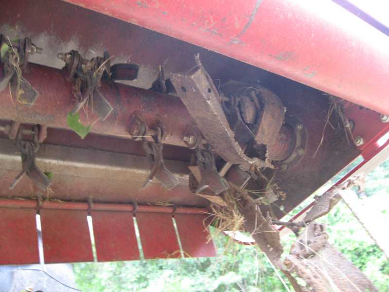

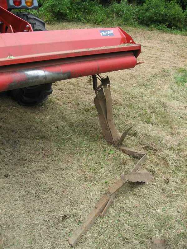

I had thot that the Caroni flail drum turned the same direction as the tractor tires. Is yours a counterrotating flail? The positioning of the tensioner on the rearward side of the belts seems to indicate so.:confused:
larry
I have not specifically checked but I think it may be counterrotating. If you look at the two pictures below you'll see that an old rusy angle iron was pulled out of the ground and wrapped around the mower. It looks to me like it must have been counterrotating in order to wrap in this direction.
Just in case you are wondering, there was no damage to the mower and I just needed to unwrap the angle iron to get mowing again.

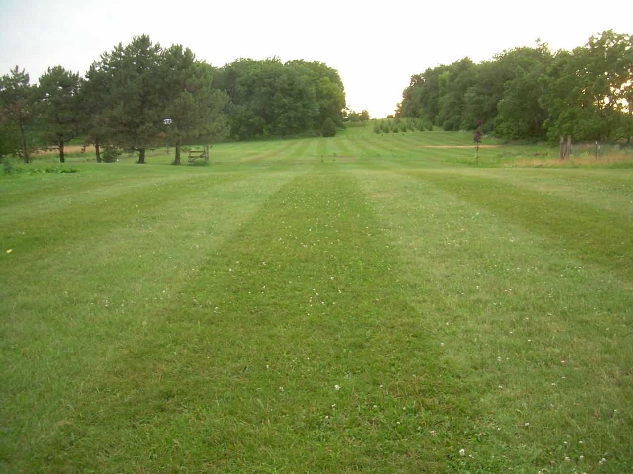

Also, as mentioned before, I'm getting this groove pattern in the grass when finish mowing.
If you mow straight back/forth, the grooving looks great, IMO. :) Bit if you really want to clean things up, nothing is going to match a rotary finish mower.
