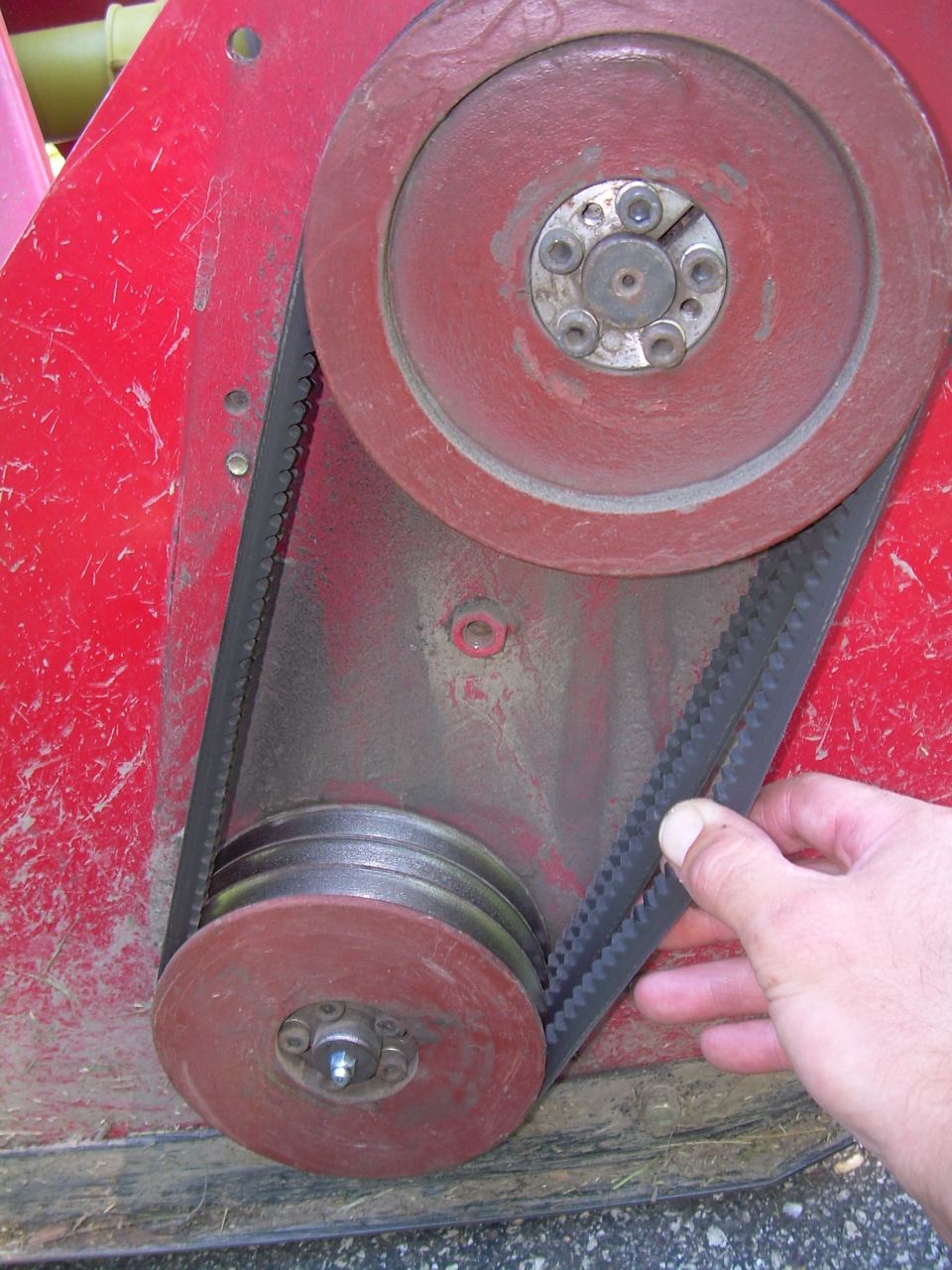

Curious about this;
How much "slack" do your belts have ?
Not really "slack", but how much can you deflect the longest run of belt with a reasonable amount of hand pressure ?

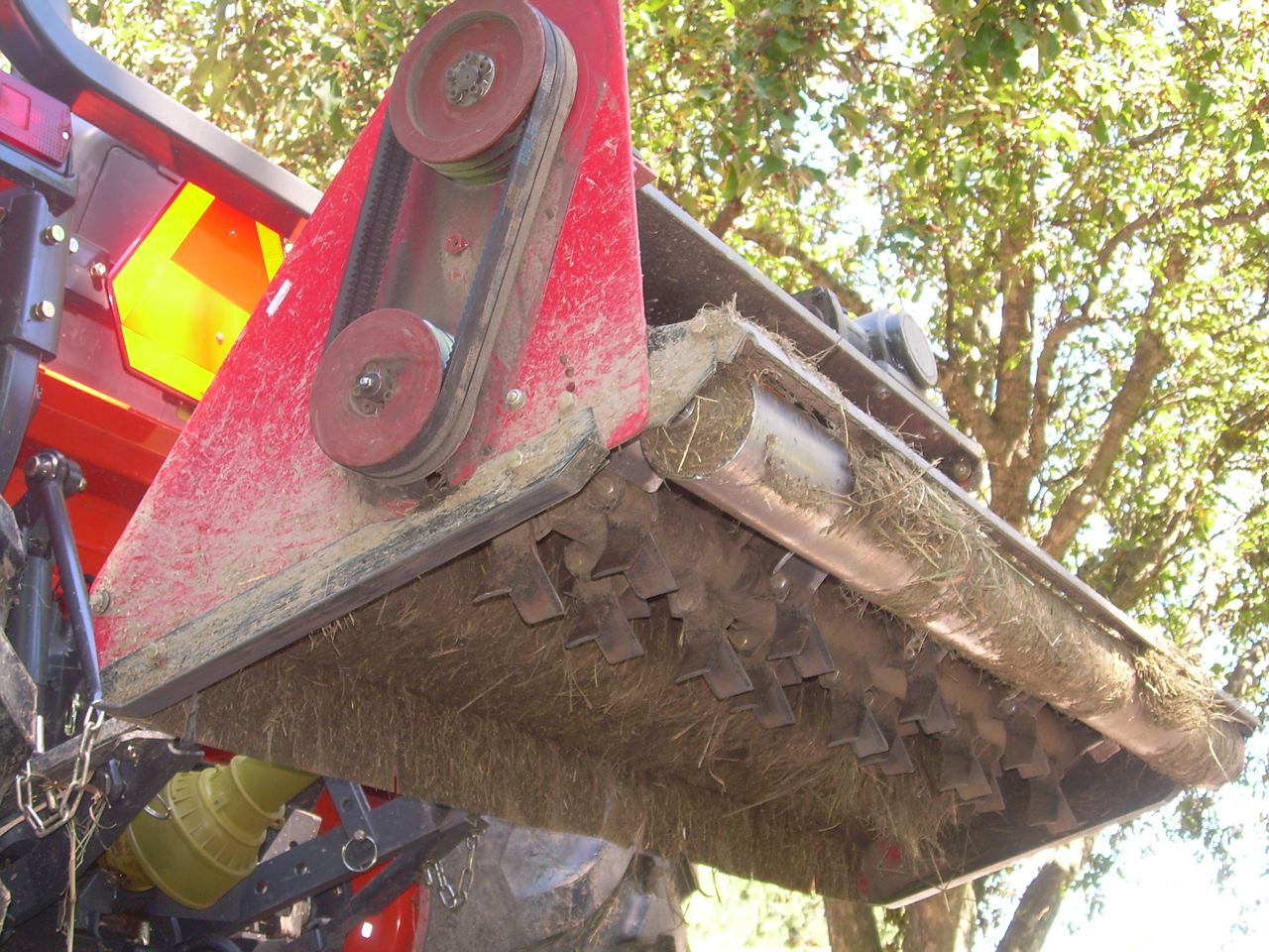

A couple of pics of my Hanmey, one of the belt tension and a good ol' dirty one after mowing 5' tall swamp grass; the belt cover was still comfortable to the touch.
   / Caroni Flail Belt Failure #123
davitk said:
A couple of pics of my Hanmey, one of the belt tension .
That is about all I get with the Caroni but I have to put more force on it to deflect the belt that much.
