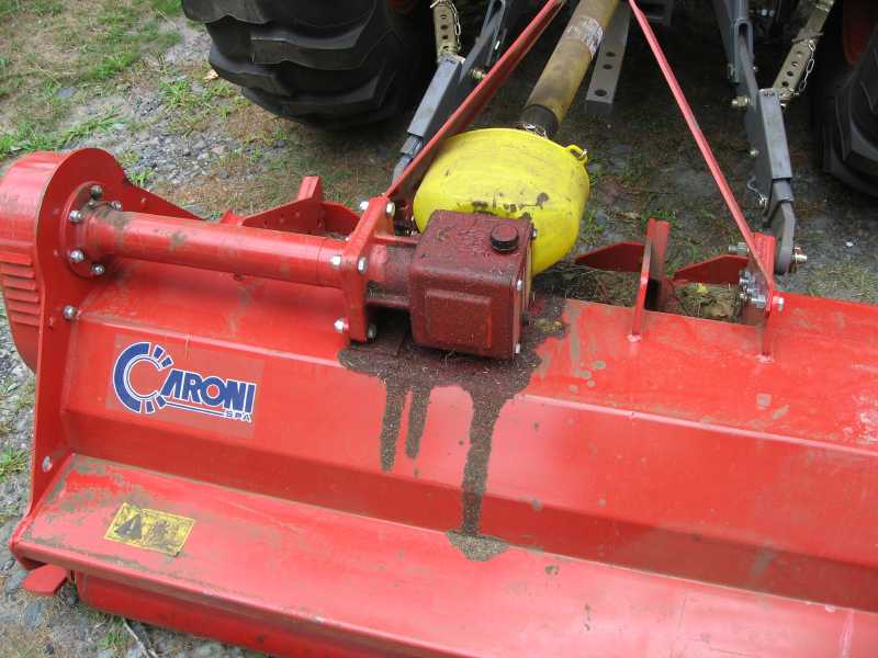

   / Caroni Flail Belt Failure #119
Cyberroc said:
Is there a grease zerk on the top larger pully set? Maybe on the other side of the plate gard or somewhere not easily visable?.
Yes, it is on the shaft side. You can see it on this photo if you squint.:)
   / Caroni Flail Belt Failure #120
LOL
Good to know, it was just a thought, I am guessing that it does the job.
